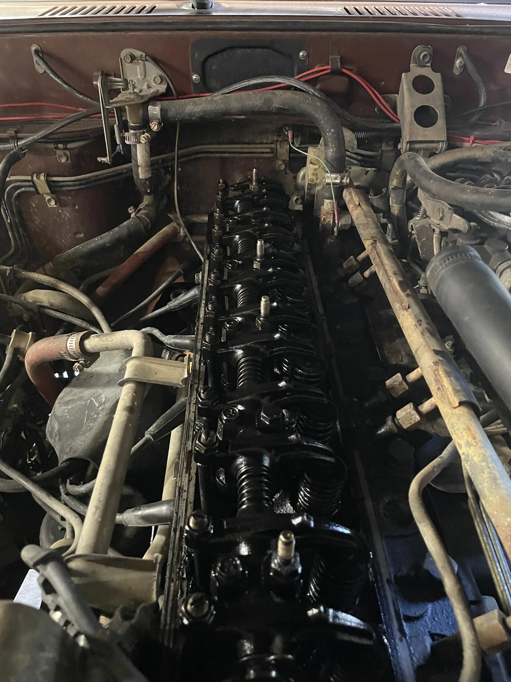

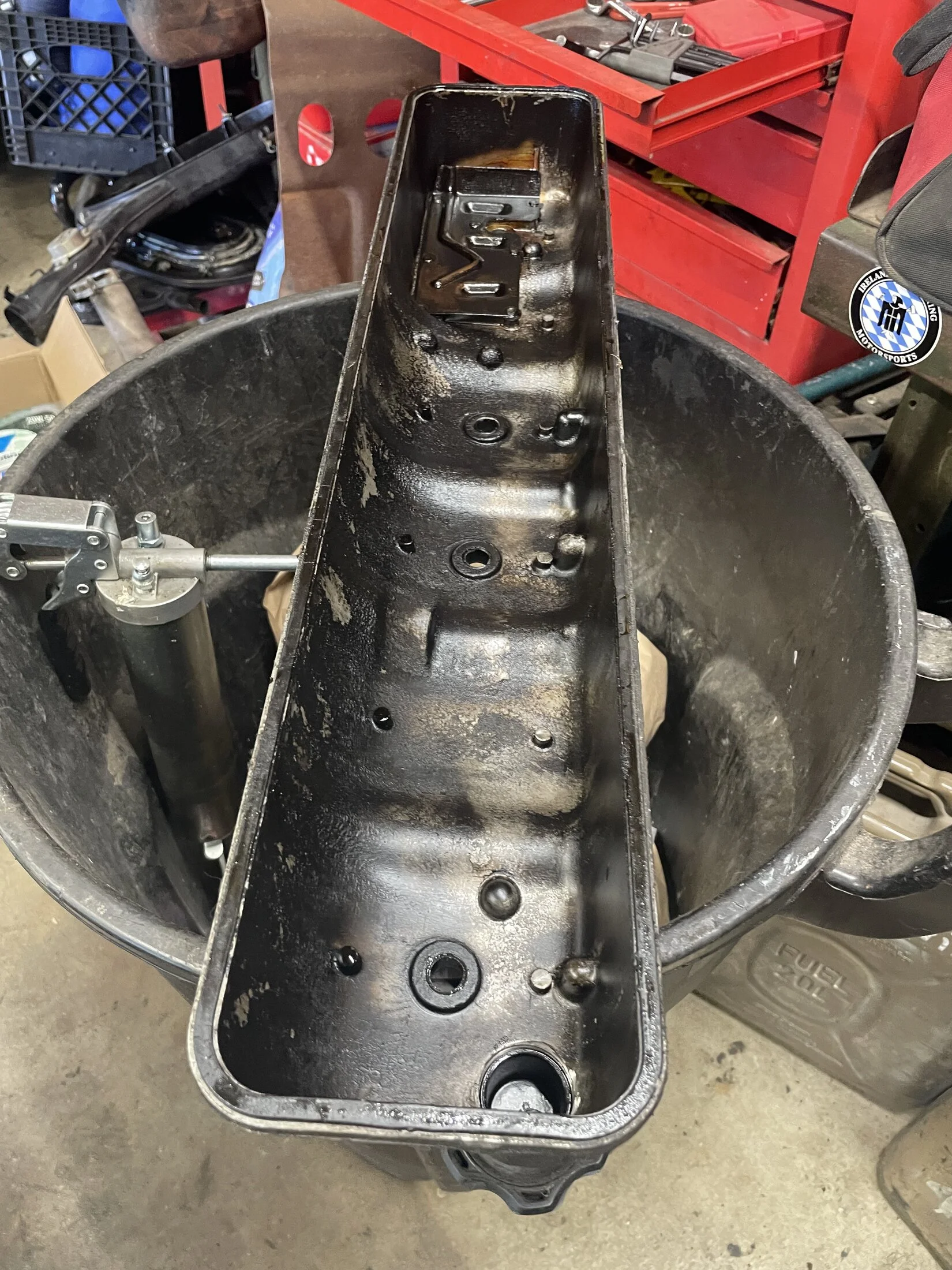

Got a late start and only had about 90 min to work. Valve cover gasket pulled, valves adjusted. Looks pretty good under there, no sludge at all. Appeared like the valves were maybe adjusted once before, gasket cracked into pieces as I pulled it. Power steering pulley wobbles even under tension, yikes.
Underneath. No scraping necessary.

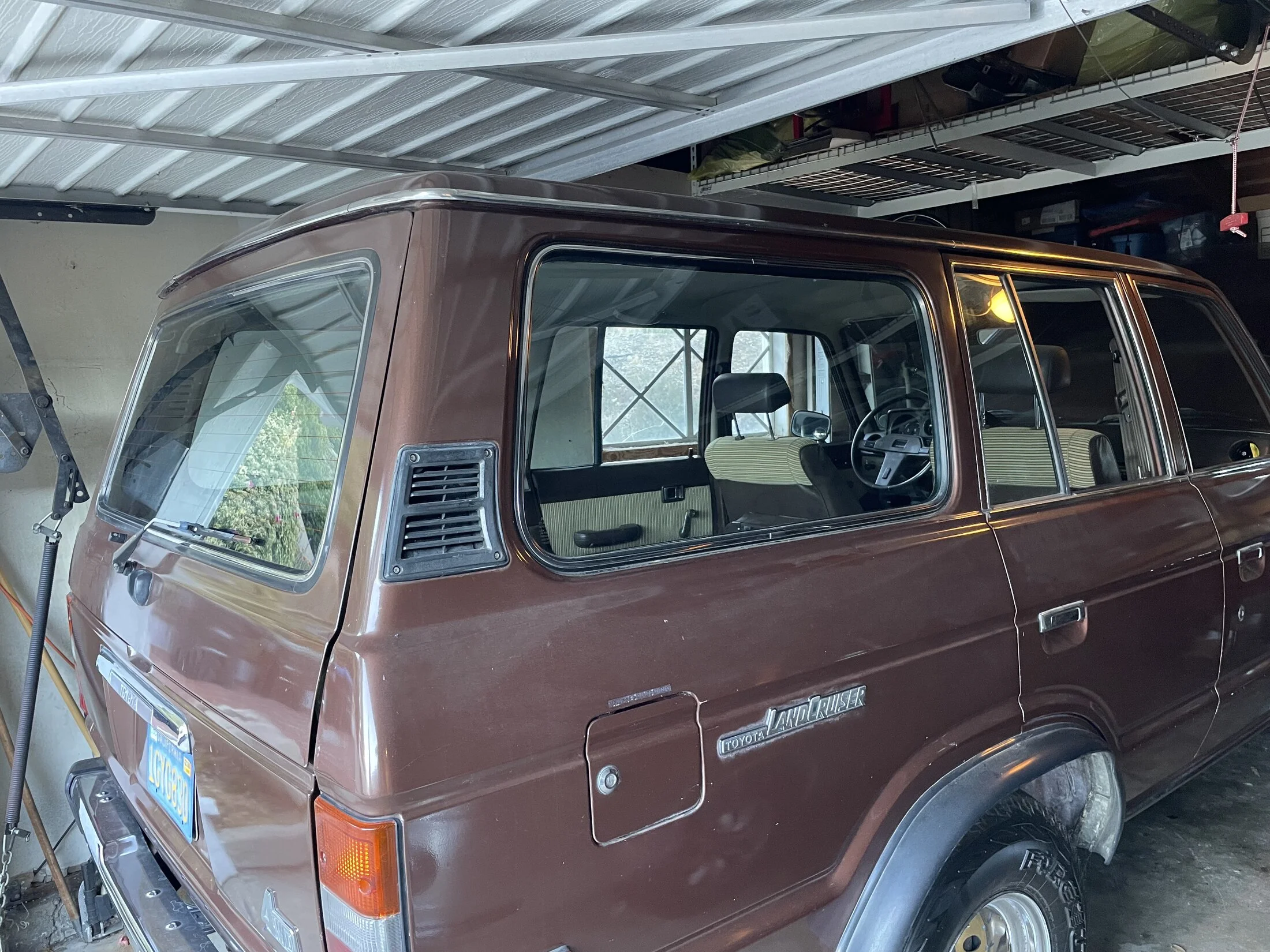

Started scraping the tint off with a hair dryer and a razor blade, works for the most part but not the fastest process. Finding that the less bubbled and cracked the better, as it tends to come off in one big sheet rather than a bunch of tiny flakes. Unfortunately it's mostly bubbled and cracked, especially the rear window with the defroster. That's going to be fun, planning to get some plastic razor blades for that. Hitting the cleared window with 3M adhesive remover to take off the old glue. Looking better already.

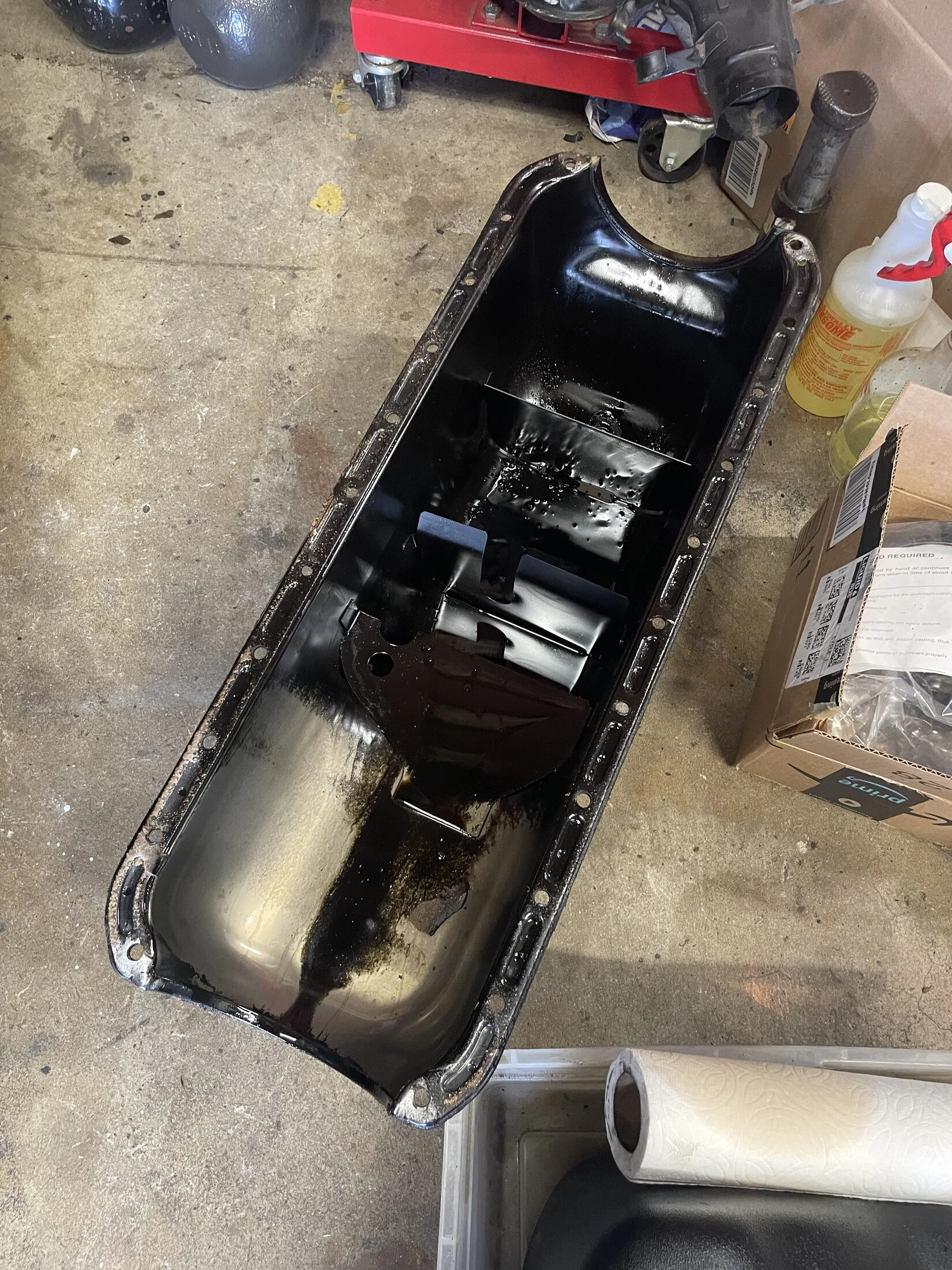

Oil pan gasket. Worst. Job. Ever.
Pan itself is in decent shape, but the gasket was completely ossified and frozen solid to the block. Took me a day to get it to pop off, repairing a small dent in the pan that I made with the bottle jack and a 2x4, and then spent most of today scraping and cleaning and reinstalling. Every time I do this, I swear up and down it's the last time, and it's just not. Hoping this is the problem. Subsequent pulling of the pan will be much easier, however.

Parts are here, tint is scraped and windows looking way better. This took hours with a razor blade and a hair dryer but think it was worth it. Plan is to get it ready for smog by the weekend.

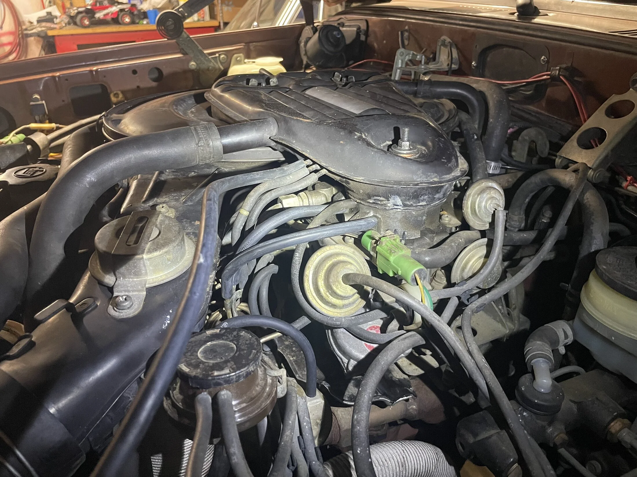

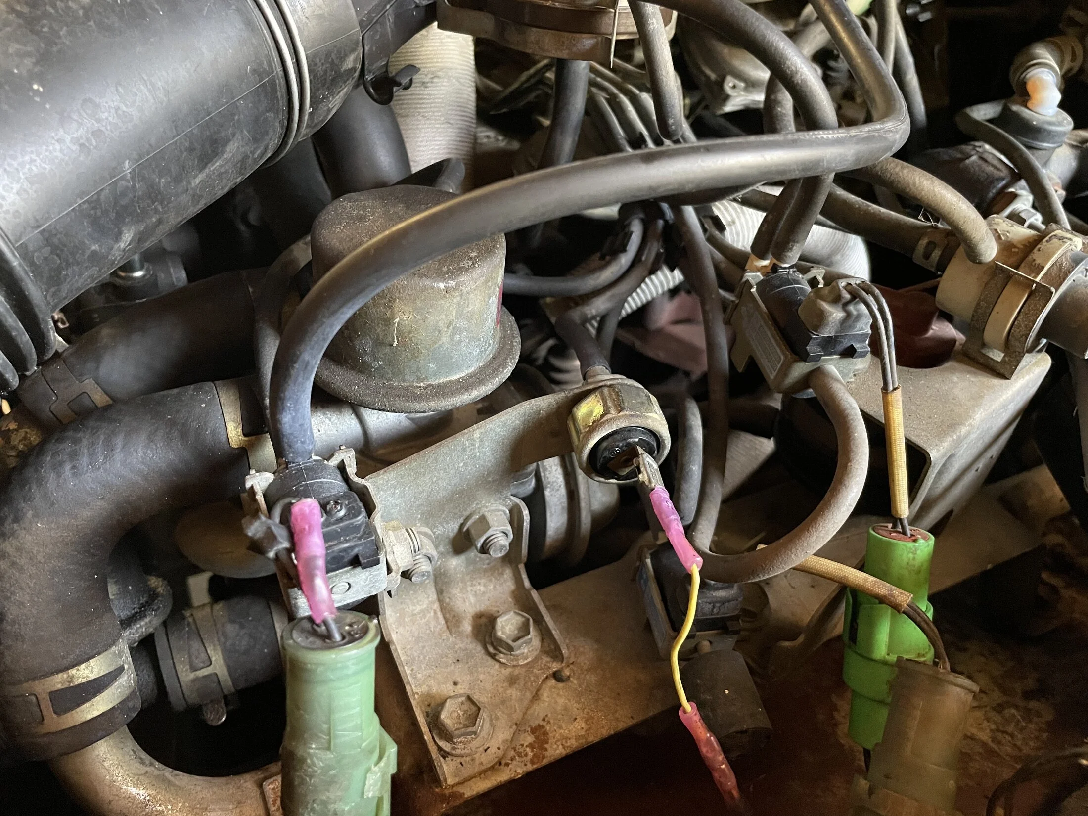

Emission check ongoing. AI system check is incomplete - I can pull and hold vacuum manually on the ASV which reroutes the air away from the air cleaner, but both VSVs are toast - resistance is way out of spec and the system is aiming the air at the air cleaner at idle (should be exhaust, I think).
Anyway - take a look at this connection on the left, which is, um, not there. Mickey got to the wires here, PO tried to repair, and it just busted off when I pulled the "plug" or what's left of it. Wires down below that are a little munched but probably salvageable.
So looks like I'm in the market for a couple of early 60 VSVs - if anyone has them from a desmog let me know! Continuing on with the rest of it...
Unless you can find good used cheap, you can get various Japan made Aisin VCVs on RockAuto that will work well for the same price as used. But you'll also have to get a pig-tail connector. ToyotaMatt will know which one. I have the part # somewhere, for the generic pigtail that are cheap on ebay.
If I can find the Toyota part number (I've posted on MUD before) there's a substitute still available that has the built in lead, but you'll have to de-pin the 'T' connector and reuse the round green one.
