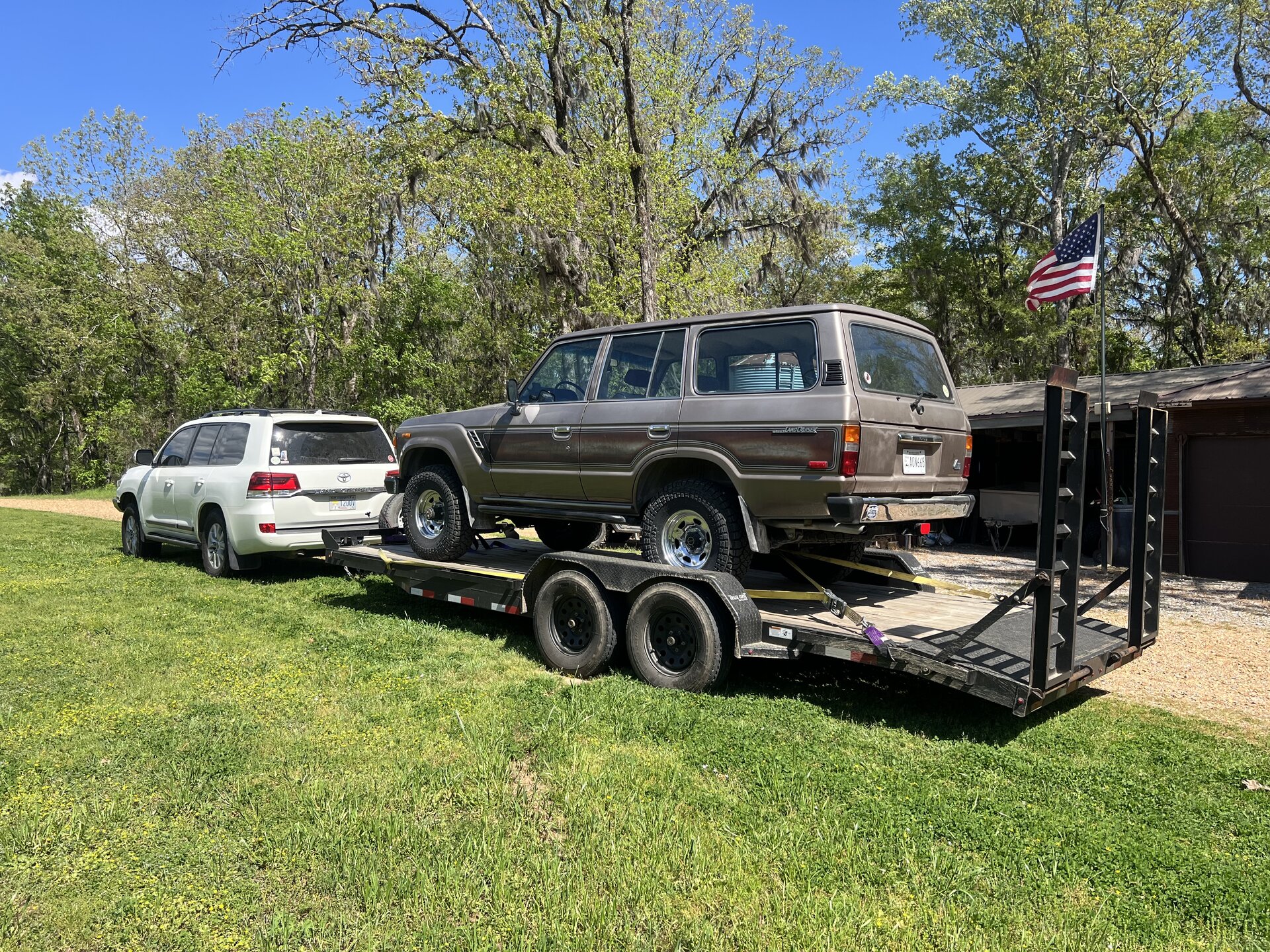

Aight. We good. System held vacuum. Radiator shop said the condenser is clean as a green bean. I added a touch of PAG to it and it’s ready for charging on Tuesday at @wct49’s shop.
Once the AC is cold it’s going home.
