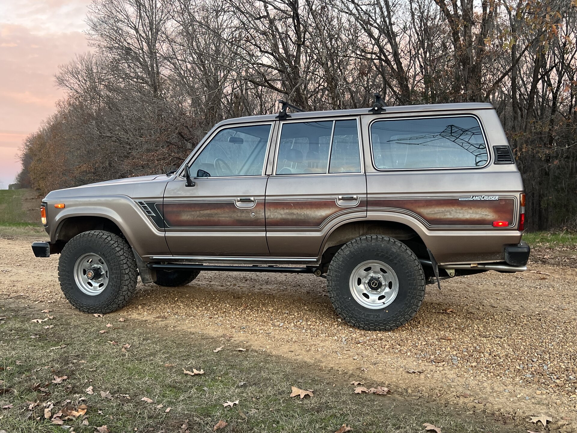

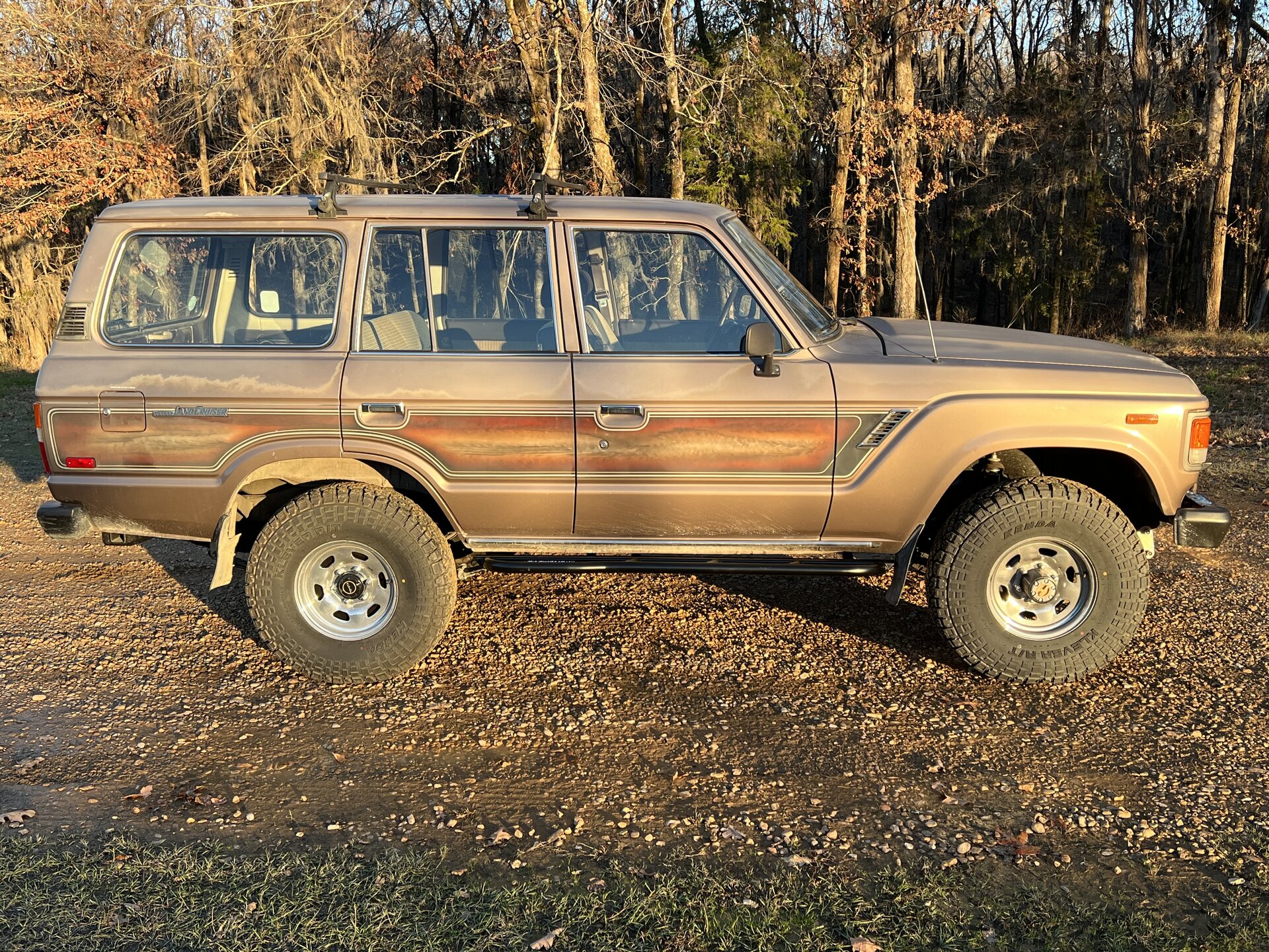

The truck is sitting dead nuts level all around with that right rear leaf pulled too
