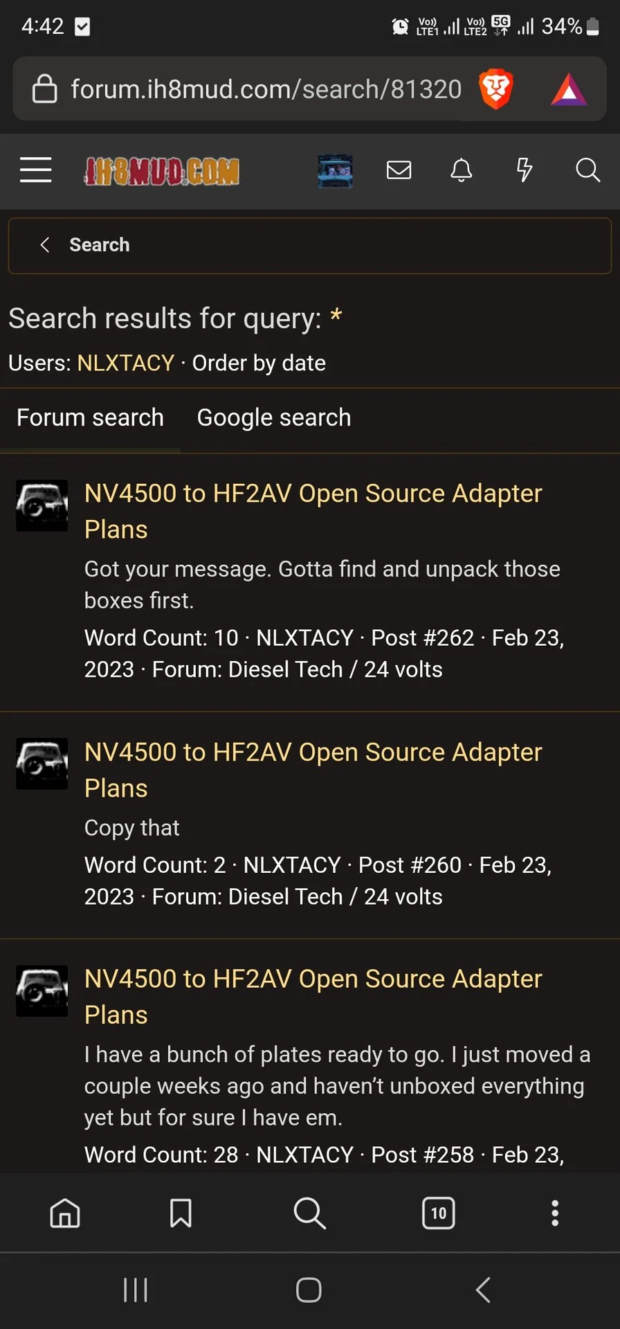

He's not posted on mud since February this year.
Mud has got to be a major party of his customer base.
Anyone who still thinks he has mud credibility has crawled way too far up his Mud-royalty ass.
Anyone who thinks they are still getting a turbo kit is deluded.
