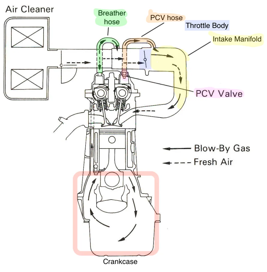

Consider the following image from 1FZ-FE Emission Control Manual:

Both the breather and PCV Valve are used to evacuate "blow-by gas" into combustion chamber for secondary burn and reduced hydrocarbons emission. In addition, the breather serves to allow fresh air into the engine.
In the stock system, the PCV Valve functions like this:
- During Normal operation, manifold vacuum is moderate --> PCV valve open but partially restricted
- During Idle/Deceleration, manifold vacuum is highest --> PCV valve open but mostly restricted
- During high load/WOT, manifold vacuum is minimal --> the PCV value is fully open = most flow.
- Excess pressure will be equalized via Breather hose and the system *should* operate at a slight vacuum to prevent blowing out seals in crankcase.

In conclusion, with the intro of FI, the PCV Valve opens less and thus a larger proportion of blow-by gases are routed through the breather and into the Turbo. Adding catch cans to both the breather hose and PCV hose helps capture blow-by gases before it is routed into the compressor and/or intake.

At FI High Load, the PCV Valve operates the same as the "Engine not running or Backfiring condition" which pushes the PCV Valve closed and forced blow-by gases to evac via breather (into turbo)
If, at high loads, this is what happens to the PCV system, where is the filtered fresh air coming from (in this particular scenario) that would otherwise be supplied by the breather hose?
Should there be an additional means of supplying fresh air (into the crank) to compensate?
I’m thinking this could be an issue during prolonged boost, say a long uphill drag?
Unless I'm overlooking something, there is no other source of air into the crankcase when PCV is blocked and breather is functioning to alleviate crankcase pressure.

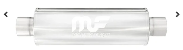

I tried a Magnaflow straight through muffler and promptly wanted to blow my brains out:

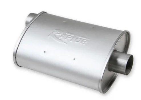

Then I tried the Raptor Turbo style muffler and noticed the sound wasn't that much reduced but the backpressure was very noticeable:
The Flowmaster F/X muffler has an offset outlet so the air path takes two 22deg turns inside the muffler, which is filled with fiberglass. This muffler produces a surprisingly tolerable sound, not sure if I could've withstood the sound w/o the Vibrant resonator.
