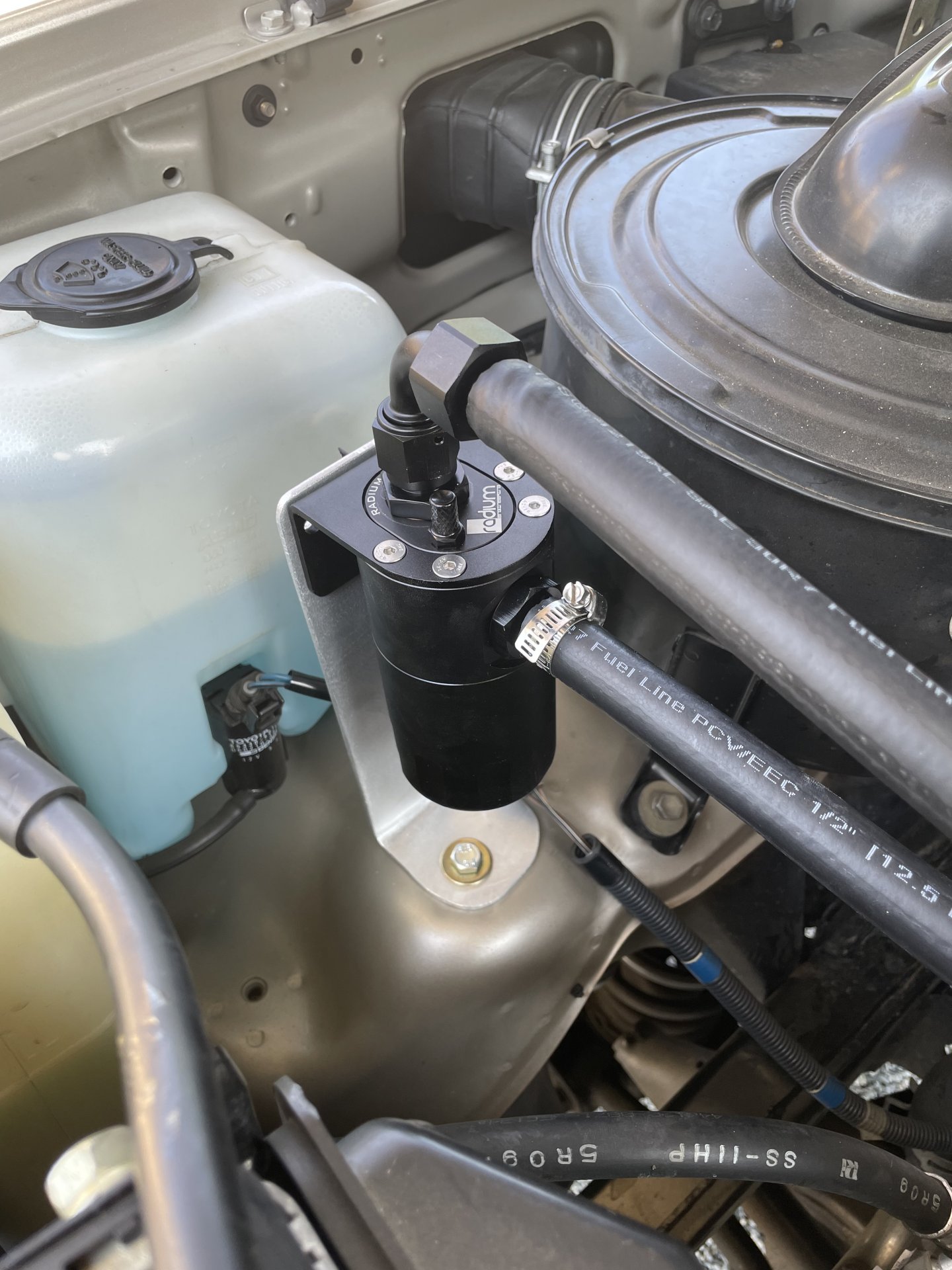

Power steering lines replaced on Saturday with Parker push-lok 801 (pain in the dick because of space available but simple), so I was able to put in the oil catch cans today. Turns out my creaky steering noise for the last 2 weeks was actually because I have been neglecting the power steering 😭 (<50 miles driven on it so I’m not concerned)
For OCC:

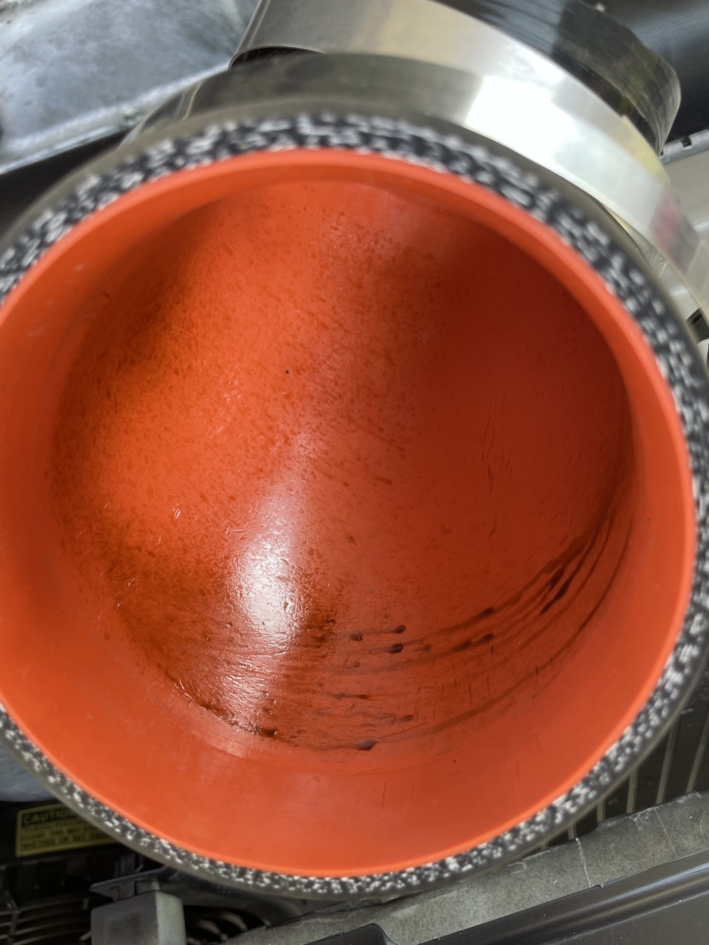

I checked the intake hose and turbo for “fume residue” as a “pre oil catch can” data point. Keep in mind I only have about 1-1.5k miles since turbo install but on stock engine with 180k miles.
Photos show “fume residue” on the intake side. Minimal pooling on hard intake pieces. The “fume residue” on the rubber intake piece feels chemically fused to the surface.
Two oil catch cans installed: (1) pre-turbo intake and (2) intake manifold.
I made (2) brackets to mount the OCC’s to the body.
For pre-turbo intake, I used 1/8” x 3” aluminum with a simple “90-ish” degree bend to use threaded hole by the washer fluid reservoir. Bolt is M6x1.25 (I think but will confirm and update) with blue threadlock.
For Intake manifold, I replaced the throttle cable holder near the charcoal canister with a piece of aluminum angle using the stock bolt.
