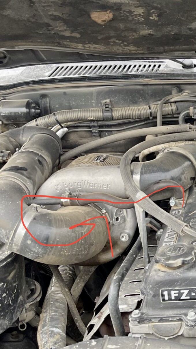

there is really no way around PCV unless you vent it to atmosphere or the exhaust, but that would be against emissions laws…
I would like to see the PCV valve moved or another check valve added closer to the manifold(green circle in pic below)… as pictured boost pressure fills the hoses and catch can, then stops at the PCV(red line)

Great find and totally makes sense. Rather than installing a second check-valve on PCV line at manifold, I'll cap off manifold and move the PCV line from manifold to the intake tube with an OCC inline.
If we were sticking with recreating the stock system, it seems to me that breather vent hose belongs hooked up to intake between air filter and pre-turbo breather tube (now used for PCV)

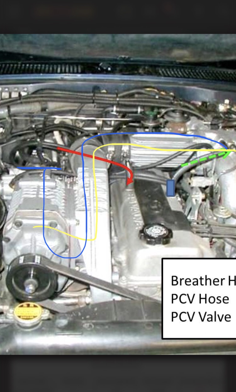

the theory behind 2 hoses is the gasses will always have a source of suction to evacuate: to the manifold when vacuum is present there, or the intake tube when no vac in manifold. Is the vacuum required for proper venting? Probably… so going to 1 hose or only using one source of suction may be an issue.
the biggest difference in the PCV from S/C to turbo is: the location of the throttle valve. S/C: throttle valve before charger, turbo: throttle valve after charger. (Manifold)Vacuum starts at the throttle valve(blue in pic below), boost starts at the charger(yellow). Plumbing the PCV hose to the “post throttle valve, pre charger” port on the t-body as described in the linked thread, the system would operate the same as where it is installed in OEM configuration… because, the port on the t-body is pressurized on with the turbo set up, but is only a source of vacuum on the S/C set up…

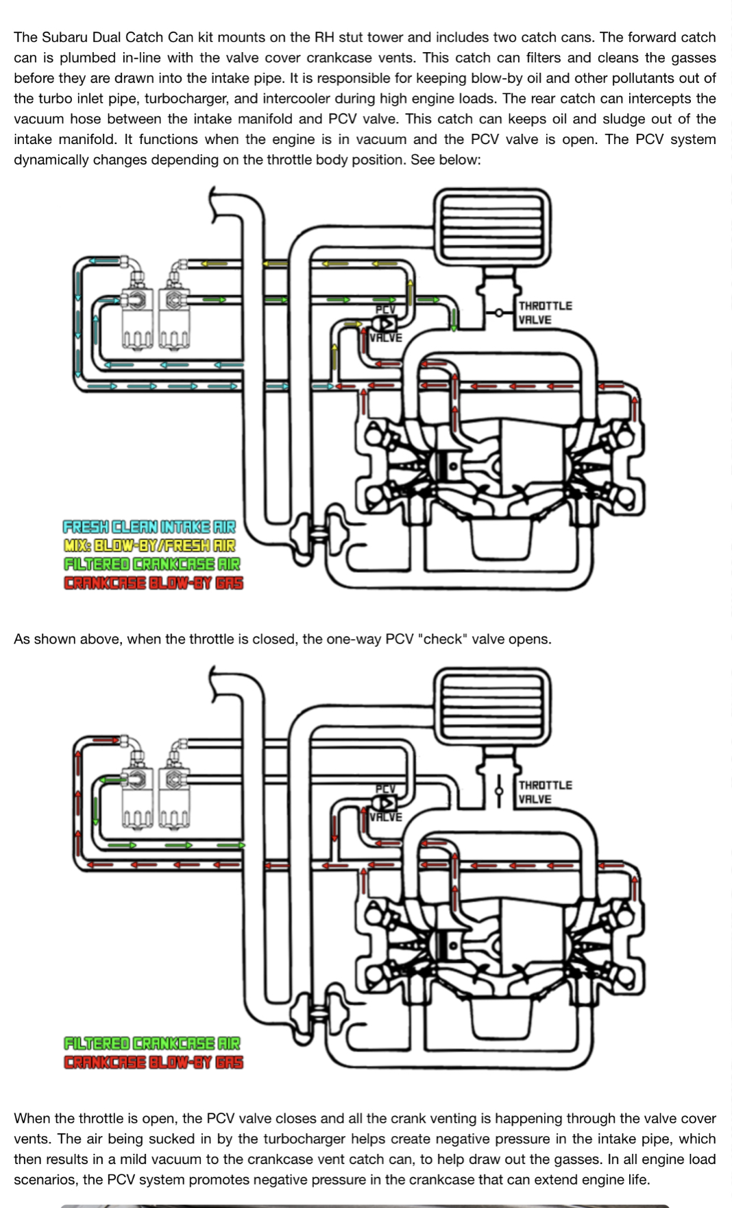

Their blog post explained the issue really well with images. Obviously, we have one PCV-Manifold line only

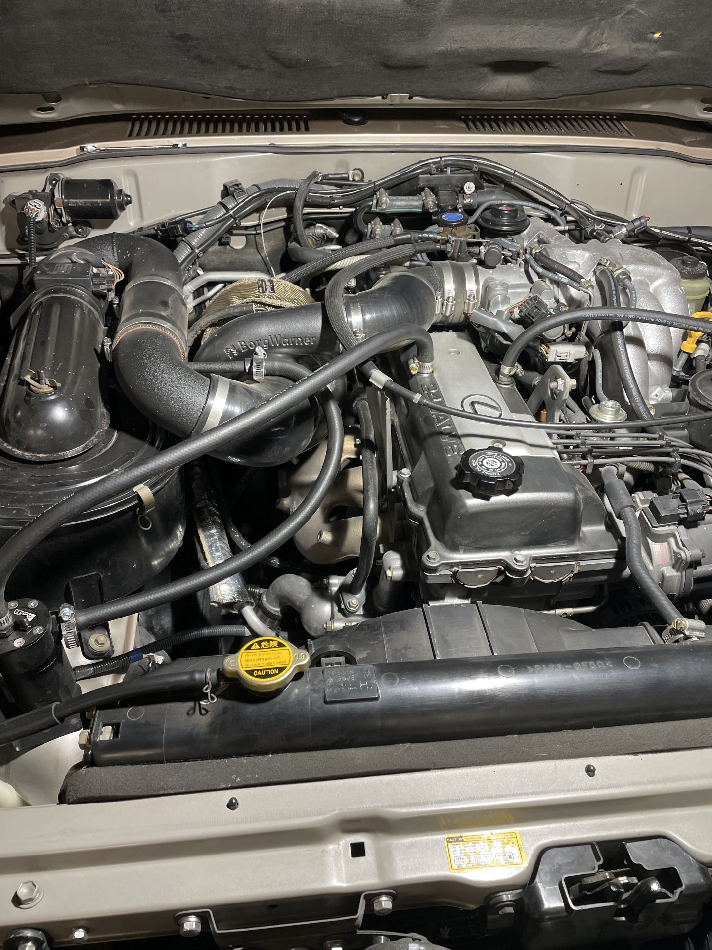

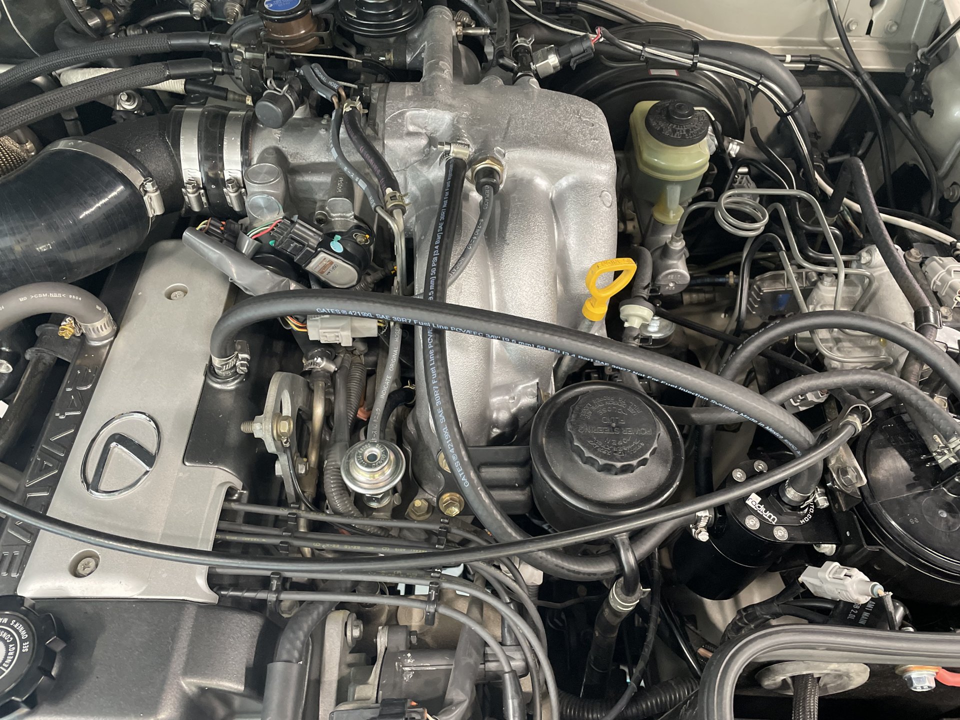

For what it’s worth, here are two Radium catch cans plumbed. I have probably 2000 miles on them now I’m this configuration. A simple L bracket just stands on an empty fender bolt, and if you whistle out the holes on the Radium bracket provided they actually line up to the Charcoal canister studs. I need to buy some angled fittings to clean routing up, just haven’t sourced any yet.
^ that is super clean install, thanks for sharing. So, you have zero oil puddle in the compressor housing after this mod? Could you show us a pic of it opened up, when you get a chance, that is. Thank you for the time.

Fumes enter from the top hole and leave the can through the side. Both cans will have 90 deg pushlocks on top so that hose routes well.
Catch can between PCV and Manifold has a PCV Valve on the "exit" from the can.

These are Radium Engineering cans, same as what CJK just ordered up. I’m on the road, currently Utah, but will check for oil pooling when I get a sec and report back. Based on this discussion I may swap the hoses on the passenger can, though Radium’s instructions say you can plumb them either direction.
the absurd amount of hose under the hood bothers me too, and I’m curious how the length of hose affects vacuum etc, but I was in a rush to get these in place after having sonic cleaned the intake. I’ve probably collected 1/4 cup of oil between the two so far. More in the PCV can, but probably 70/30.
