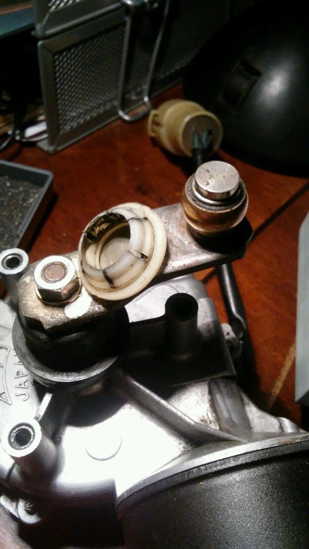

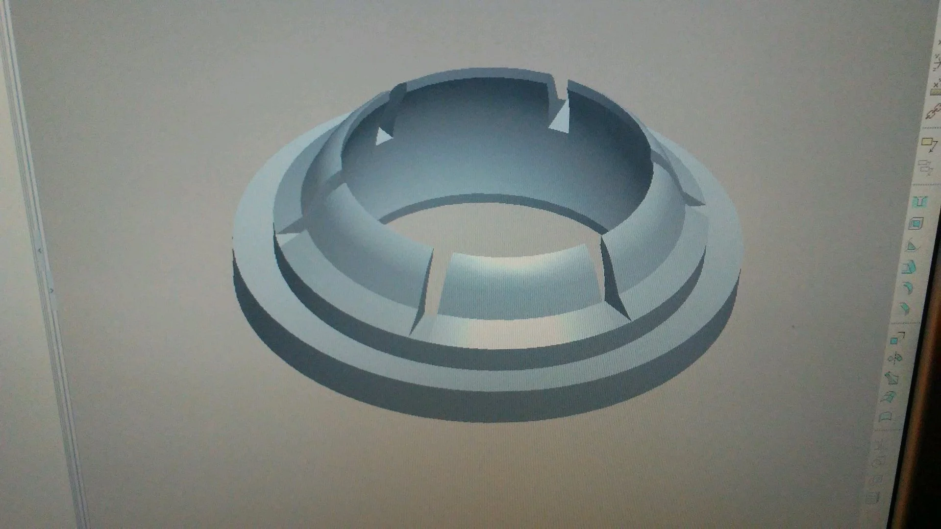

I can't find them anywhere so I’m just going to make them. Please someone let me know if these are being made somewhere before I really waste my time.

Last time I messed with wiper linkage and the wiper motor I was concerned about the condition of the bushing. Instead of popping off the linkage from the wiper motor arm I used a small puller to separate the arm on the motor.

Do you have the conical part? The flat part that fits over the cone end is what breaks. ACE hardware has a replacement flat washer for that.
Ace drawer parts section, Drawer is nylon washers, part # 59563-Q , a 7/64 washer,seems like 2mm, fit onto the original socket as the lock washer. Have to file one side to make it fit the 93 4Runner linkage. Fits Cruiser fine.

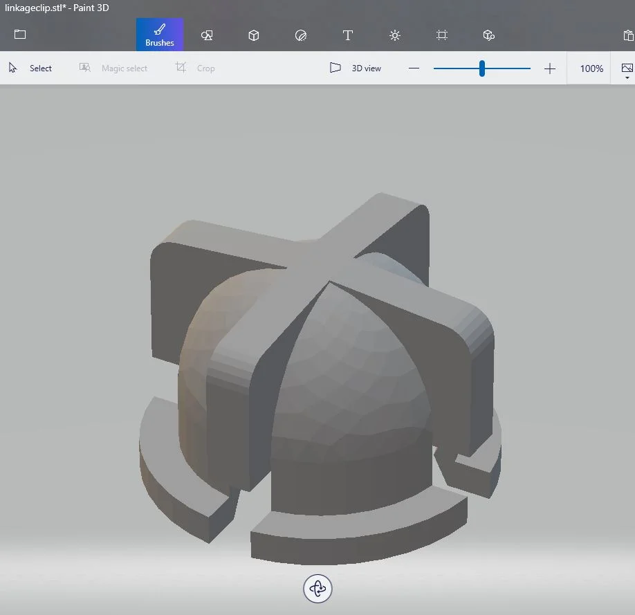

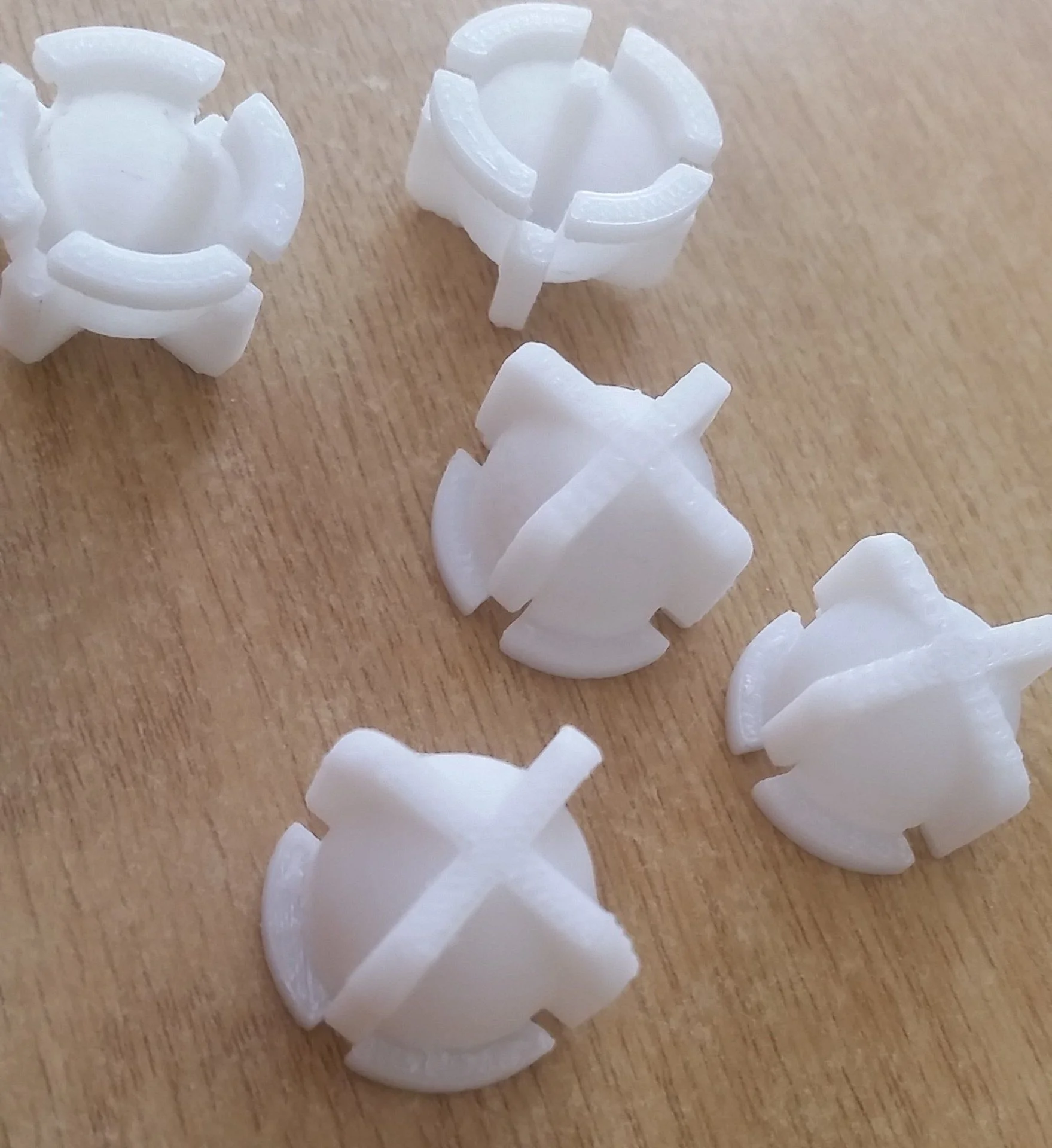

I have just had a bunch of these 3D printed. Waiting for the delivery. My clip looks different though - I measured it up and modeled it as a .stl model. My cruiser is an '84 HJ60
