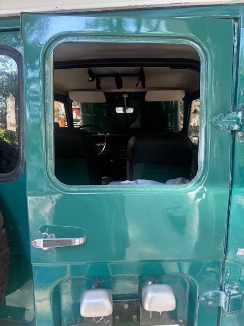

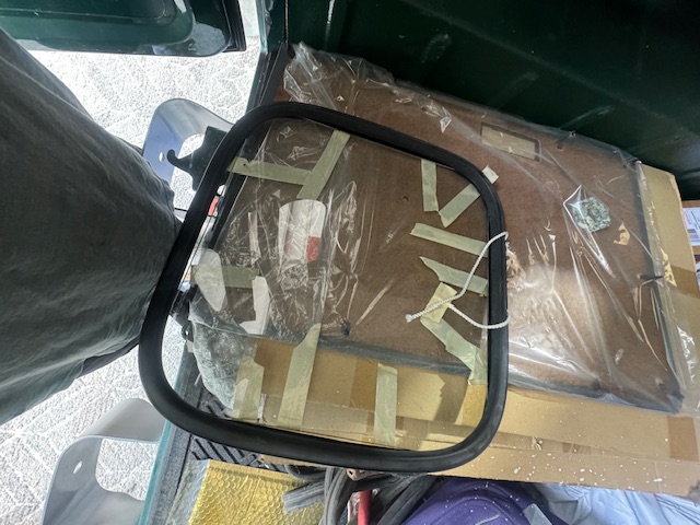

Glad I have found this information you guys are discussing….My US spec May 1975 FJ40 has ambulance doors and I have been sitting on a set of window weatherstrip for the last 18 months. The slight ding in the door bothered me so I cut the old weatherstrip out and repaired the ding and re-painted and polished the door.
I am trying to re-install the glass and the new rubber for 10 days now. Usually after 30 minutes the frustration gets the best of me and I give up for a day. My latest attempt is for the rope trick but either way the glass seems like it is 1” too big EVEN THOUGH it’s the glass that came out of the door.
Could this gasket sizing issue be something to consider? When I ordered it, it was for a 1975-1984 ambulance door FJ40.
It could also be something I have never done before just biting me in the butt…
View attachment 3708820View attachment 3708821
Are you spraying it with soapy water or silicone lubricant before trying to get the glass in? The YouTube videos I've watched about it say you have to spray it with soapy water or silicone lubricant to get the glass in. Here is another video of Mike installing the glass in an FJ40:
Thanks @FloridaLife …before I started this I had built up an arsenal of knowledge, I loaded my old brain up with as many details as I could. Yes, I have seen a Mike Restores an FJ40 several times including the comment he made about making his own tool with the coat hanger wire but should have bought the manufacturers tool.
Armed with that and reading every potential piece of information I could, I can only believe, I may have the wrong gasket. Ordered another set last night about 2:00am EST since this is a thorn in my side. If it still F’s up, I’ll have no problem bringing her to a glass shop where it may take more than a conversation with the guys there to get this done.💰. What’s ironic here is that my very bestest friend and 35 year riding buddy owned a glass shop and did this stuff for a half century. Sadly he is no longer here.
