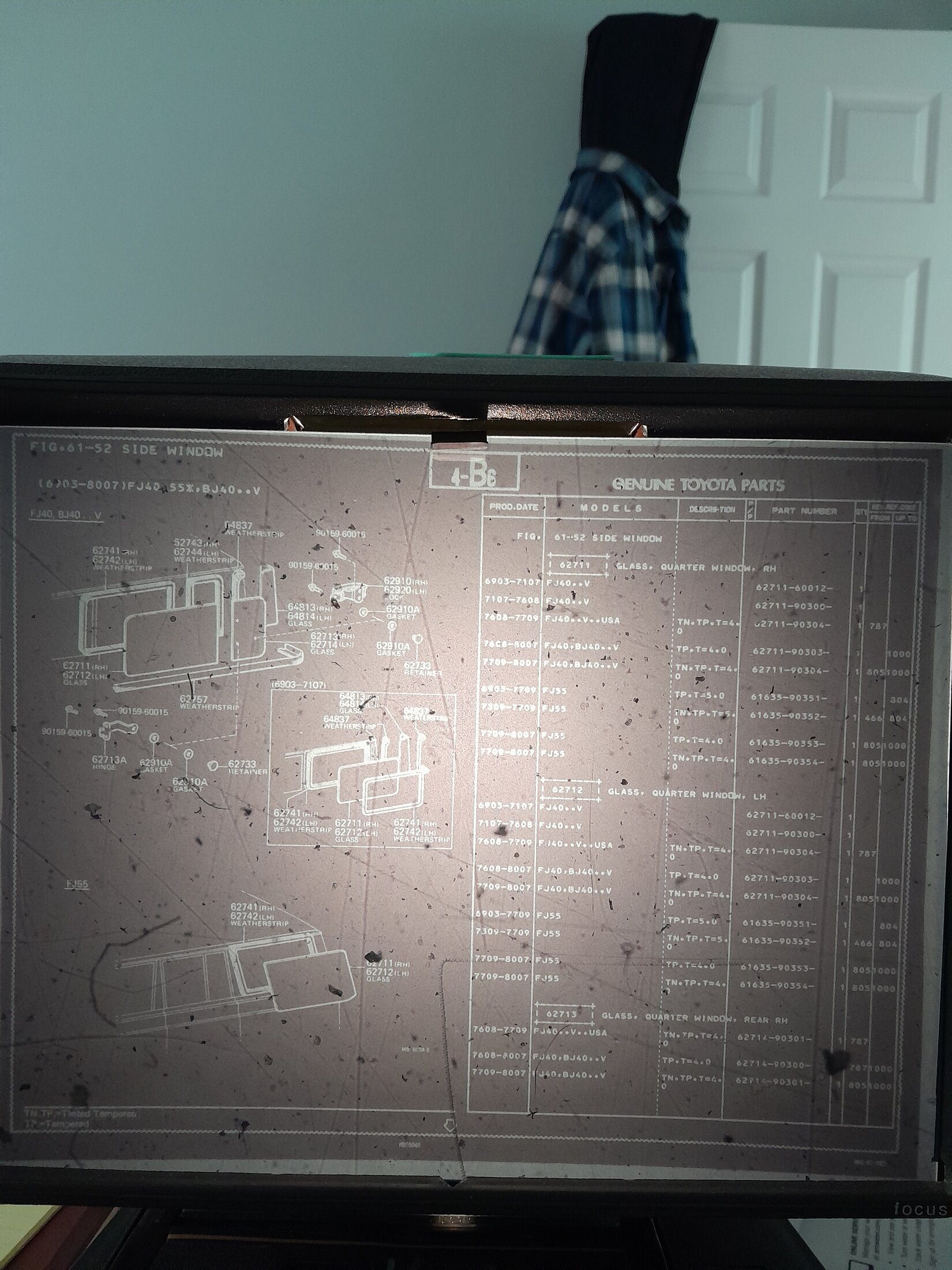

I can't be of much help here as your year truck shows no description. I have no personal experience measuring the thickness of my Jan '72 truck windows. As noted, the "T" in the description column stands for thickness in millimeters. Four millimeters is close to 5/32's of an inch, or just under 3/16's.
Thanks for checking.
On the corner glass 7/71+ it shows this on the part break down it shows this. TP.T=5.0 which I believe the this is for 5MM. That breaks down to close to 3/16". If the glass your measuring is has any symbols like these it mostly OEM.

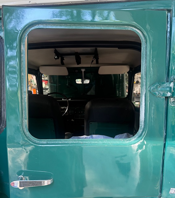

I was out measuring my valve cover seals so I put the calipers on my rear ambulance door glass and have the same 205 thousandths

Ambulance door glass will have the one piece weatherstripping. The earlier glass with the locking strip allows for flexibility with new weatherstripping that isn't dried out and brittle.
@Living in the Past sould you know if the roll weatherstrip seal would work on the ambulance door? It just APPEARS that the new piece of 1 piece rubber exceeds the inner perimeter dimensions….or in a more practical description: that glass is way too big
I bet it would work. They use the exact same thing on boats, RV's, and anything with flat glass. The reason why a lot of people like the 1 piece formed seals is because over the years with heat and cold they don't have to worry about the seal shrinking and leaving a gap. But, if you cut it a little long and push & stuff as much into there as you can, then even if it shrinks a little you shouldn't have a gap. And the local glass guy said he puts a little polyurethane on them to prevent them from shrinking and separating. Today I also had the idea of using a little dab or rubber cement on the ends that butt up to each other. If the new seals last 53 years like the originals did, I'll be long dead and gone before having to deal with it again.
I say go for it. It's cheap enough on Amazon to be worth giving it a try. And remember, my local glass shop said they would not even try to install the 1 piece, only the 2 piece, so it is bound to be way faster and easier.
In the frustration , I decided to spend the big bucks and try the OEM rubber 1 piece window seal. It arrived tonight and is SUBSTANTIALLY more rubbery and pliable than the aftermarket ones I had purchased last year… almost as soft as silicone. It’s at least telling me I could have a better chance of getting it to flex around the window seat
