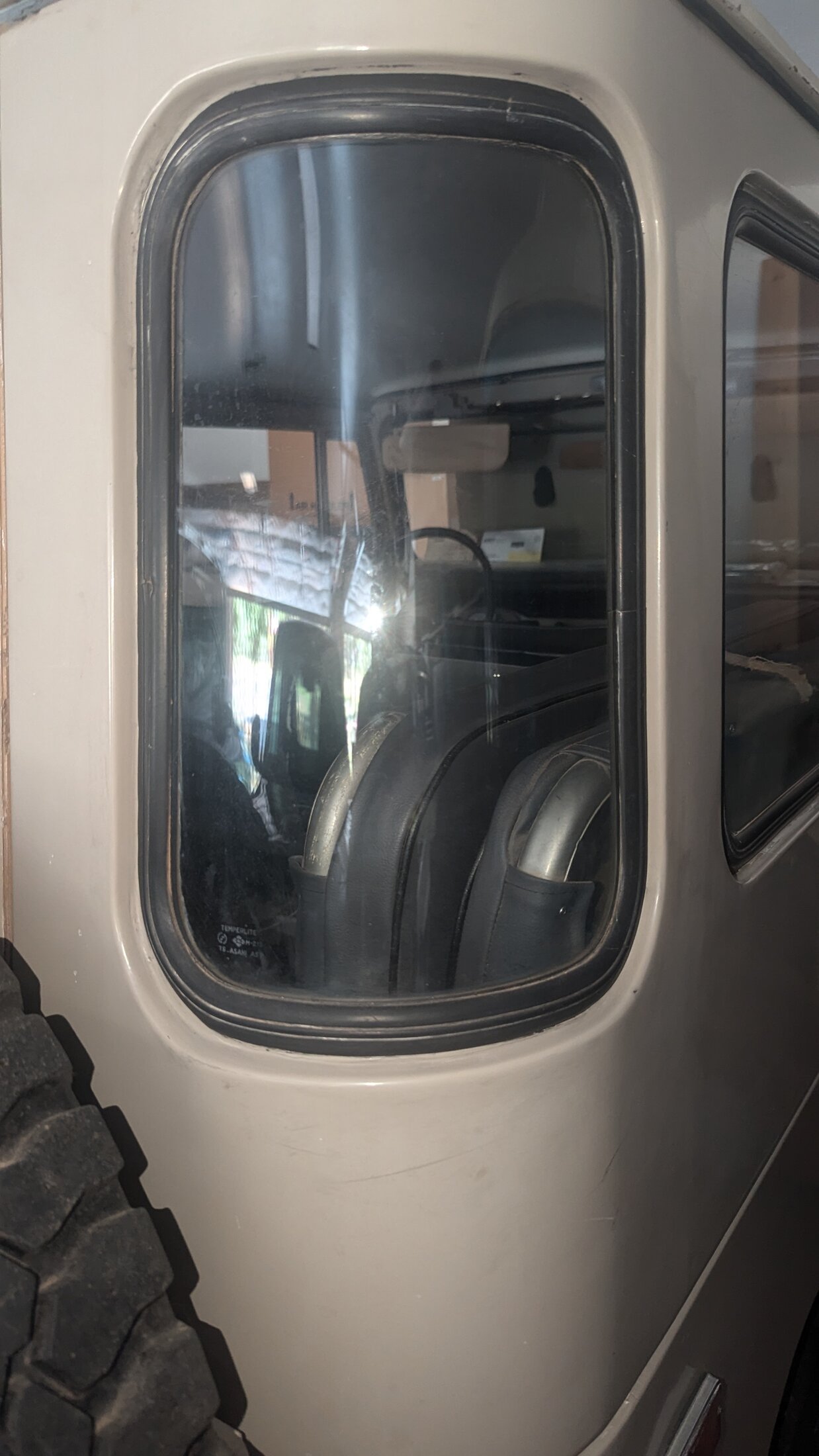

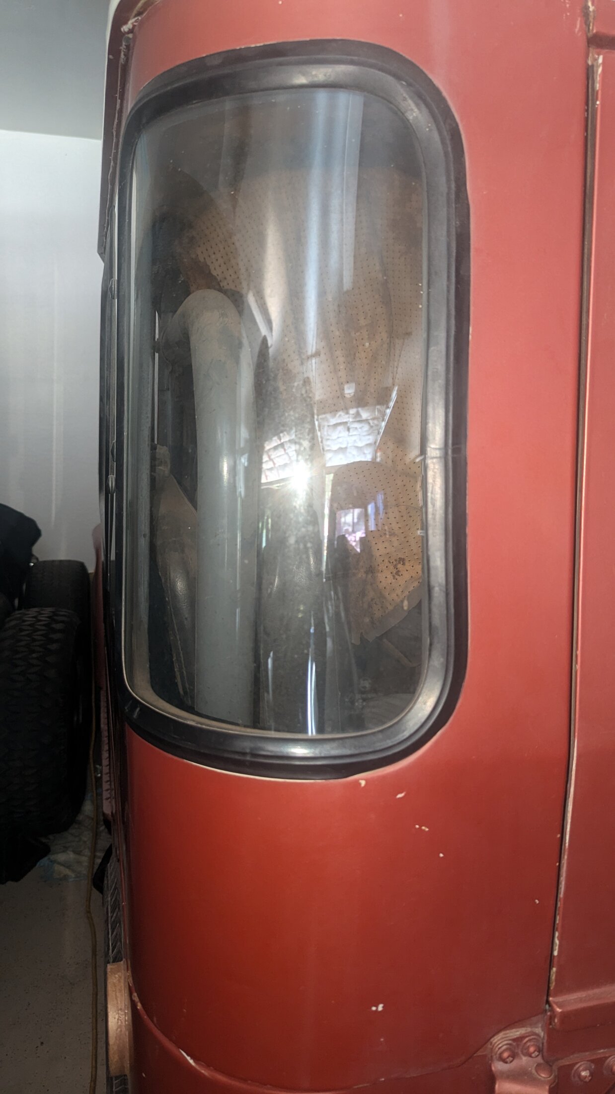

My point is the two different styles.of weatherstripping fit in the hard top sides and hatch differently. Because of that it has to match the glass. Unless someone is making one piece weatherstripping to fit like the early two piece the glass will not fit unless they offer two thicknesses to work with different size glass. Here is a 10/69 early style.
Then a 73 from an unknown month I running on my 68.
You install early glass on the later style unless it custom to fit the smaller glass it will be loose. Just be sure you know what your buying first. Could be someone making this weatherstripping, I've just never heard of it.
