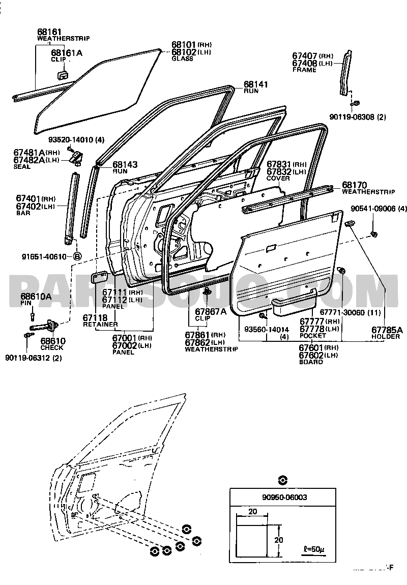

My painter removed the belt moulding from my 62...and many retaining clips broke. I went to work to find replacement clips since the rubber/felt was serviceable. I went to the Toyota FJ62 parts diagrams, and the belt moulding was only shown as an assembly part (chrome strip with the rubber/felt weather strip secured via the white clips). There was not definitvely a replacement clip shown. Further, it is not shown that the weatherstrip portion is available for the 62.

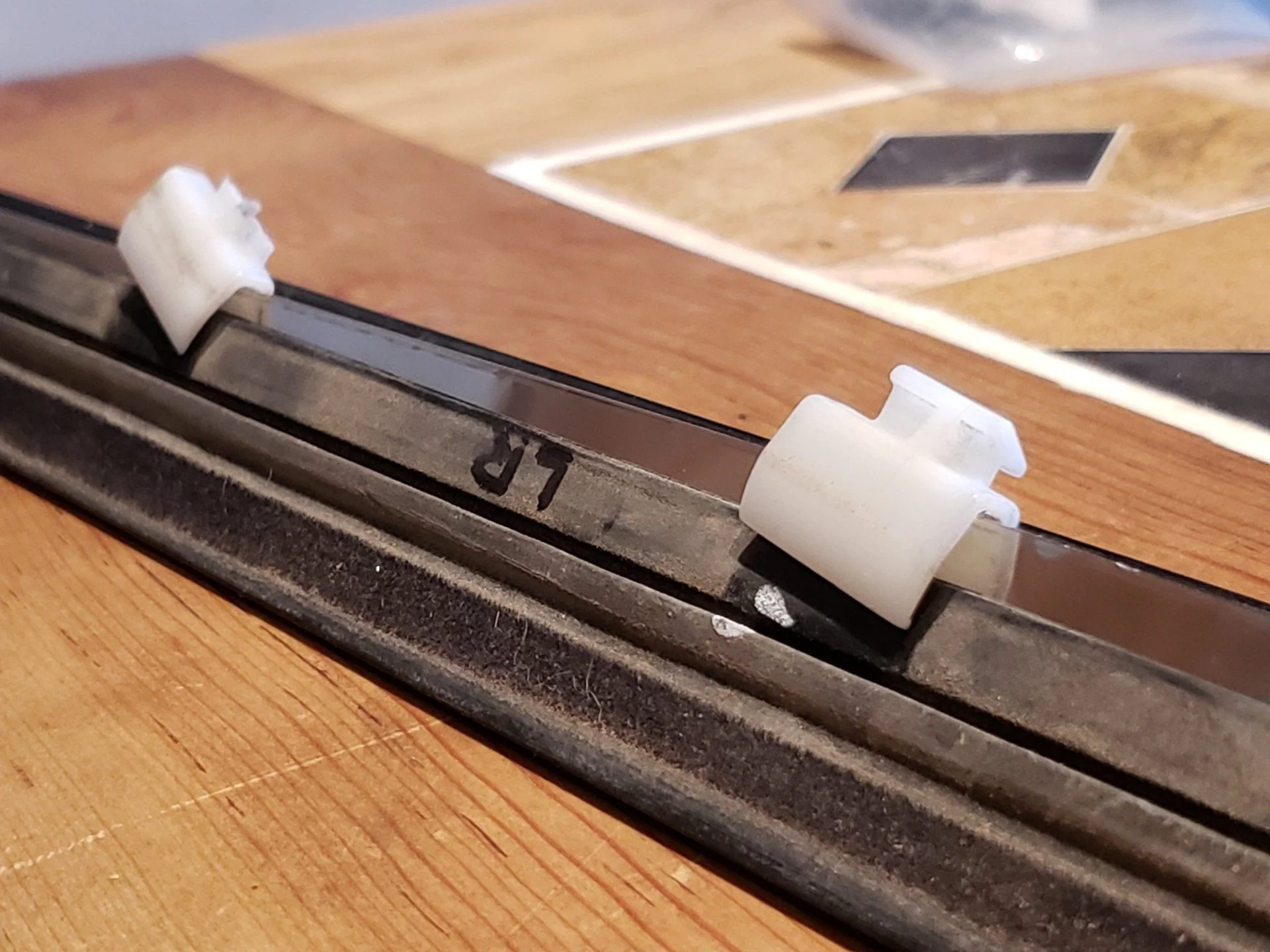

While you wait for the parts to arrive, you can go to work preparing. The first thing you can do is remove the original white clips that hold the weatherstrip to the chrome strip. Notice in the first photo one that is intact, and one that is broken. You need a tool that is not too sharp, but that you can get under the clip on the rubber side, leverage up on one side, then push up and off. This will also need to be done with the new clips; more later.

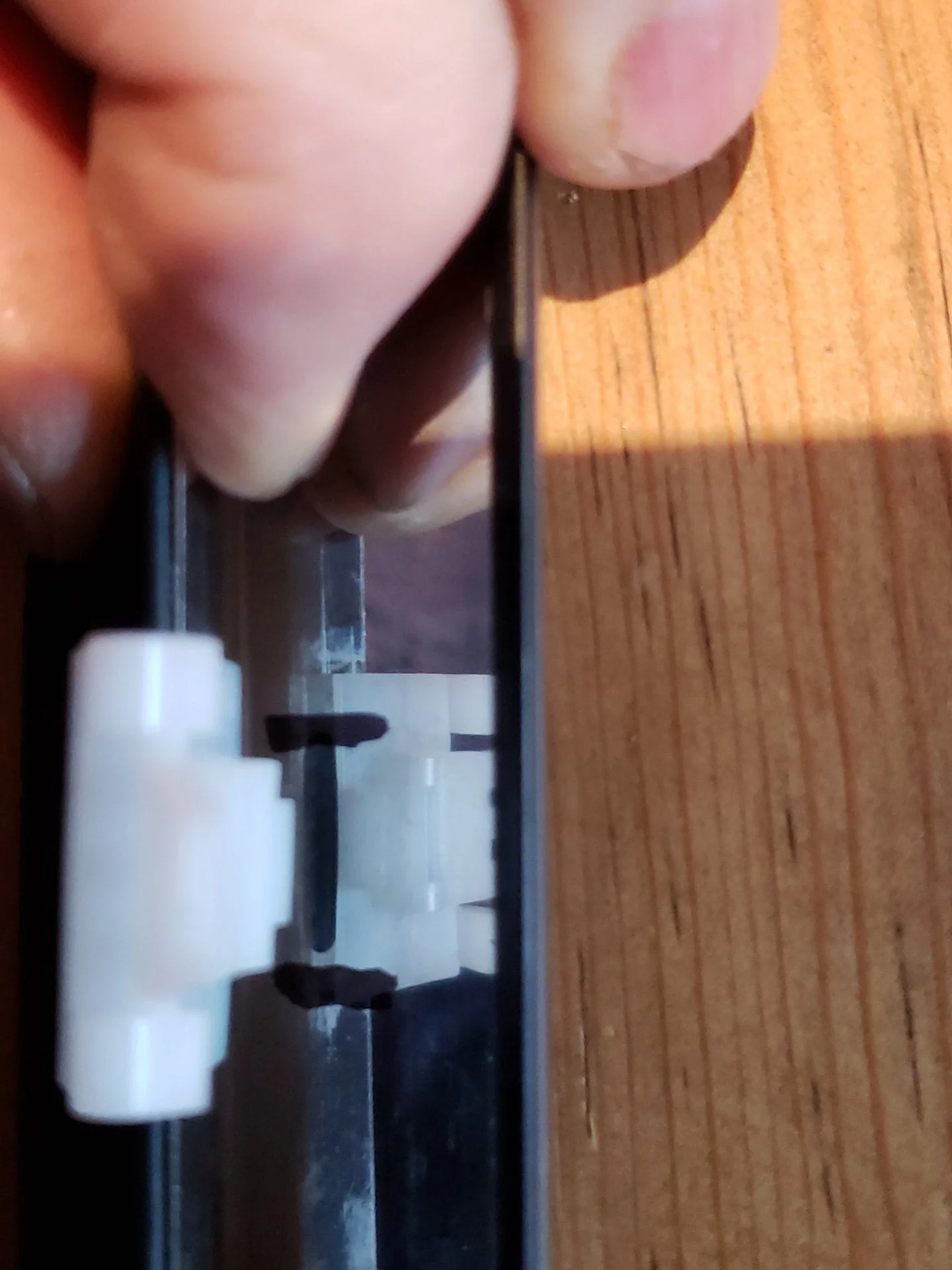

Upon removing these you will reveal slots in the chrome piece that are under the weatherstrip and clip. These slots correspond to the ones in the outer door sheet metal at the bottom of the window frame. The white clips serve to hold the weatherstrip to the chrome belt moulding, but also to clip into the sheet metal slots in the door. It is important at this point to mark the slot positions on the adjacent chrome surface on the underside of the moulding with a Sharpie so that you can precisely position the new clips when you affix the new weatherstrip onto the old chrome belt moulding. In the last photo of this post, you can see that I've already put on the new clip, centering it over the markings of the now concealed slot in the chrome strip. Continued...
Next, work on getting the new clips off the new weather strip. They hold via a little barb that slips over a little shelf of the rubber. With your tool carefully lift one edge up enough to get it over the retaining rubber shelf. Here is where there is a struggle to get the clip the rest of the way off without damaging the rubber...or slipping off and stabbing your other nearby hand (as I did mildly...once).
Position the new weatherstrip properly on the chrome belt moulding. The old rubber likely left an indelible mark that you can use to line up the new. Sliding the new clip into position is easy due to the marks you made and a bit of tried and true lubrication; saliva. Start at the slot on the ends and work your way inward. If you miss the centering a bit over the marks, you may notice it is now difficult to slide the clip. This is because the edge of the clip on the chrome side has fallen inside the slot. You'll have to remove the clip and try again. As the clip easily slides down over the rubber, you want to get its barbed edge over the small rubber shelf. Sometimes you hear a slight pop when it seats, sometimes not. But you can visually verify.
