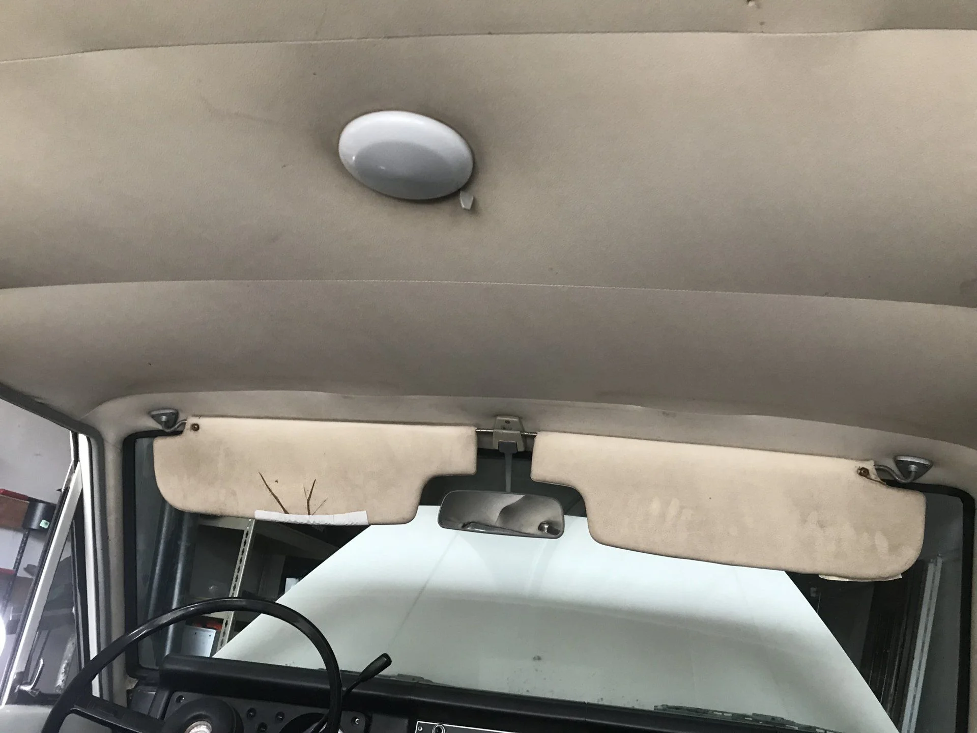

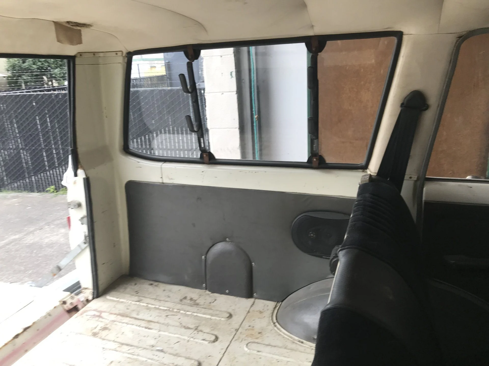

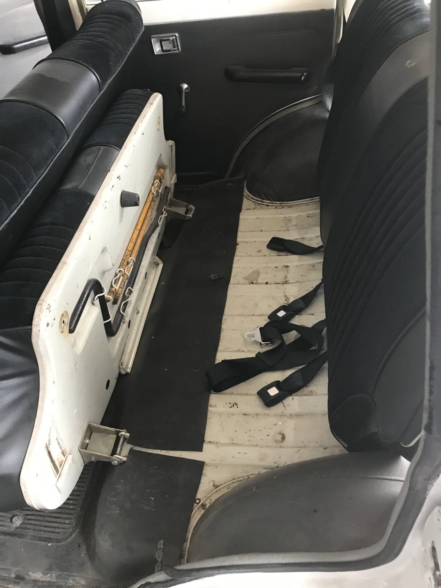

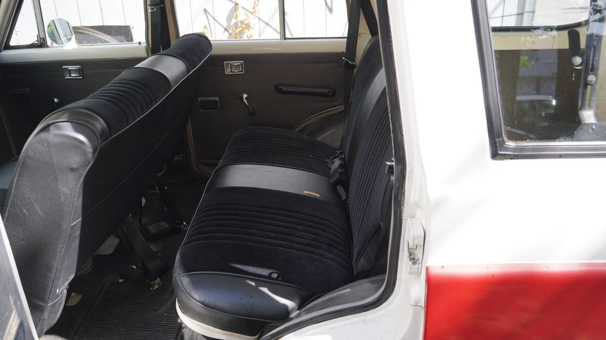

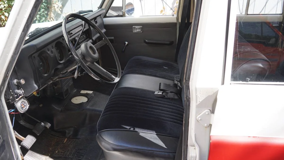

All glass rubber in very good condition even the wind wing, door panel vinyl in excellent condition, seat upholstery perfect [new obviously] (were cloth from factory an option at any time) very nice paint condition (factory colors)

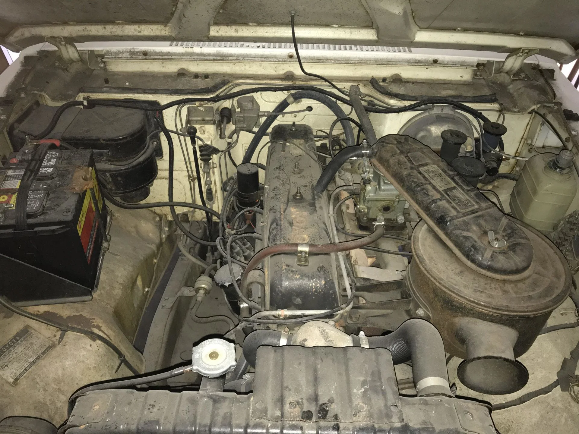

Ran and drove excellent. Doors are all straight and swing great(several stress cracks here and there). Engine bay: every thing original is there just covering grime.

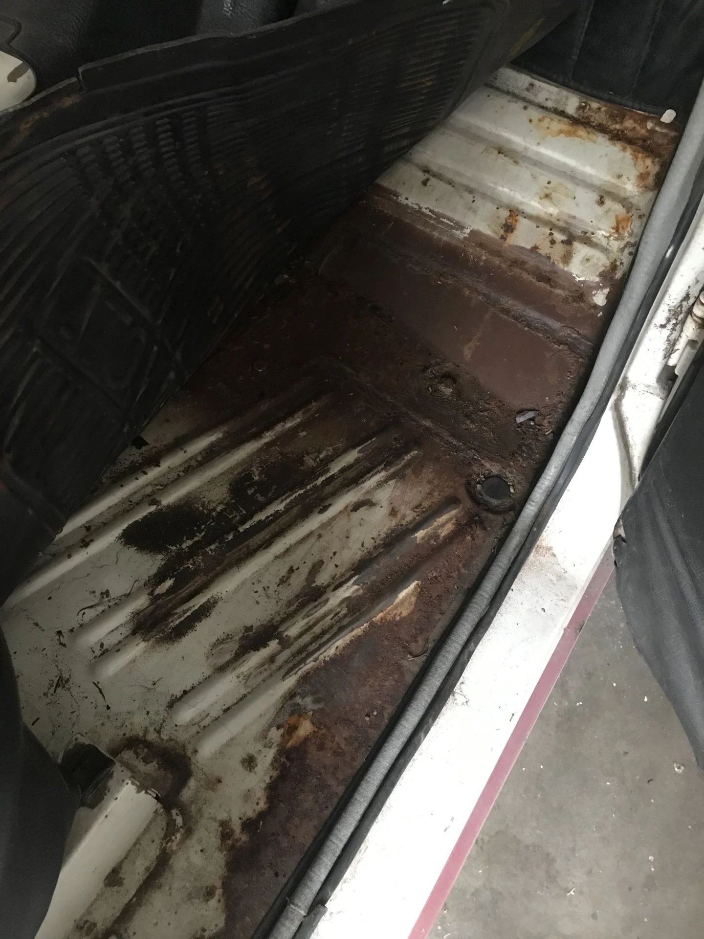

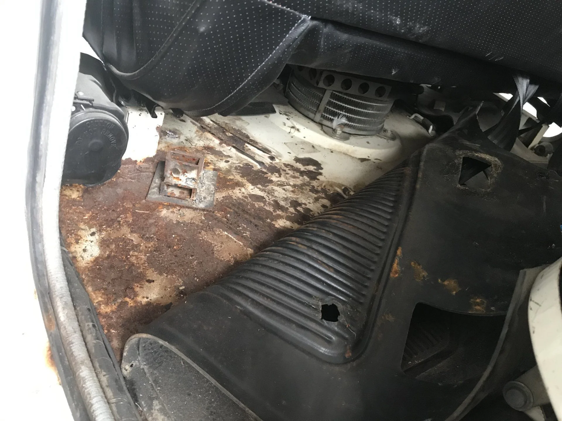

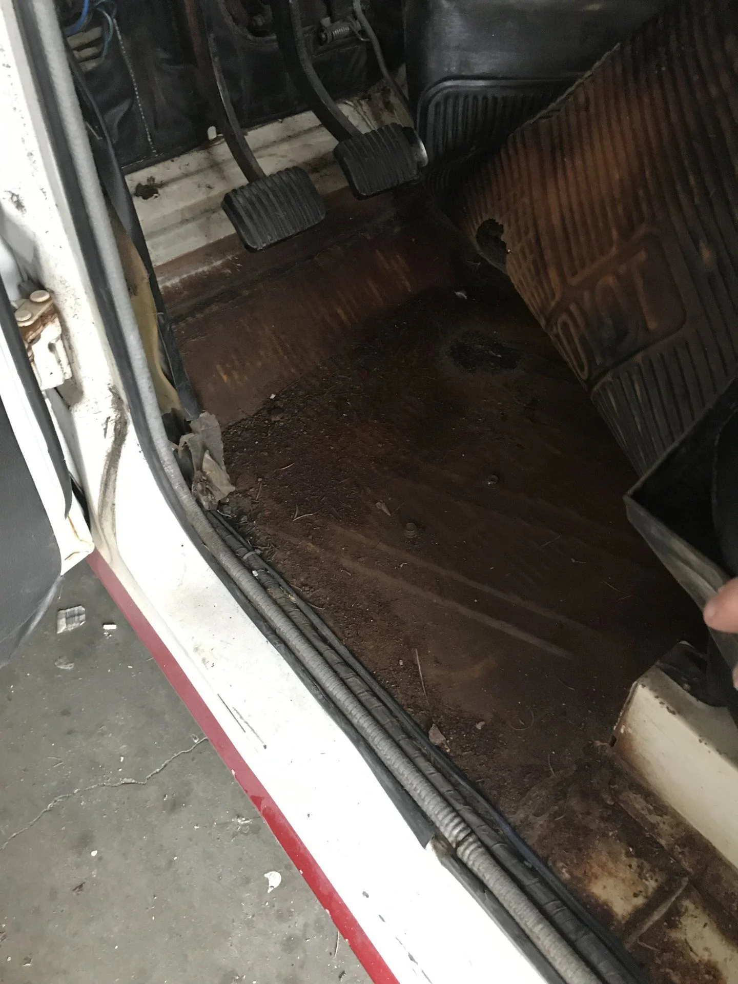

Unfortunately orange kudzu is trying to take her to the promised land where virgin studs are waiting in line. Nothing at the roof that I can tell but floorboards, rockers and the two rear body mount locations are a bit rough. All I can do for the moment is pump her full of penicillin where needed. Hopefully that and dry Ojai weather will extend her life. But I will be keeping an eye out for any of Bob's famous floorboards and rockers that may still be available some where (hint hint nudge nudge)

Good lord man, that thing is beautiful! Those floors look like they can be saved.
I feel very luck to have found such a straight driver. The orange kudzu will be a challenge down the road. For now take care of the minor stuff.

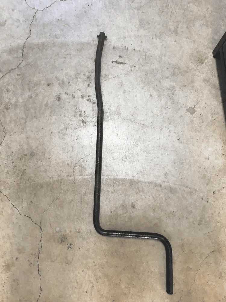

Hard to say what energy was used reconfigure this tire crank

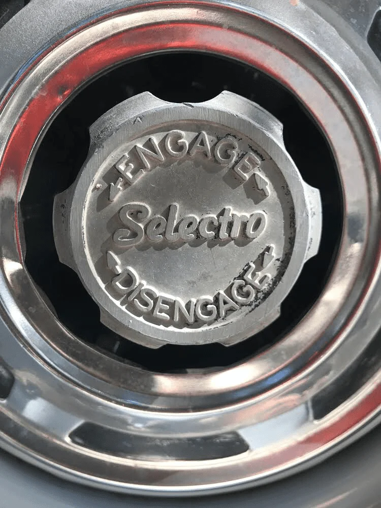

Am I correct in the fact that the dealers were responsible for installing hub release hubs?
Have never seen these before
I have the same ones on my 72 fj40, so I'd say dealer installed.

My '74 came with Aisins for the coarse spline birf.
Then in '76 when they went disc front brake came the long-body ASCOs.
I thought Pigs came from the factory with selectable lock-outs, while the 40s shipped w/ drive flanges on the front.
However, someone could have decided to dump the factory lock-outs with Selectros. I think Sears even got a private label version of the Selectro. They are easy to grip and turn. They also explode well!
