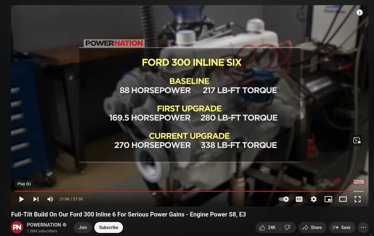

Wow, this is news to me, I always thought the 3F would be a better platform for higher revs due to 7 mains. Lots of turbo 3F engines down here in South America, I've been planning to do the same at some point. We just don't have the aftermarket support that Jeep 4.0, Chevy 292, and Ford 300 have to make a "built to snot" motor. There's a build on Powernation of the Ford 300 going from 88 HP to 270HP, by slightly upping compression, cam, lightly porting, bigger valves, better intake / exhaust / carb.. Which is a HUGE gain, but it was extremely restrictive to start out.
