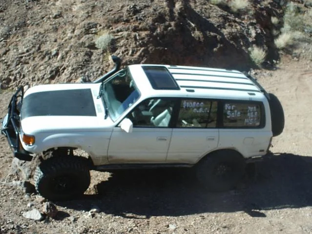

I've seen a write up on bedlining the roof like this, but can't seem to perform the right search for it. Not to hijack, but can anyone find it? I'd like to do it with white bedliner when I remove the OEM rack.
Well the only line-x I have is on the hood and roof but I plan on more!
attachment.php
Are you talking about the engine hood blackout or the roof once the factory rack is removed. SOCALFJ did a vinyl application on his hood. Several of us have done the roof after rack lining. Some have used commercial products, some of us have gone DIY with Durabak.
Can you be more specific in your wants?
I did both my flares and roof with Durabak. Here's my write up.
https://forum.ih8mud.com/80-series-...rabak-project-complete.html?highlight=durabak
Lots learned from many before me on use of Durabak, etc.
