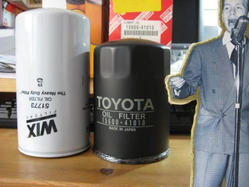

No, not the little OEM filter.
The BIG Wix 51773 filter for dump truck & forklift application.
The little filter is the 90915-20004 factory fill filter for the 2JZ/late 1FZ/2UZ/1GR engines. Still one of the best filters around from Denso. But you cannot get that one as a "Denso" marketed filter. Internal Toyota procurement only.
Denso is the Toyota filter OEM, but the aftermarket ones are made in Thailand, OE in Japan ... They seem identical to me: Same dimensions, weight, valving (that I can see), O- ring...
