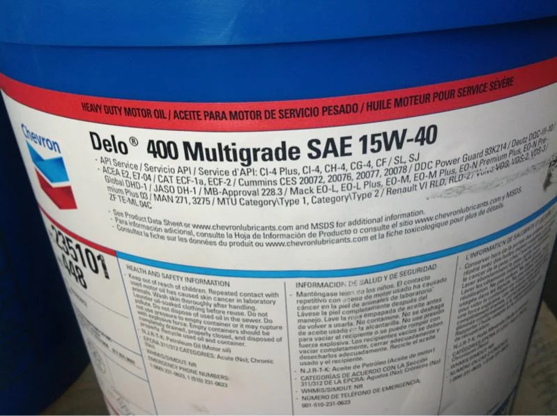

I think I found a source for old formula Delo 400 15w40. The ratings look good (SJ and SL) and the specs were good for zinc.
Whatcha think?

That DELO 400 15w-40 Mulitgrade is perfect for your 2F. I'd run it if I could find it, but it's pretty much zero availability in Kalifornia. Where do you buy it? Trucking/Fleet supply ?
Wal-Mart seems to always have it, at least the one by my house.
