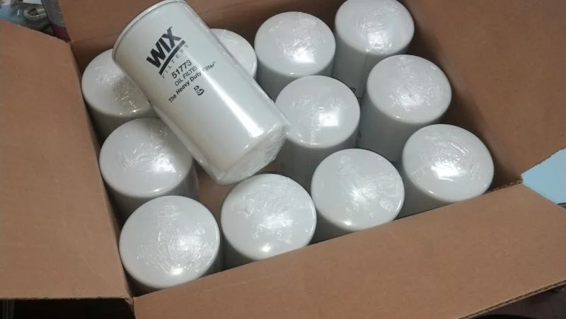

If you use the "big" Wix, should you add more oil than the specified capacity? The stock amount of oil is 8.5 quarts, how much more should you add?

Oh baby.... Santa (UPS) was just here!

Do you have a picture of this filter on your 60? I am wondering how much clearance there is.
Zack
Just got them today. Maybe someone else has a picture...?
With the stock 2F filter mounting it really does not matter what length the filter is. AND, when the motor is cool and all the oil is in the pan, the big filter will not matter.
Stop obsessing about this..
