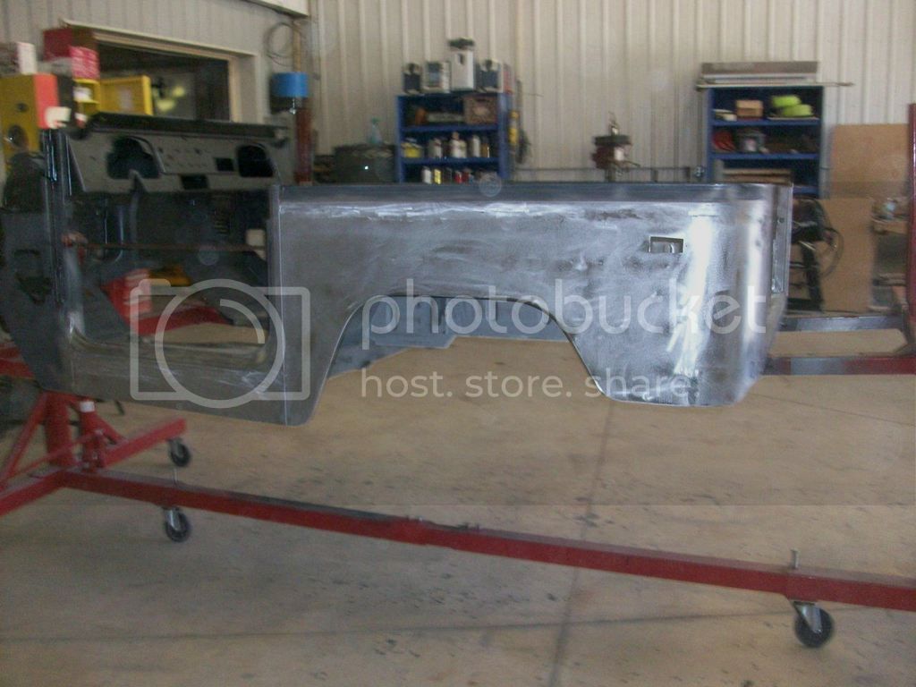

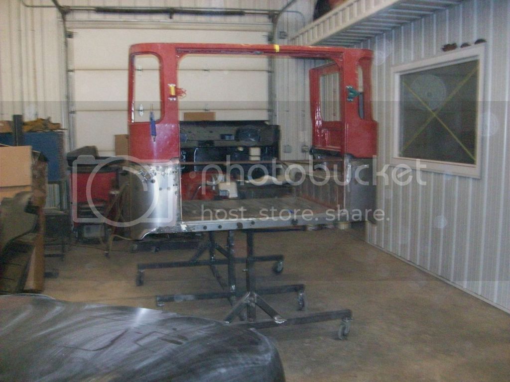

Long due for an update. Progress at the shop has been very slow. They've pretty well got the tub back put together and just set it back on the frame this week. They'll be test fitting all the doors this week then pulling the tub back off to undercoat it. At that time it'll go back on for good and work will focus on front fenders the hood and top.
The shop wants to undercoat it with a product called liizard skin but from I've read it seems to be more for interior coatings to reduce noise/heat. Not sure about that. Also I'll soon need to decide how I want to finish the interior floors. I don't really want any rubberized coatings I don't think but then don't want the painted floors all best up either. Decisions decisions!
Here are a few pictures.
Any thoughts or comments are a.ways appreciwted!

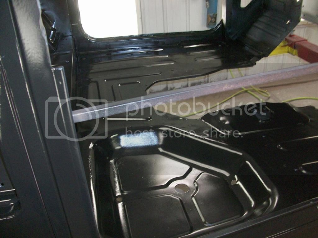

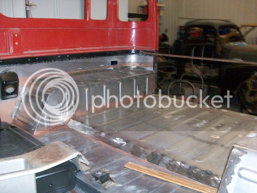

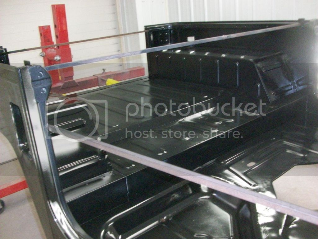

Thought I'd provide another update. Shop has been working on finishing up the tub body work and has epoxy primed the tub inside and out. They'll be paining the firewall and undercoating the outside then putting the tub back on the frame.
I think we've made the decision to undercoat the bottom of the tub with upols raptor liner. It will just be black as the shop has heard thst sometimes theupol tinted red will have a pink vast. I certainly don't want that.
Anyway here are some photos of the sandblasted then epoxied tub.

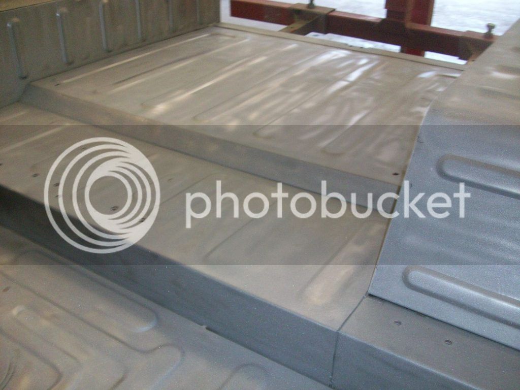

Your tub is is great shape. Your Aunt definitely took care of it.
Jdc and alabamatacomaguy thanks so much for the kind thoughts! Jdc my aunt did take good care of the 40 but it still had plenty of rust. The tub, as it sits now, has quite a few replacement panels from real steel.
