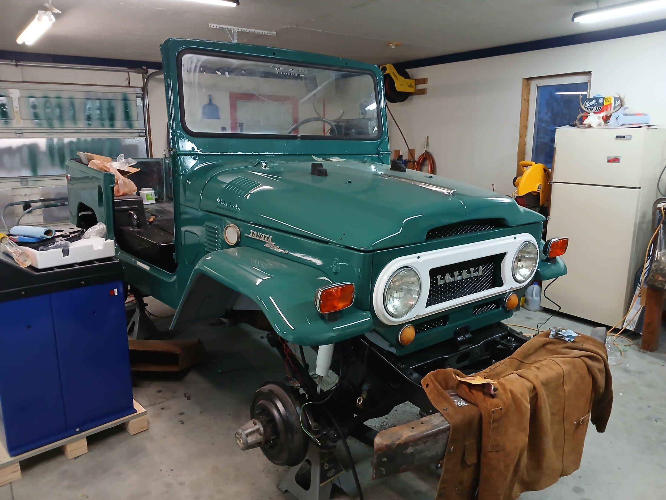

Wondering if anyone has any info for 1972 fj40 wheels. The wagon wheels on it are pretty rough. They are from 79 and are 15x7. The only thing I'm finding are trailer rims with the correct backpacking and they are only 6 inches wide. I looked for the ones from summit mentioned on old threads but the company is no longer making them.
Wondering if anyone has any info for 1972 fj40 wheels. The wagon wheels on it are pretty rough. They are from 79 and are 15x7. The only thing I'm finding are trailer rims with the correct backpacking and they are only 6 inches wide. I looked for the ones from summit mentioned on old threads but the company is no longer making them. View attachment 3880763

pics of your current rims, my guess is they aren't actually stock Toyota but I could be wrong.
