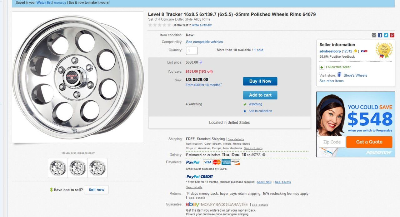

16x8.5 with a -25mm offset (3.6 backspacing)...
Thinking this is the perfect wheel size for my FJ62. Oh, and the hub bore is 108mm.
I run the Level 8 Trackers in a 15" and they've been great. I think @theron ran that same wheel in that size on his rig quite successfully.
FYI, I think you can get a much better price buying those directly from Discount Tire. Currently listed on their site (in my zip code) for $100 each.
-Ed
EDIT: sorry the $100 price was for the matte black. The polished alum is $130/ea.
Yep, I've those Level 8 Trackers, in black, in 16" and 17"....they've been great.
I also got mine from discount tire that way they count mount and balance them and I just show up for the install. They were the same price as everywhere else when I looked
