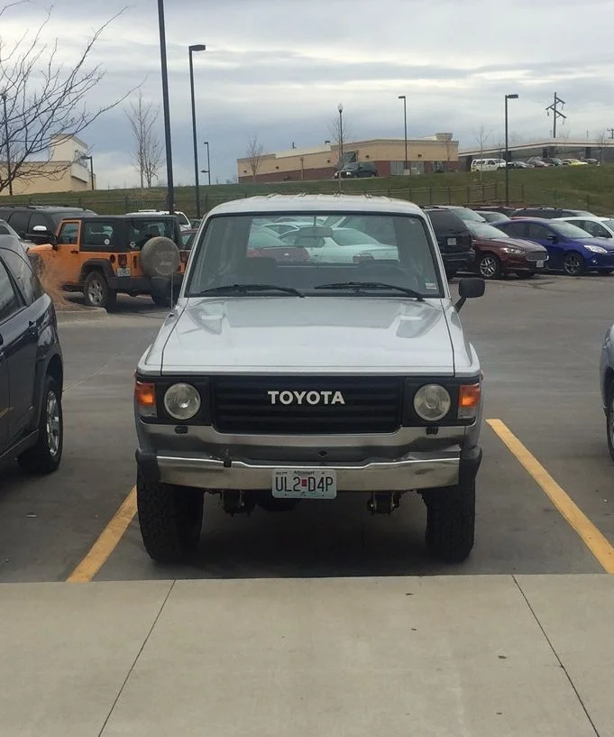

The profile looks good. Can you post pics from the front and rear? Appreciated!
Had a OME lift installed (got from Cruiser Outfitters, Kurt is Awesome!!), added new BFG AT KO2 (235/85/16) all around on new Wheel Vintiques 12 Series Smoothie Wheels - 16x7 from Summit Racing (bolted right up!) and painted flat black. Totally changed the look of the truck!
I would say a little as well as the truck is not on perfect flat surface. Not sure how to fine tune if it did have a slight lean. Any suggestions??
I have a slight lean (right) and plan to revisit once all the mods are completed.
