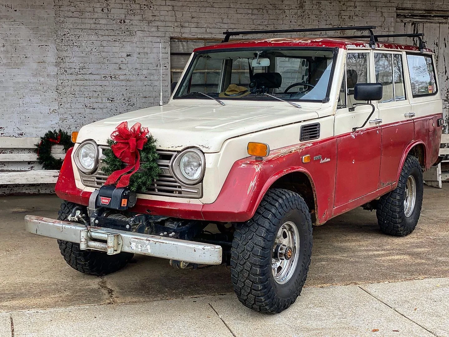

A pic from Christmas and one from this past weekend at a local car show. 60 axles set perfect in my opinion.
