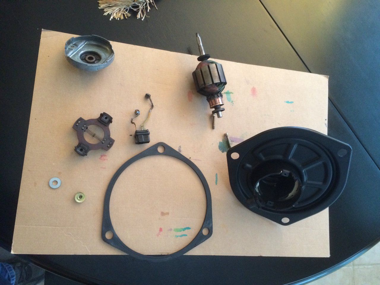

Got the blower motor re assembled this morning before heading to moms for the afternoon.
Mechanism attached. I used Sylglyde on all of the moving parts. Toyota calls for "body grease" but that's hard to find here. Sylglyde works just fine and CDan loves this stuff.
Here's the top half assembled:
Bottom plate went on with a bit of felt for cushion and sound dampening:
I painted the plate for protection:
Motor/fan/tube attached:

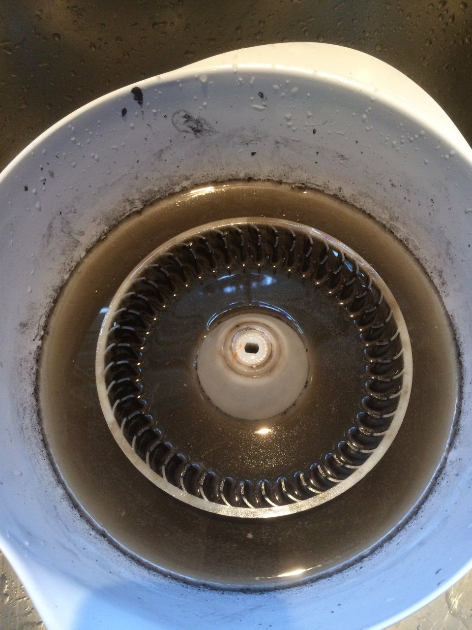

Surprisingly, I had vey few leaves and pine needles. The blades had a nice layer of filth. Motor dust was everywhere. I need to do the brush swap for sure.
