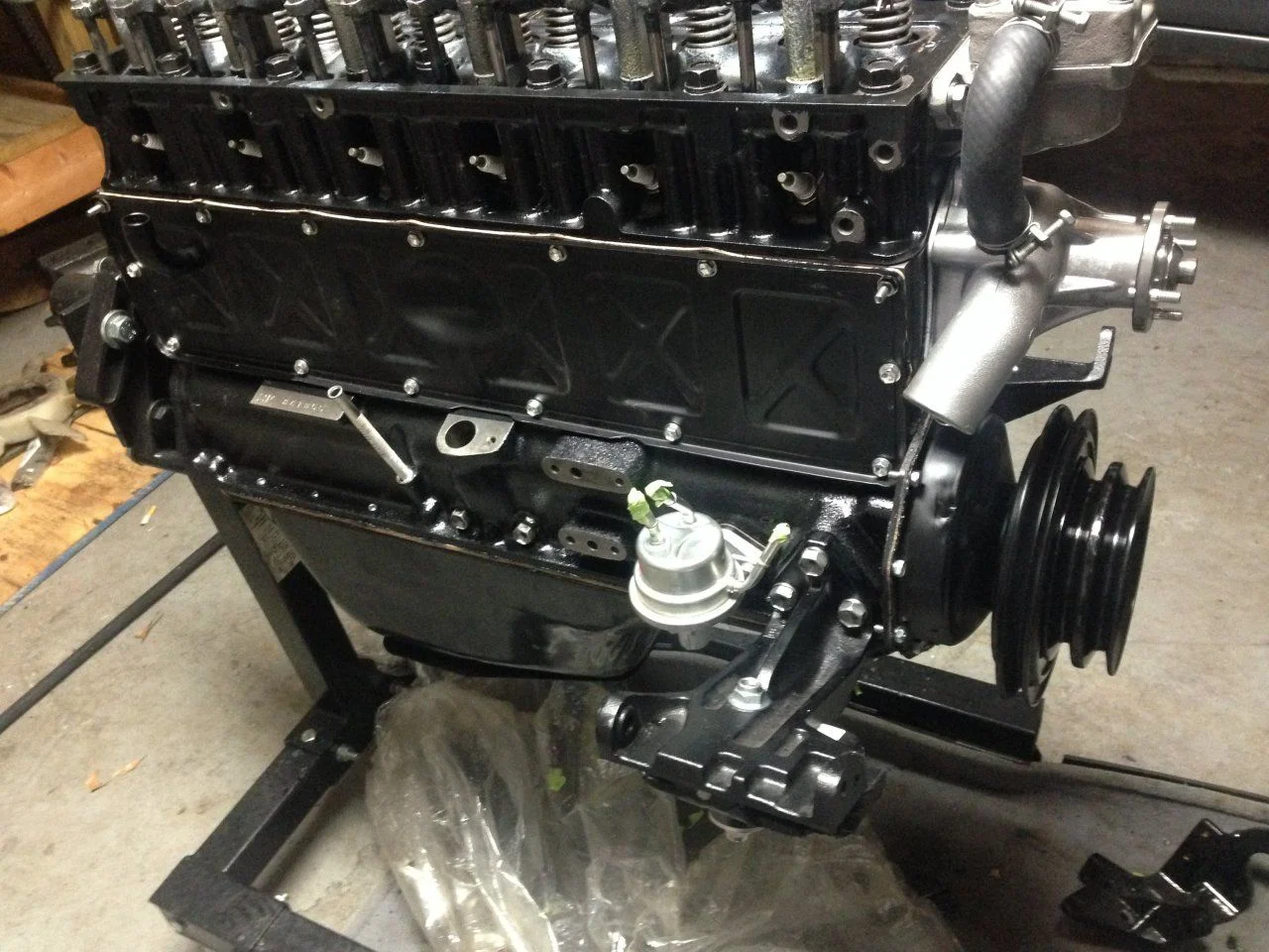

Next up, let's start making this look more like an operational engine. :lol:
New bypass hose and clamps:
Installed on water pump to thermo housing:

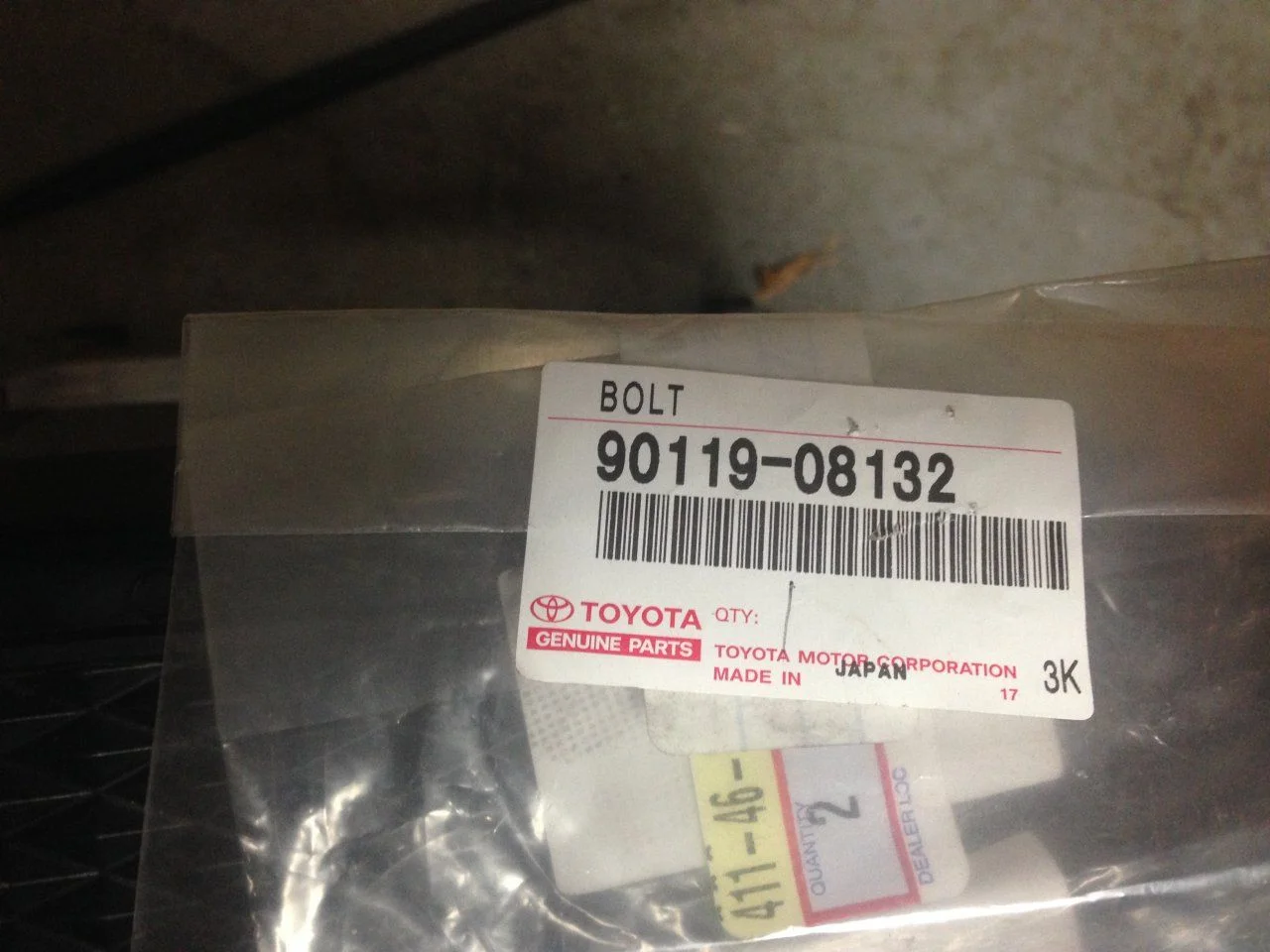

Also got the side cover and new gasket into place. FIPG mated to side cover first then side cover to block with new bolts. The two corner studs are discontinued from Toyota. So, the ones on there were cleaned up, a bit of blue locktite and installed into the corners. Then the new hardware-- 13 bolts.

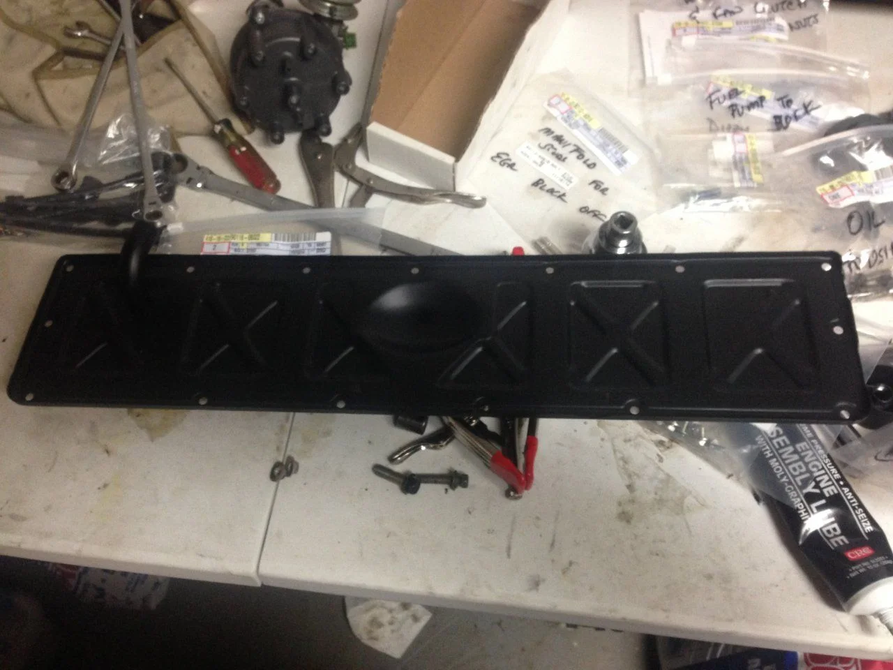

Powder coated side cover:

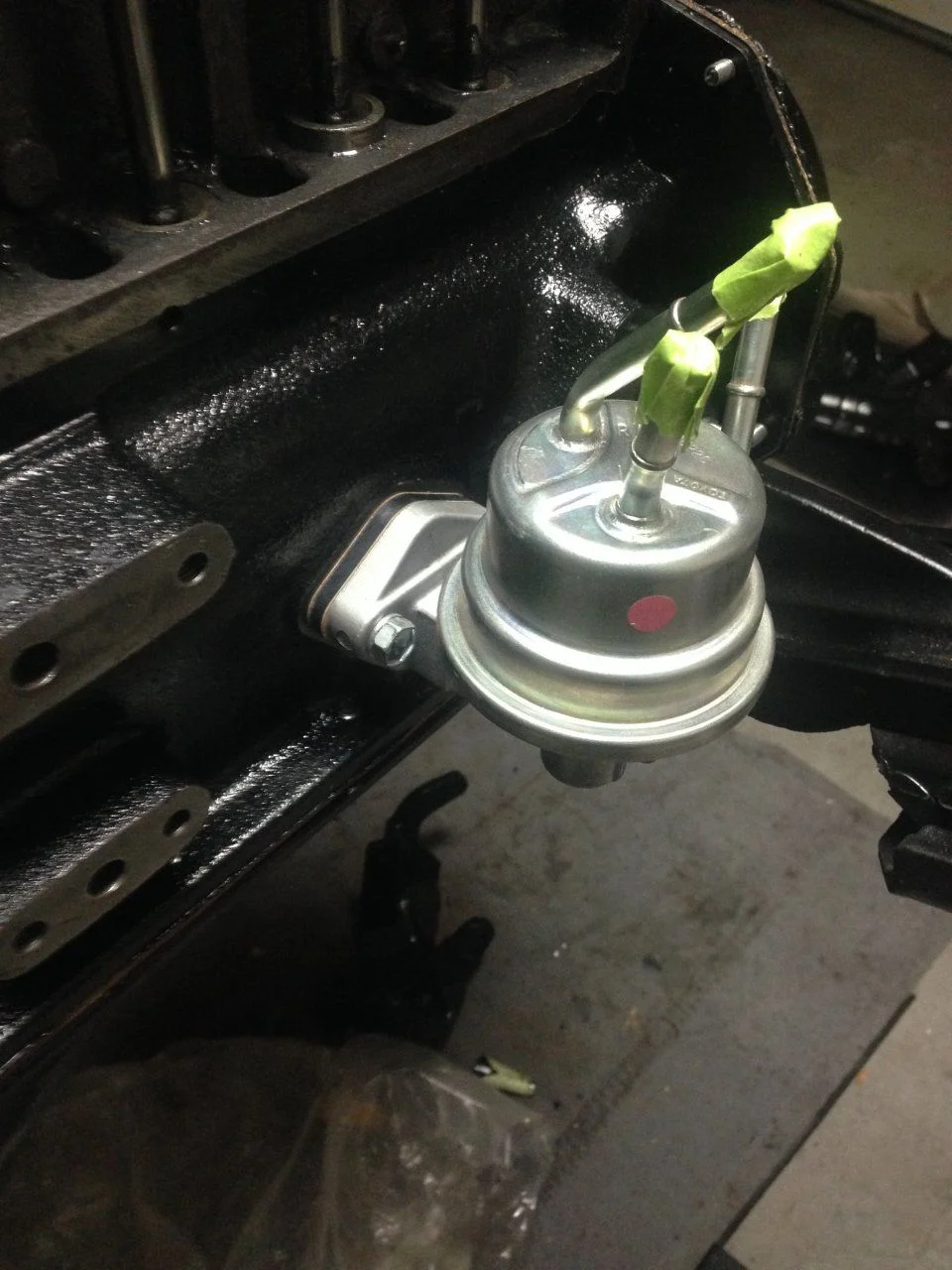

New OEM Kyosan fuel pump and insulator w/gaskets. Insulator is not optional using the OEM pump. It is absolutely necessary to space the pump correctly so that the camshaft can engage with the fuel pump arm:

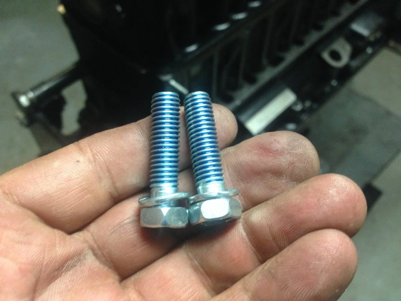

New hardware for the fuel pump to block interface. These come already pre-coated with a blue locktite it seems-- nicely right in the valleys of the threads.
Installed on block:

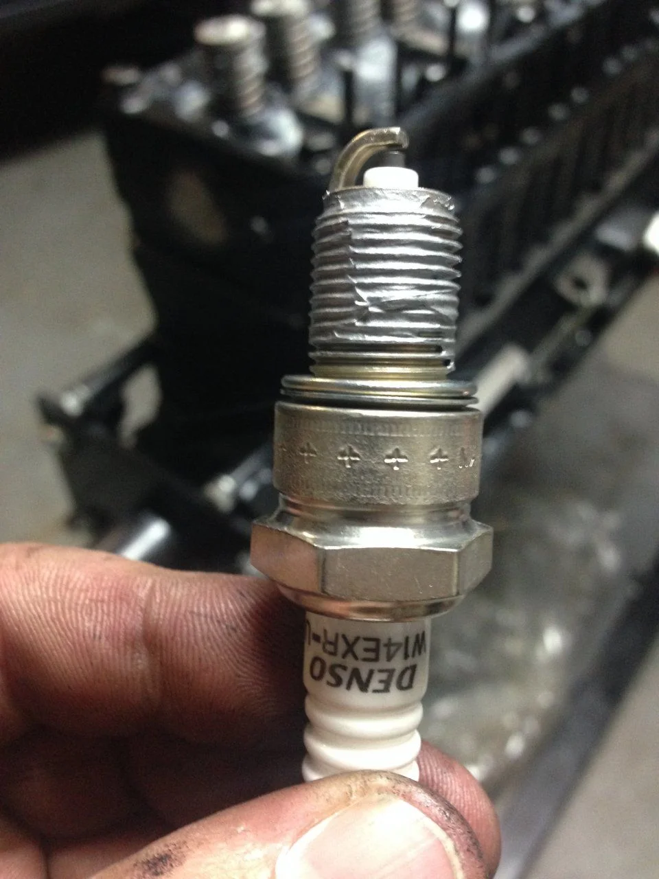

For my man Dynosaur: :) Don't forget anti-seize!

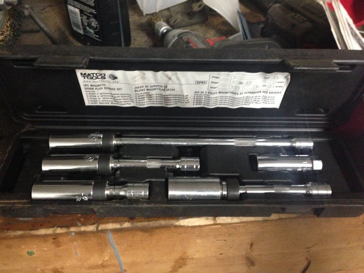

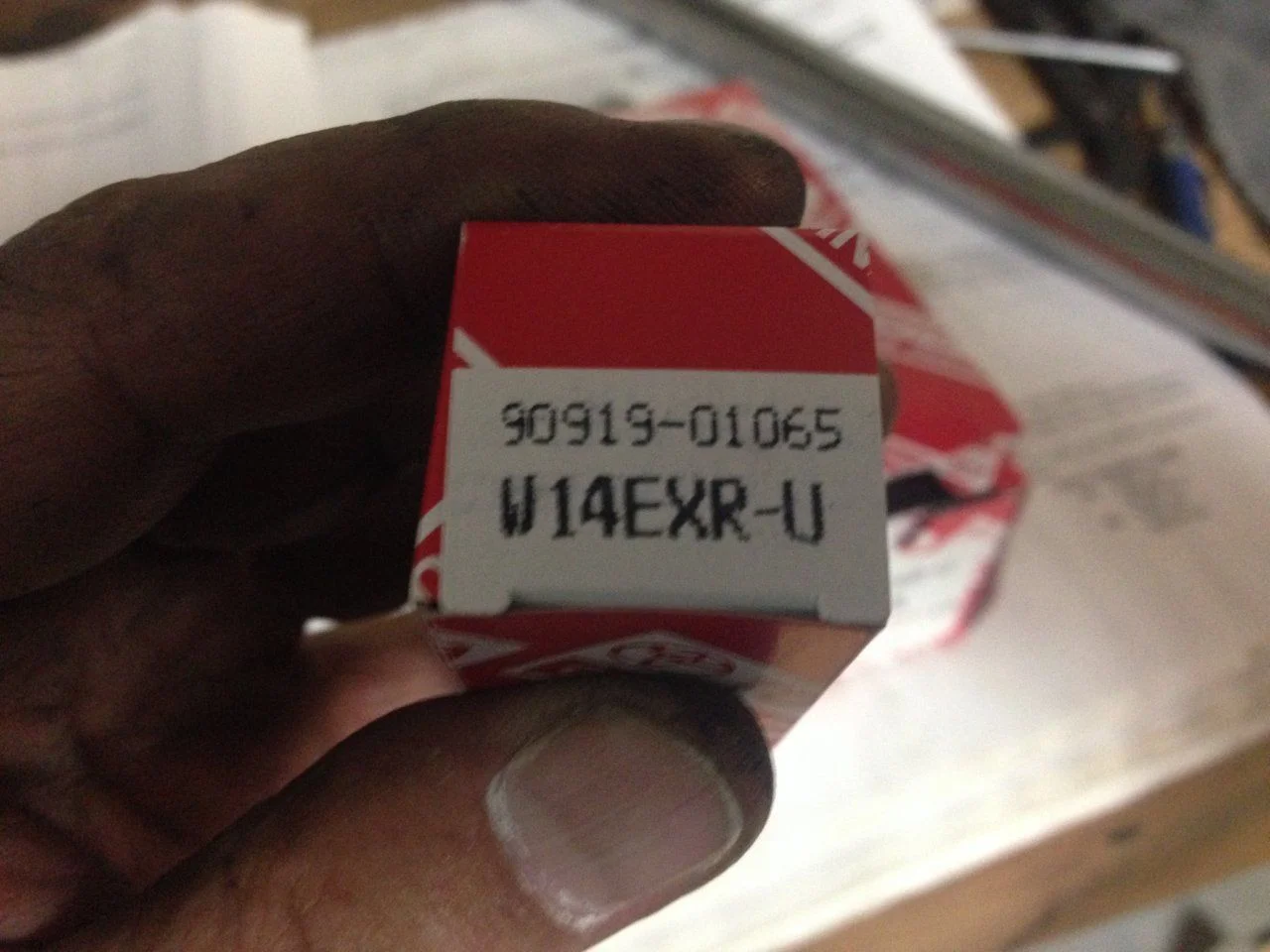

Highly recommend a spark plug tool set for folks-- not the cheapest investment, but I have come to realize that having the correct tools is tantamount to doing good, quality work. :) This is a Matco set and it has proven very useful over the years.

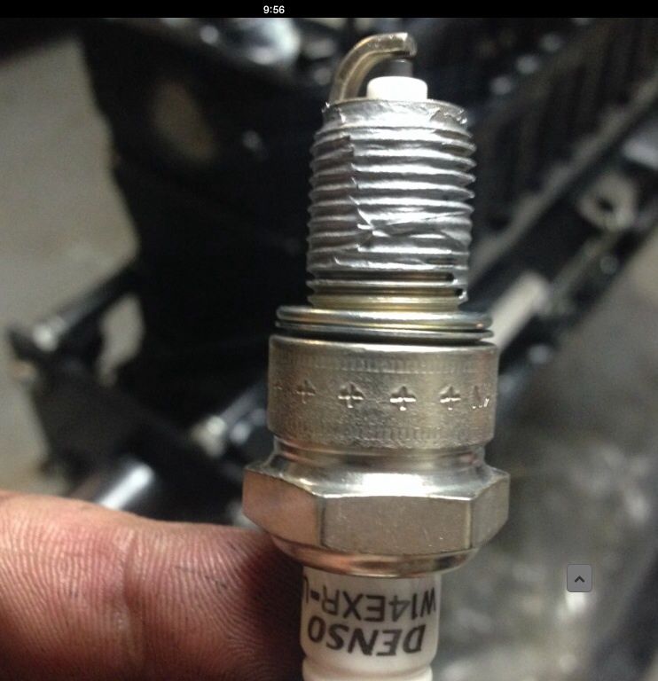

So that's what a spark plug looks like! :)
^^^ If it was a diesel it could be a glow plug,LOL. I'm drooling over that engine Beno can't wait to see that thing fire up and purrrrr.

View attachment 999005 So that's what a spark plug looks like! :)
