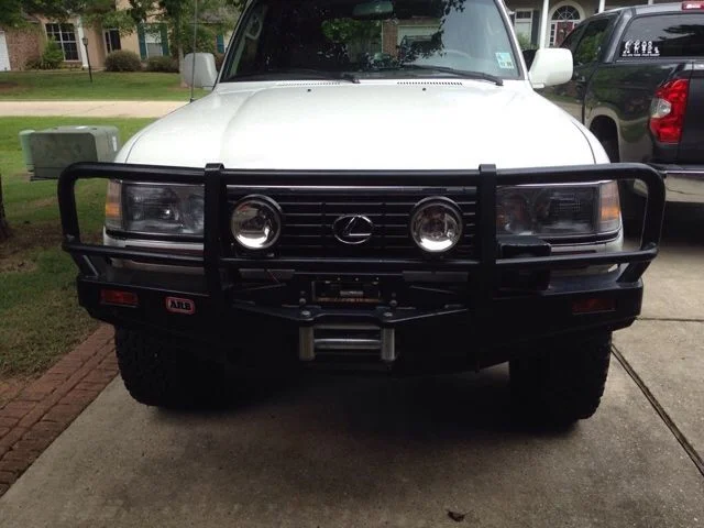

Installed aluminum ARB rack over the weekend
...via IH8MUD app
