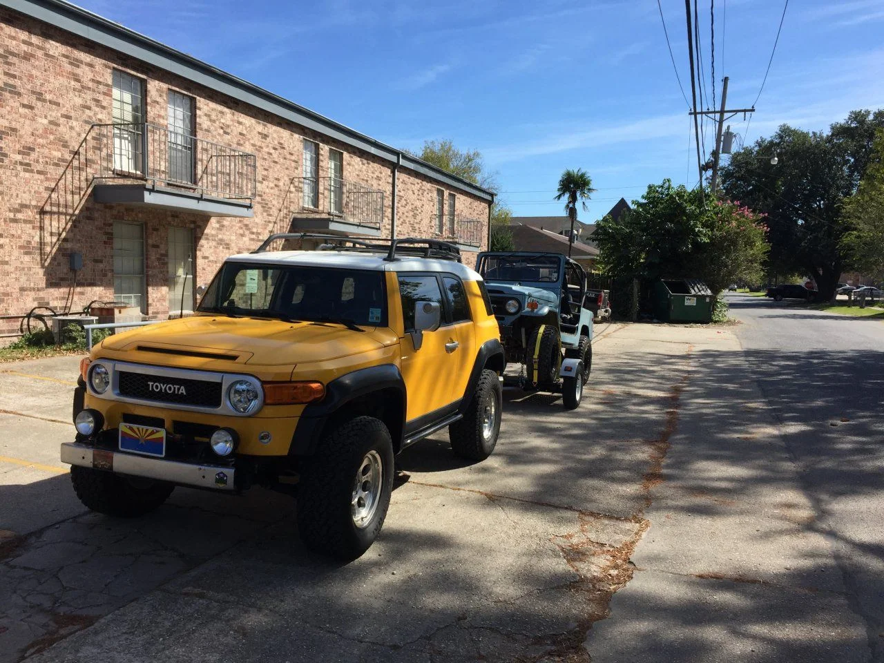

I also dragged Phoenix (my new and Mike J's old 40) to LSU for a test tow; it towed really well on the dolly behind the FJC... at 60 mph.

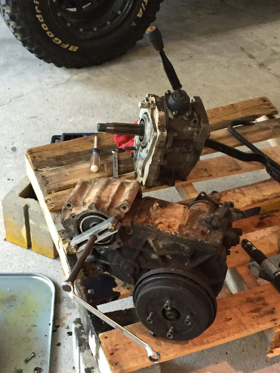

The AA twin stick is here and I am debating whether to install it now or wait for the Orion, which could be a while based on my other ongoing projects :rolleyes:. I don't think the mode rod is a big deal but getting to the selector on top of the t-case could be tough. Does anybody know if it can even be done without dismantling the interior and pulling the floor panel? :confused:
Tim, you will have to pull the seats, tranny tunnel cover and gas tank to get to the top of the t-case. Probably not worth the effort if you will be doing it again for the Orion install. I very rarely use the 2WD Low option which is what the twin sticks gives you.
