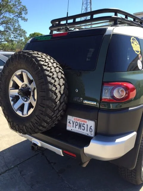

Well my post maybe premature but order Trail Grappler 295/70R17 today. I read that the BMC might need to be done, but will see once they are on. Alignment will be a must. I know spacers will guaranteed the BMC. I will keep you all updated.
Got the spare mounted today. Found out I'm free Saturday. So hopefully I can find out how deep I'm in with the new tires that might be in next week.

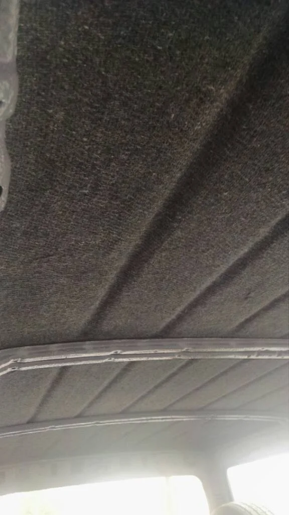

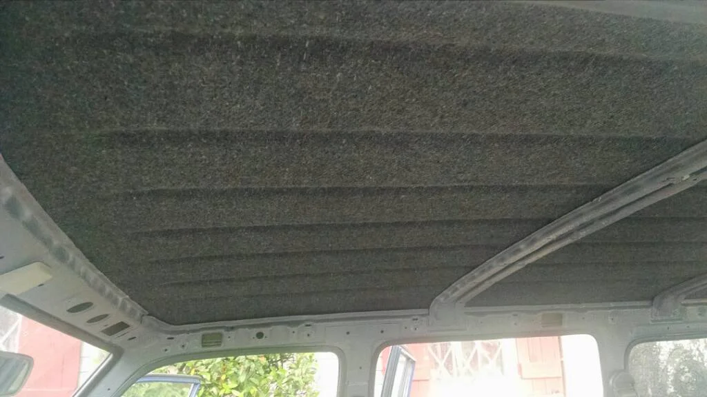

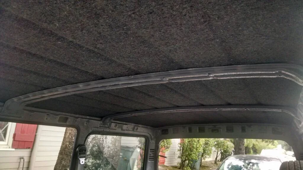

Got the "headliner" all finished up this weekend. I'm not happy with the back part of it so I may rip it out and try again. For the front two sections I put it up from side to side, but on the back section I went front to back and it was a lot harder to smooth out the wrinkles. Even though I glued up just the felt with no rubberized backing, it rides way more quiet now. I think I got rid of a few rattles and vibrations when I stuffed it into the cracks in between the roof and the braces.
Overall, this was an easy project and I think it came out looking good.

So, you're leaving it like that or are you using that as sound deadener and putting an actual headliner back in? Either way it looks good.
That's all I'm doing for a headliner. I do plan on building a rail, for lack of a better term, that will run all the way around the top of the pillars to cover up all the holes and stuff though. I'll make a cardboard template, cut it out of MDF and cover it with foam and gray vinyl or just more of the felt. Similar to the pic I posted a page or two back, basically.
