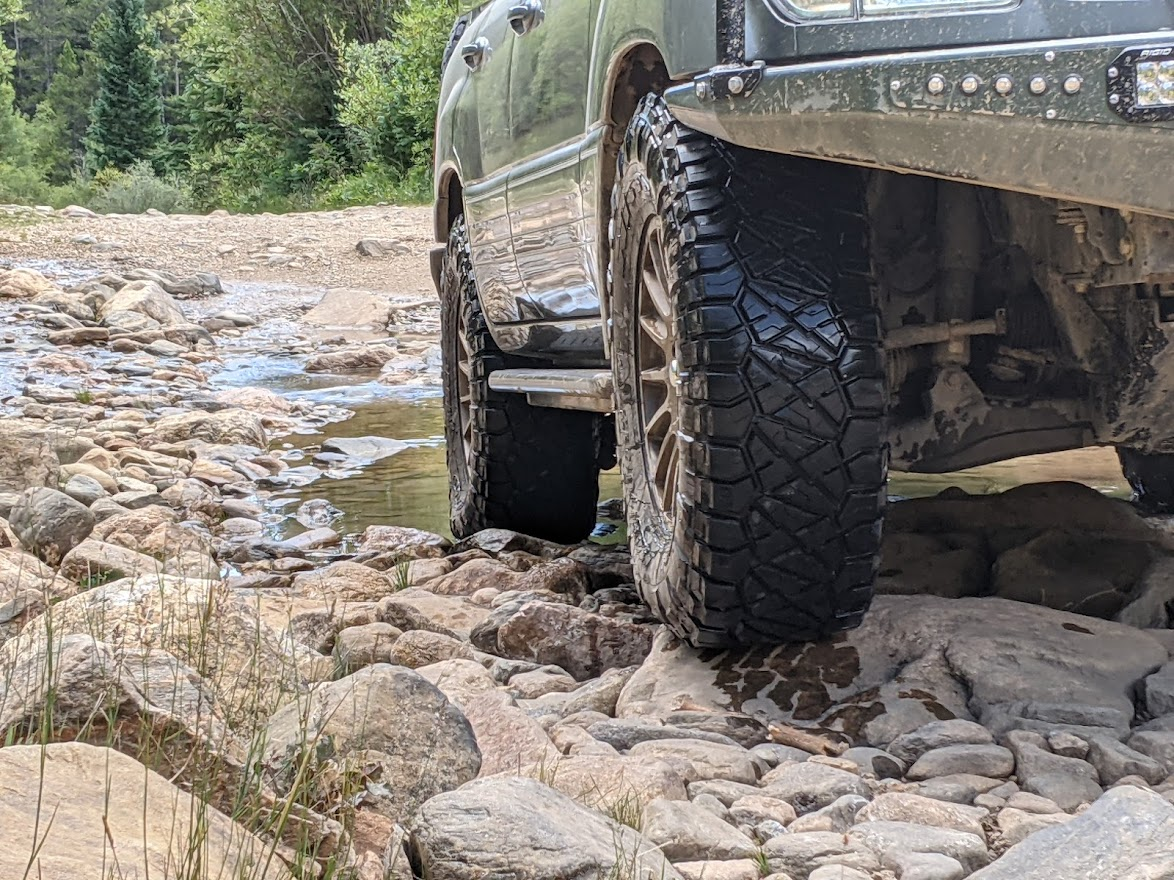

Got some trail time finally. LOVE the wheels/tires. Still ZERO rub. I think it's safe to say they fit with no mods at all.
This was at ~15psi cold, 18 psi hot. Very compliant, but seems the tires could take even less with ease.
Braid Winrace S 17x8 ET40. Ridge Grappler Tires 295/70/17.

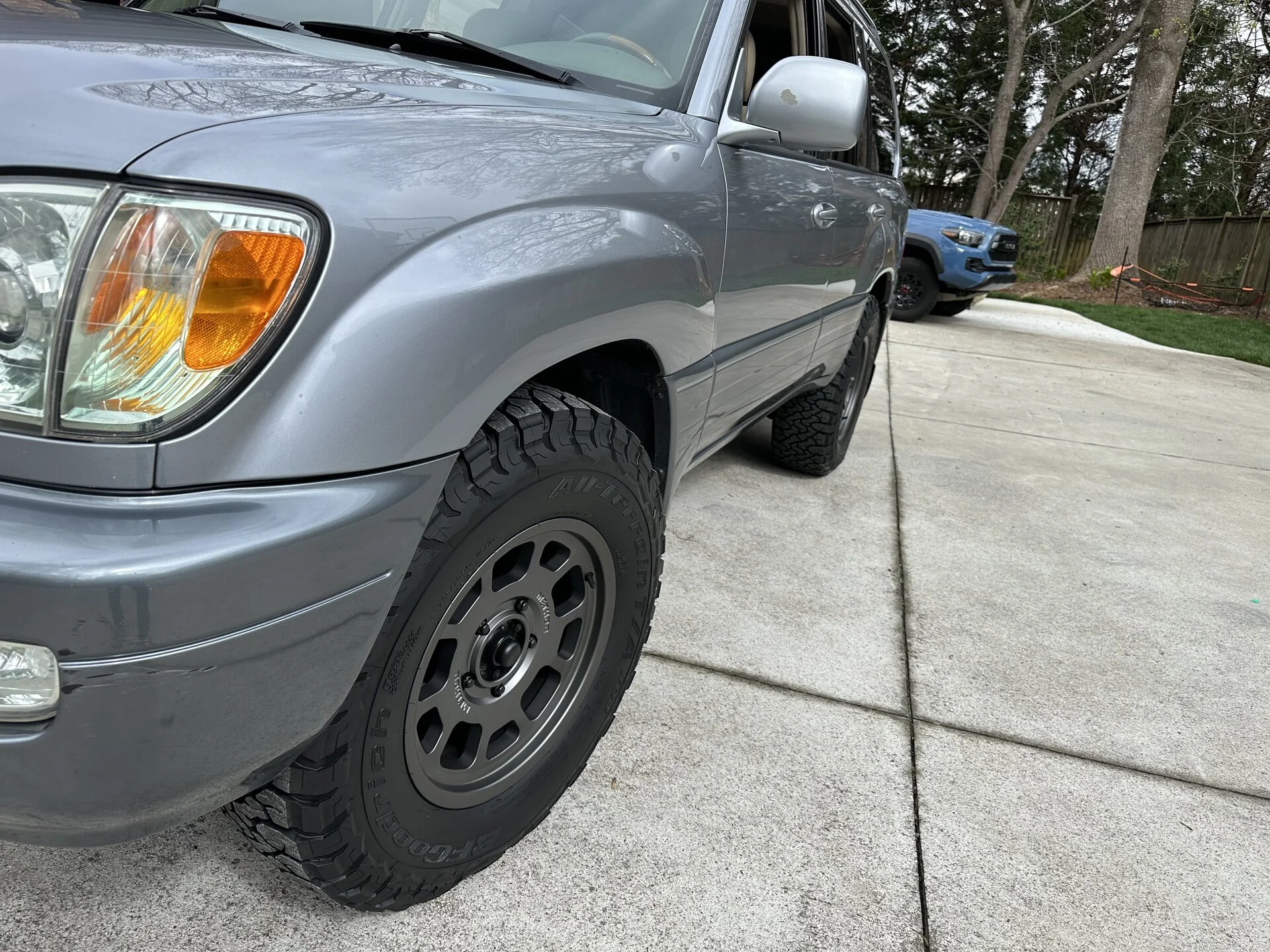

Hi all,

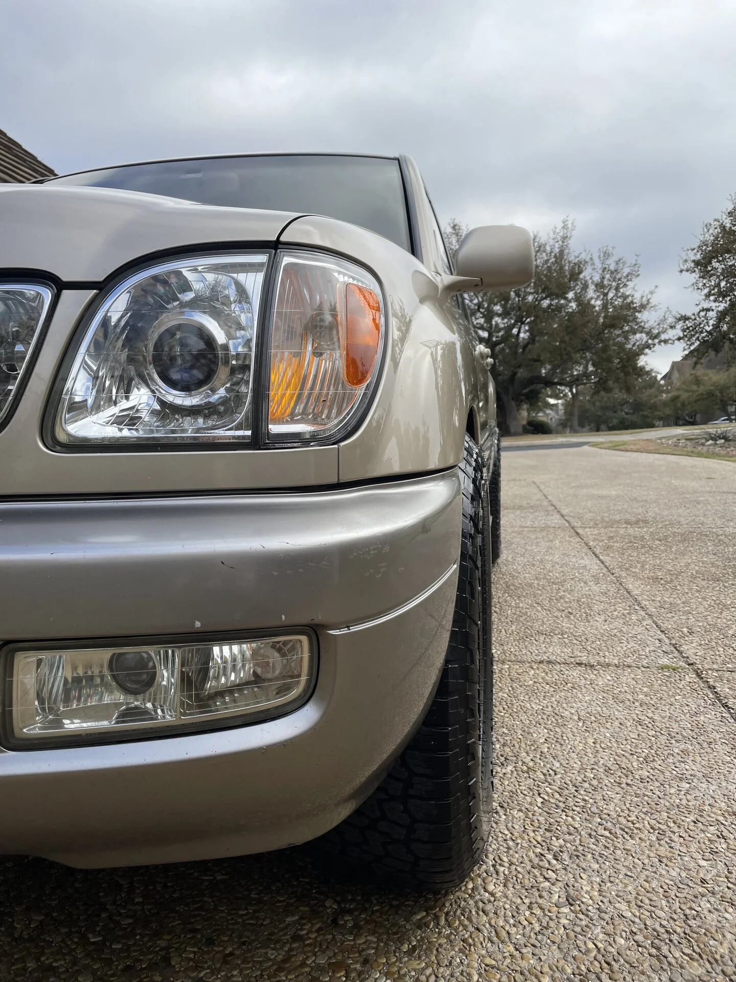

It’s been a while but I finally got my wheels on my 2006 Lexus LX470. I was going for Method 703 with a +35 offset. Was on back order for the last 6 months with no end in sight. Good deal came along where a set of Method 312 came along at 400$ reduced price because boxes were damaged (not the wheels) so really good deal. Wheels are 17x8, 5 5x150, 110.5 with a 0 offset with BFG KOII 285/70/17 tires. No rubbing! The zero offset made me nervous but they fit well and look good! The only issue is that the front hub caps don’t fit on, as the hub protrudes out so the cap doesn’t fit. I called Method and they don’t make a hub cap spacer (I don’t want a wheel spacer only a hub cap spacer).
I tried to find hub cap spacers but could not find anything online. Anyone have a website that helps with hub cap spacers???? Need about 1/2 inch spacer for front end only. Thanks for your feedback and never forget there is somewhere out there not explored yet, go find it!

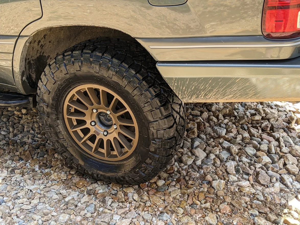

After many searches, finally pulled the trigger on Method 705 on my 1999 LX.
Unlike my 01 LC, I wanted to retain original suspension set up (AHC) and try to keep as stock as possible. So, was looking for little improvement /larger size tire. Came upon 705s on Craigslist and newish 285/65/18 Falkens on mud classified.
Here’s the details.
- Suspension: stock AHC.
- Method 705s: 18x9 and 25 offset
- Tires: Falken Wildpeak AT3W 285/65/18
- No spacers needed.
The fit is great. No rubbing of anything on normal height setting. The treads doesn’t poke out of wheel well. The tire itself pokes out a little.
The front center cap issue was resolved by using 3D printer file from @cryptyk to extend the cap about 1.25”. The 703 extensions will work on 705s.
