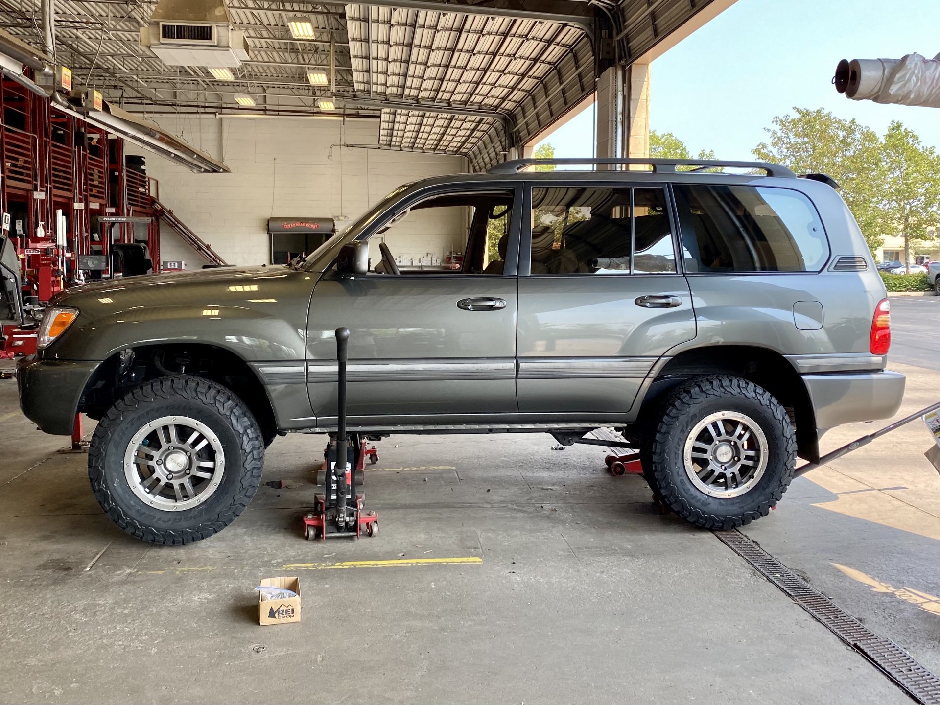

Finally got the Rock Warriors on. Thanks to Jimthom for the Spidertrax spacers and the random dude on Craigslist for the Rock Warrior/lug nuts for $500. Running BFG KO2’s 285 70 17 with 1” spacers and no lift.

Not sure what the offset or backspace is on the Rock Warriors, but they would not fit without spacers. I’m not a fan of spacers but if you stick with spidertrax or bora’s I think you will be fine.

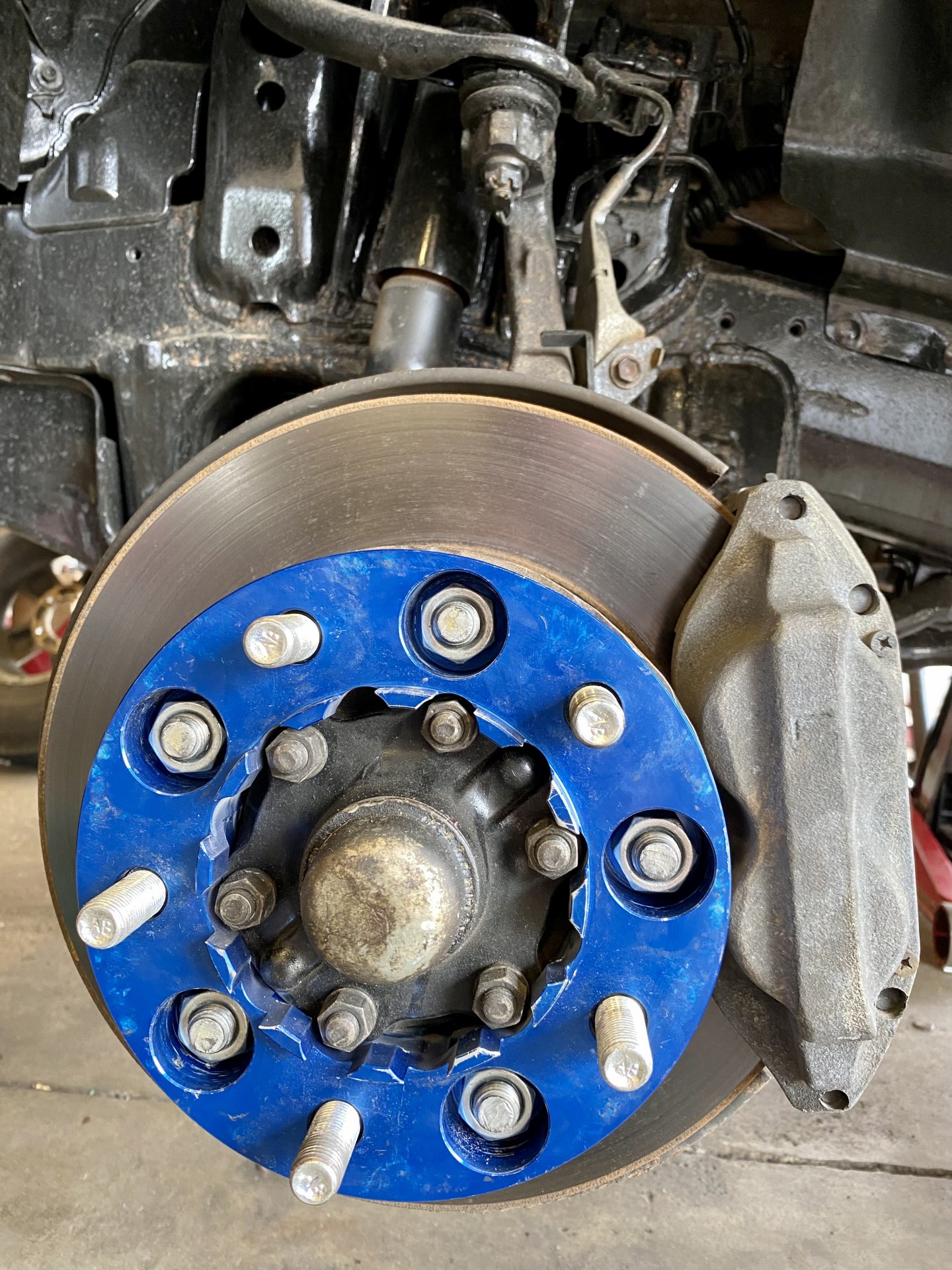

The 1.25" SpiderTrax (@sleeoffroad ) machined spacers allows for the bore of the RW wheels due to the taper being slightly narrower towards the outside and will not go all the way on the 💯 hub.

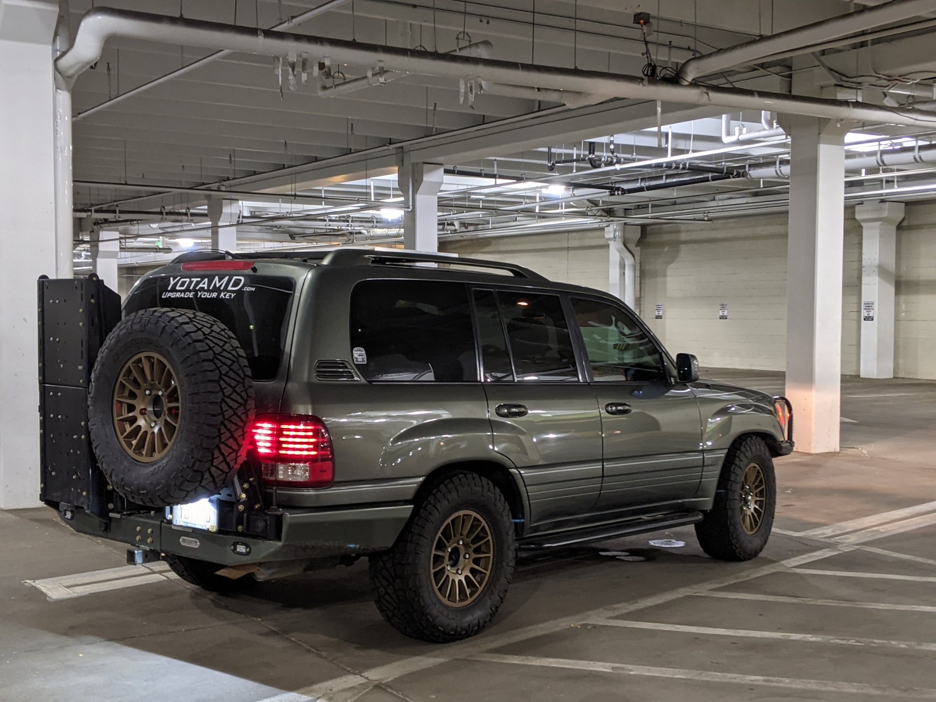

Those Braids look nice! I’ll look into those if the Methods don’t work. The Methods 703 have a 110.5 center bore and the hubs on my 2006 lx470 are 110.1 so hopefully there is no issue there. And I verified the wheels are lug centric and if so I shouldn’t have to worry about the slight difference in center bore sizes. I told the guy is the Methods delay beyond end Aug I’ll look at other options. Braids maybe? Thanks for the feedback all.

I was looking at the Evo Corse as well. After speaking with Paul @ Braid, I was sold. They're all about making great quality wheels that should last a lifetime.
Evo Corse are barely cheaper and I had a hard time determining that 100% a spacer was not needed for the 100. I think it's fine, but I recall having some hesitation. Braid was very clear that they would make it fit with no spacer. I like the Winrace S styling better as well. More sleek.
