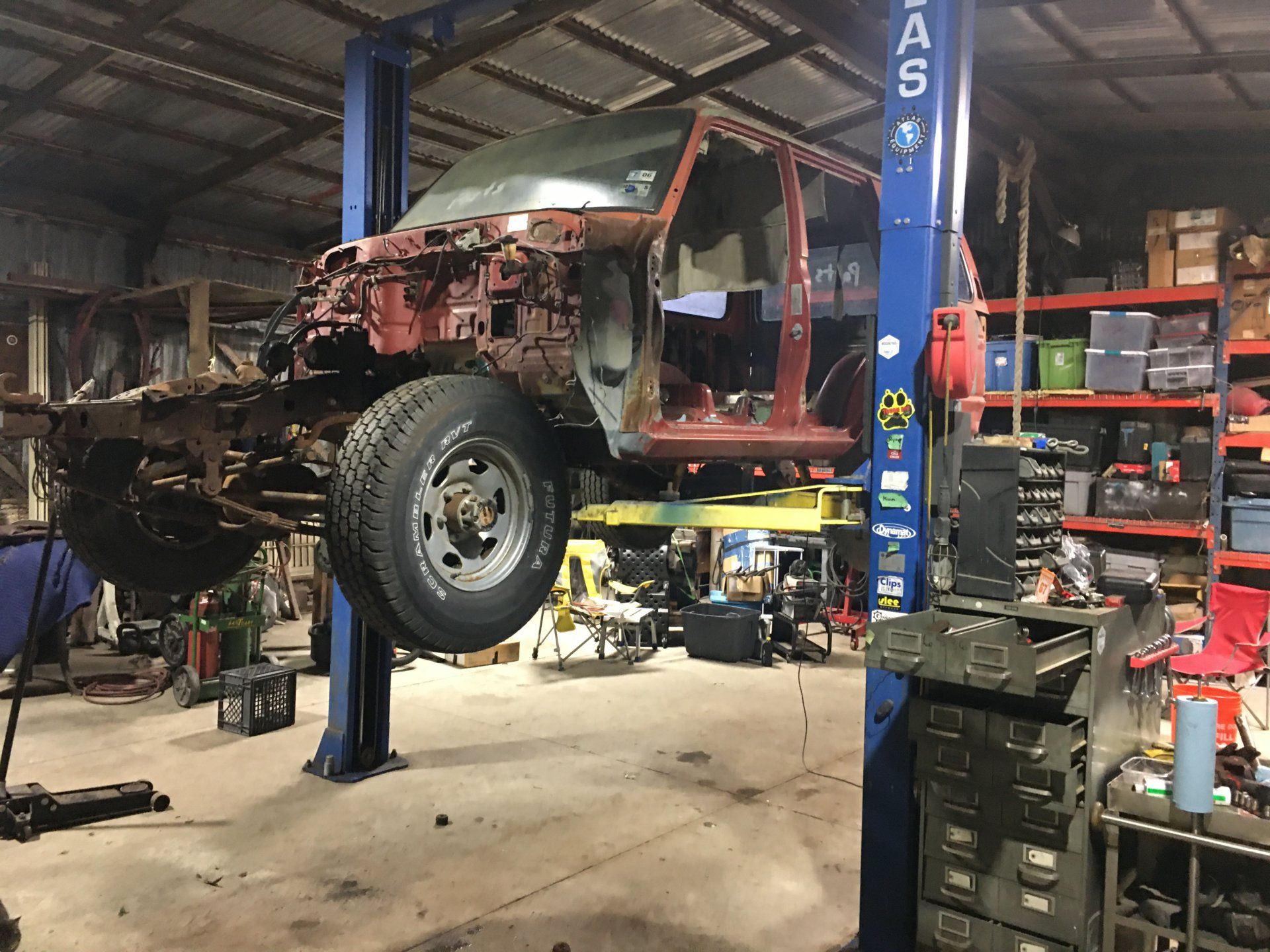

So I figured out why the pinion gear was sloppy and one u-joint was coming apart. The spring hats on the rear springs were so f-ed up the rear axle was sliding back and forth. This is the drivers (RHD) side hat and it was missing the rubber insulator. The other side is routed out even more. New yoke, rear diff and a set of OME springs (got rid of the jenky skywalker springs/shackles) and he should ride like a fine 2-stroke in the woods :).

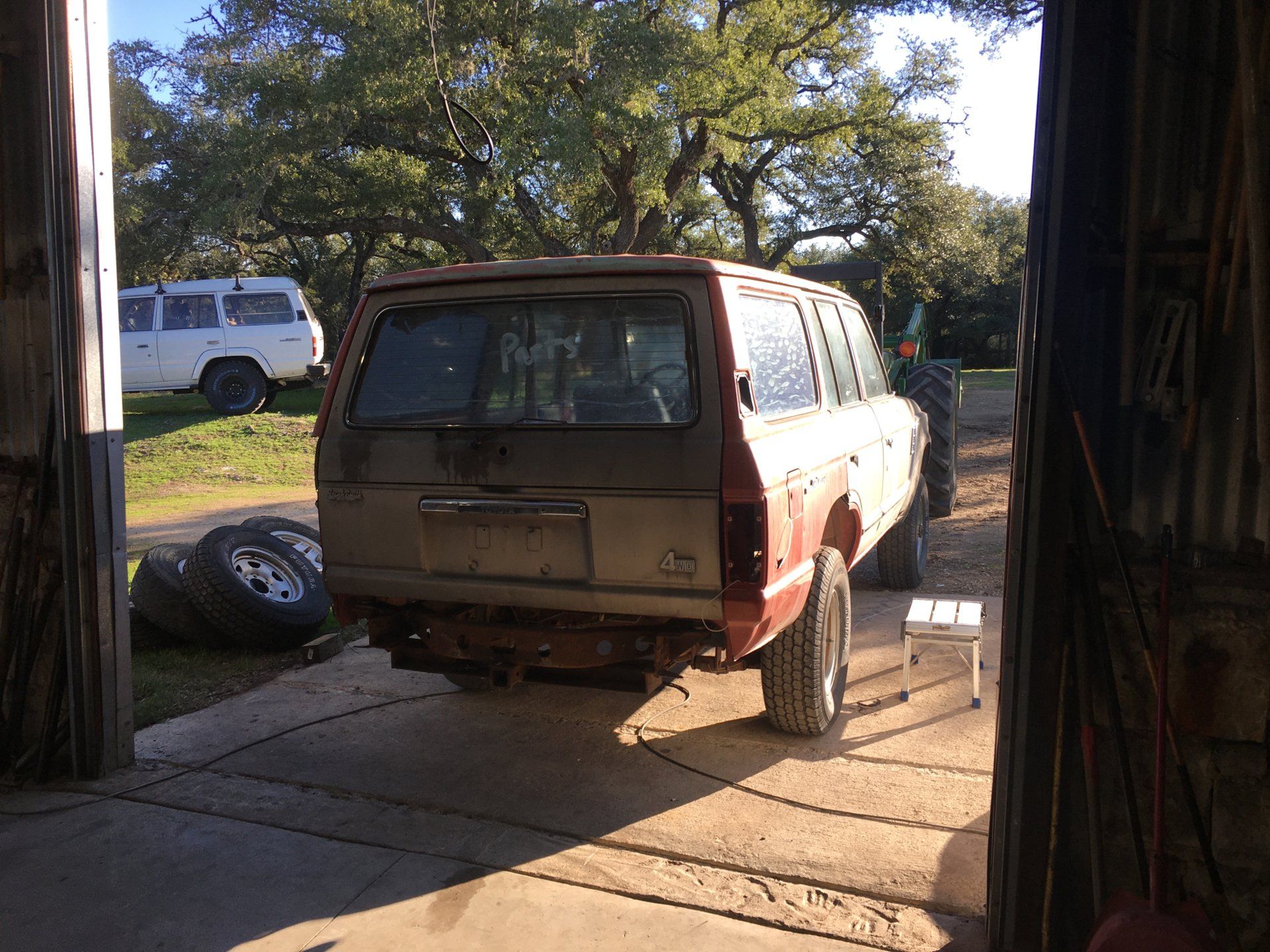

Spent the weekend at the barn helping Jimmy with a few projects. It was also his birthday, and a few of the guys came over for dinner and to talk Cruisers.
The main goal for the weekend was to get one of his 60's running so he could get it titled. This 86 had no engine and hadn't run in a while. We dropped the transmission and T Case (side note: I need a lift it, makes things so much easier).
After we bolted up a flywheel and clutch to the new 2F we realized we didn't have the clips that keep the pilot bearing assembly attached to the clutch fork. After searching through the boneyard and his myriad of totes and parts boxes with no luck we decided to fabricate some. They turned out pretty good and kept it in place.
The carb that was on the engine was damaged during transportation and leaked badly, so we changed it out with one Jimmy had in the stash. Unfortunately, we hadn't realized that he had previously robbed the choke plate for another carb. So we swapped one on from the old carb and did our best not to drop those tiny screws down the intake.
Then after diagnosing a bad fuel pump the hard way and adding to the wall of shame. We got her running like a champ.
Another fun and productive weekend. Thanks Jimmy!
Coop (@samc2447) was a godsend. He’s being modest in his above description of what we did this weekend. I could not have accomplished a fraction of what we did if I was working alone. This is a fairly nice 86 model that’s not been on the road since 2006. Got it pretty cheap a few years back less a title and motor. My goal is to have as many running/mobile trucks as possible and any remaining ones rollers that steer and have a parking break at a minimum. Plugging A motor that’s been sitting in the corner of the barn into this truck pitched multiple curve balls. The great thing is we overcame every obstacle. The best one was figuring out none of the many Toyota keys inside the truck did not work with this truck. Coop and the guys were brainstorming and came up with the idea to pull an ignition harness off another steering column, plug it in and use a screwdriver to start the truck (the plastic part at the back of the ignition tumbler).

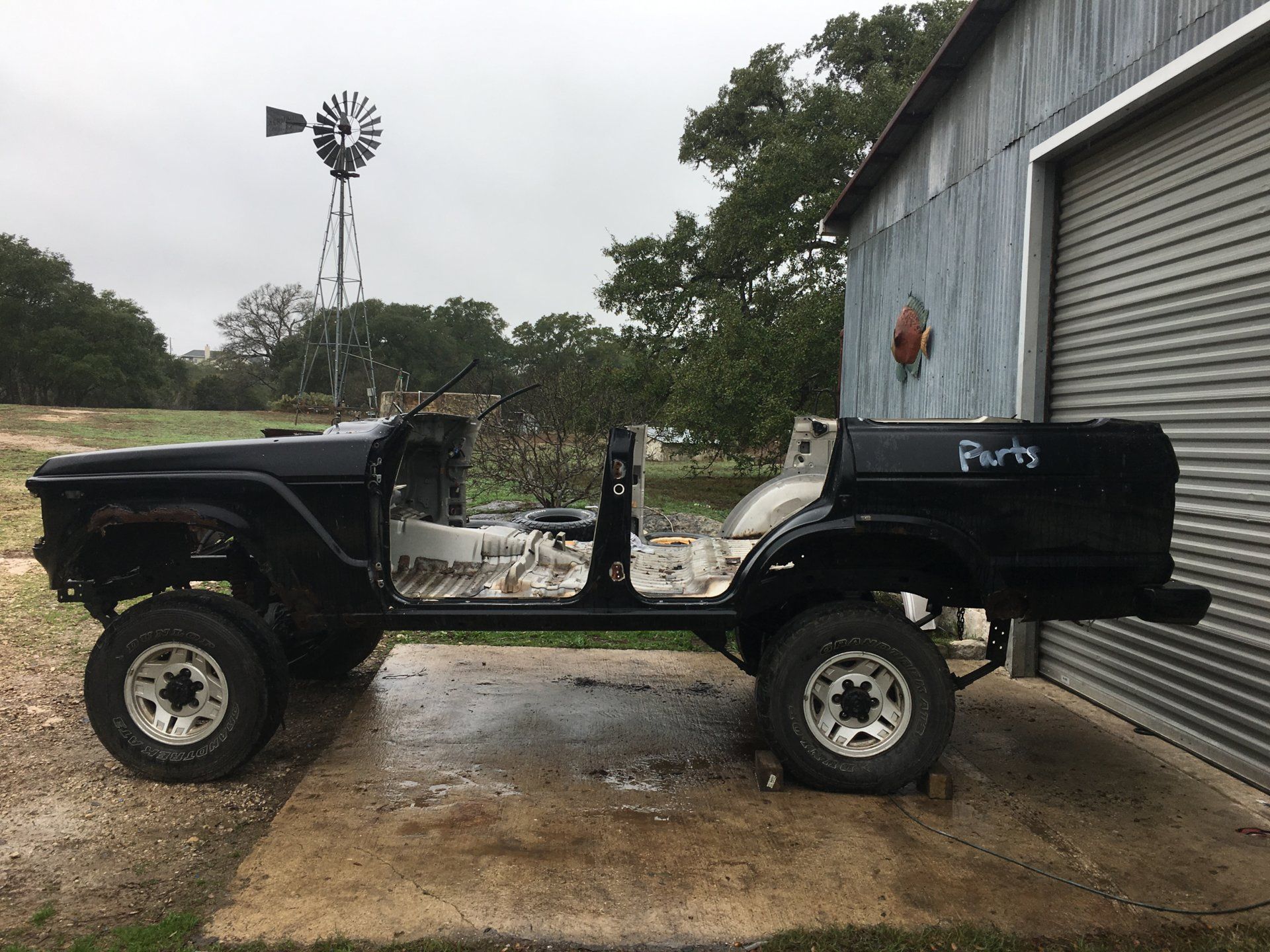

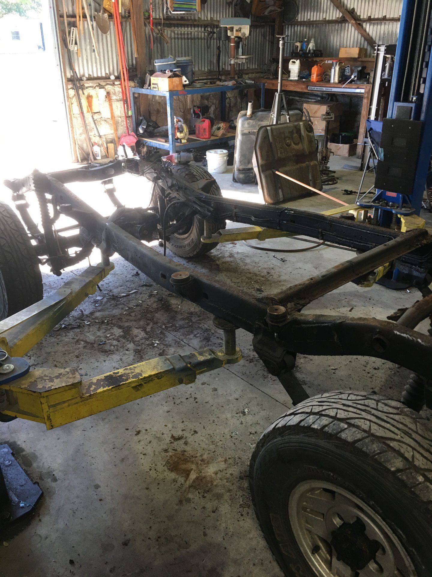

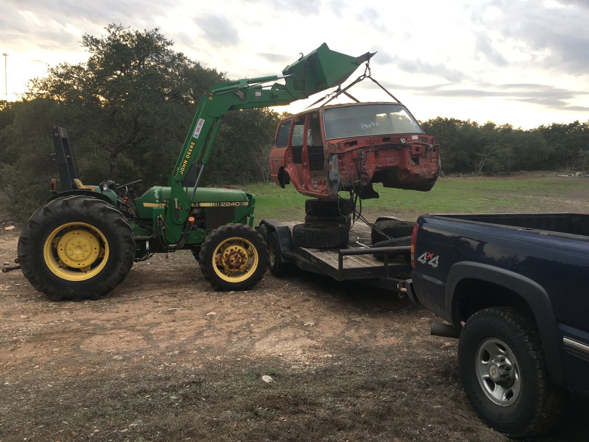

So a few of you know this barn is coming to an end. We are putting the house on the market and heading to Ft Collins. Before I can list it I have to get right with the HOA rules. Apparently you can’t have any non-running vehicles parked outside. So any cruisers that fit this definition have been buried in the woods and out of sight. Apparently that won’t fly with the realtors :(. So I’ve been getting them ready to move to my neighbors ranch. First I have to cut up the ones not worth me taking to CO. And I had to get a few Vin inspected for bonded titles. Been meaning to do this for years. Since I know the TX laws decided to do it now. Thanks to Coop @samc2447 we got a motor in the above 86 and it even runs and stops on its own. Then I had an 83 tub sitting on tires so I decided to mate it to a rolling chassis I had by the shop. Takes care of two trans issues. Actually doing seam sealer on the roof in a few min to preserve it.
This has taken up the last two days of my time (plus fighting the flu. Decided to put a front clip on (bought from John @4Cruisers) to-assist with moving/storing the panels. Finally I’ll load the cab to the roof with parts and let the rolling/stopping (I hooked up the parking brake) cruiser be a mobile storage unit. Will do this with all the cruisers to reduce the amount of crap I have to move when the house sells.
Prior to this red 83 had to cut up a rolling HJ61 that was a donor (rusted out) for a 55 conversion I did for a friend. Also had to cut up a junked 80 that was left over after another MUD member did a drivetrain, wire harness, panels and interior swap. Have 2 possibly 3 more to cut up along with one more 60 to get doors on, steer/stop and put in glass. Nothin like a little activity around the barn. I’ll sure miss it but hope to have another one on CO within the next few years.
That pile of rust on the floor was all that was left of the 61 once done.
