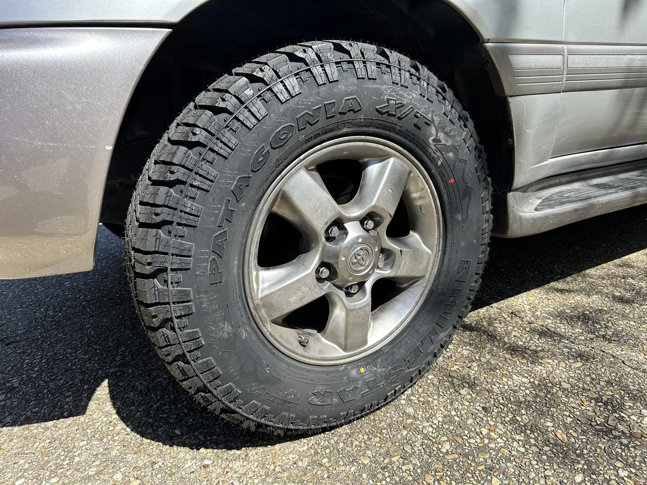

Installed the Milestar Patagonia X/T 275/70/18 today and I have 1" BORA spacers as well. The manufacturer specs it at 33.4" and it fills out the wheel wells about as perfect as I could have wanted. I have AHC and it's tuned maybe an inch higher than stock, if that.

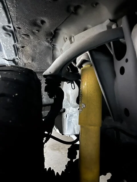

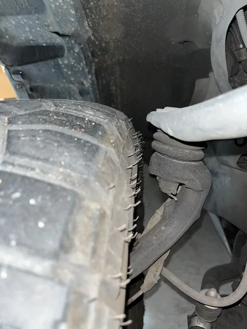

Just wanted to get one final confirmation before I switch from Nitto Ridge Grabbler 285/70R18 to Falken Wildpeak AT4W 285/75R/16 (16" wheel is OEM from 2002 LC). Looked up overall tire diameter with this set up it is about a 6.2mm increase. I have1.5" lift with front Dobinson 783 shocks. I don't expect to use any spacers, just straight swap. Photos attached of the current 18" tires on, looks close to the upper control arm. From previous reads and asking around there should be no rub, but I wanted to check with the group one more time so I don't get last minute issues before getting them today.

You’re good. I’ve ran 285/75r16 for 7 years on stock wheels and for most of that time on stock suspension. No rubbing. I’m running the exact tire and wheels you mentioned on a very slight lift (OME 2865’s with a slight torsion bar crank) without issues.

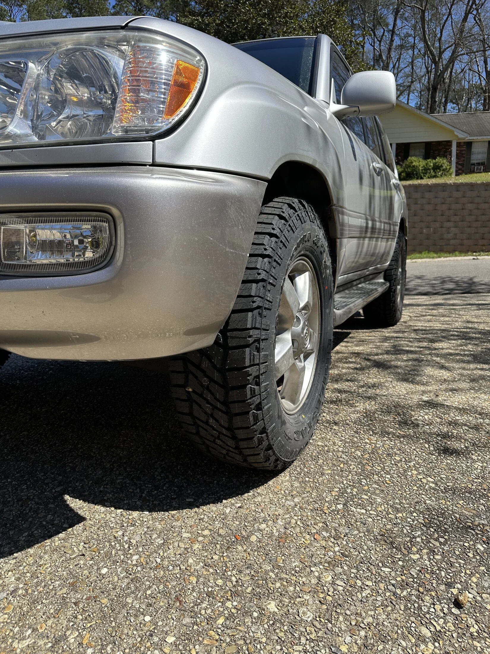

From a couple years back, but if anyone still wants to see a 100% stock (no lift) tire size upgrade to a 285. 2001 Land Cruiser
Only issue was a small interference on the lower spash guard at the outside edge. A gently heatgun application softened the plastic enough to flatten in out slightly and that's all that was required. Full lock-to-lock steering with no rubbing.
