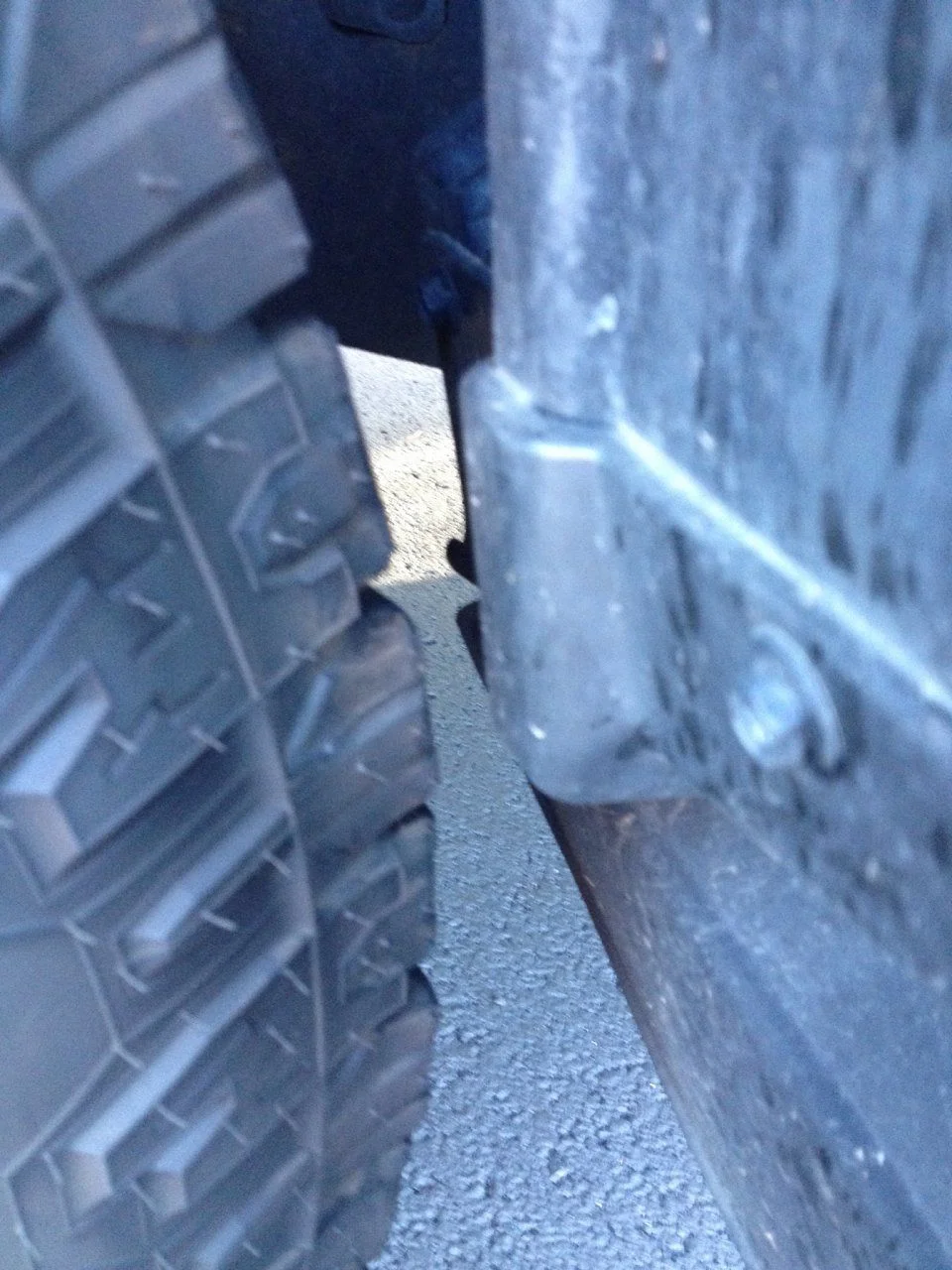

2000 TLC
No lift
Brand new BFG All Terrain tires 285/75/16
It's a little tight in the back. Measured distance from the tire to the plastic wheel well piece is 3/4"

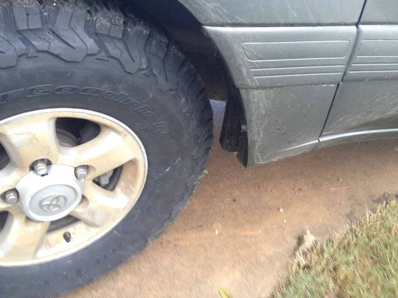

Discount also said I'd have to remove front mud flaps to fit 295 Toyos. I said, no they will fit stock un-lifted. 295s are the ticket for non spacer and unlifted.
Stock front mud flap clearance on 295s.
