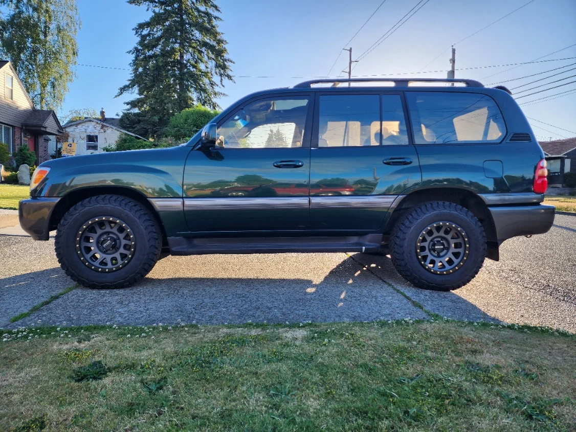

Ended up going with 265/70 17 on the Methods. Have a slight rub on the front wheels at the pinch weld plastics area. I'll either cut or remold the plastic, do the pinch weld mod or raise the front end slightly with the torsion bars. Now to chase down the vibration that has been there since I bought it a couple weeks ago.

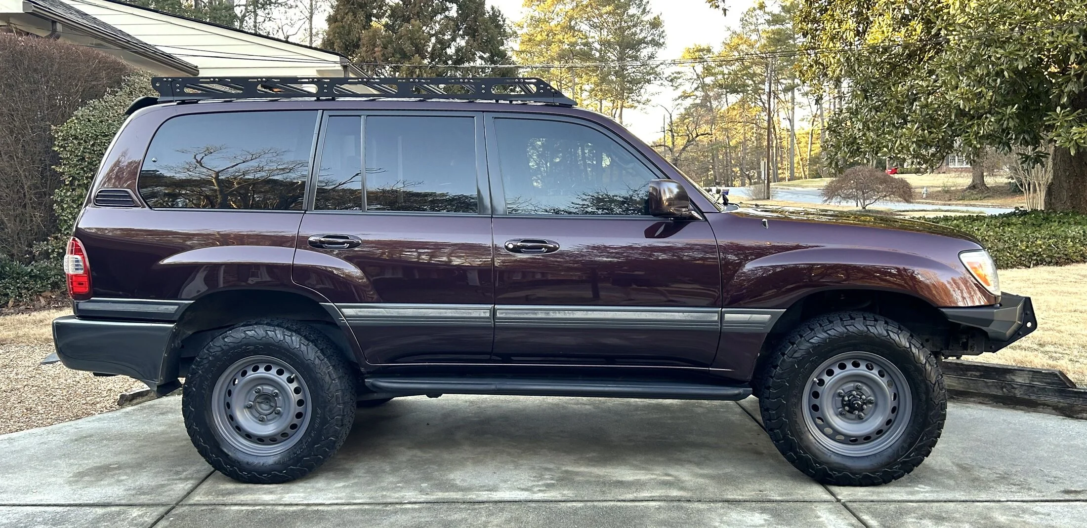

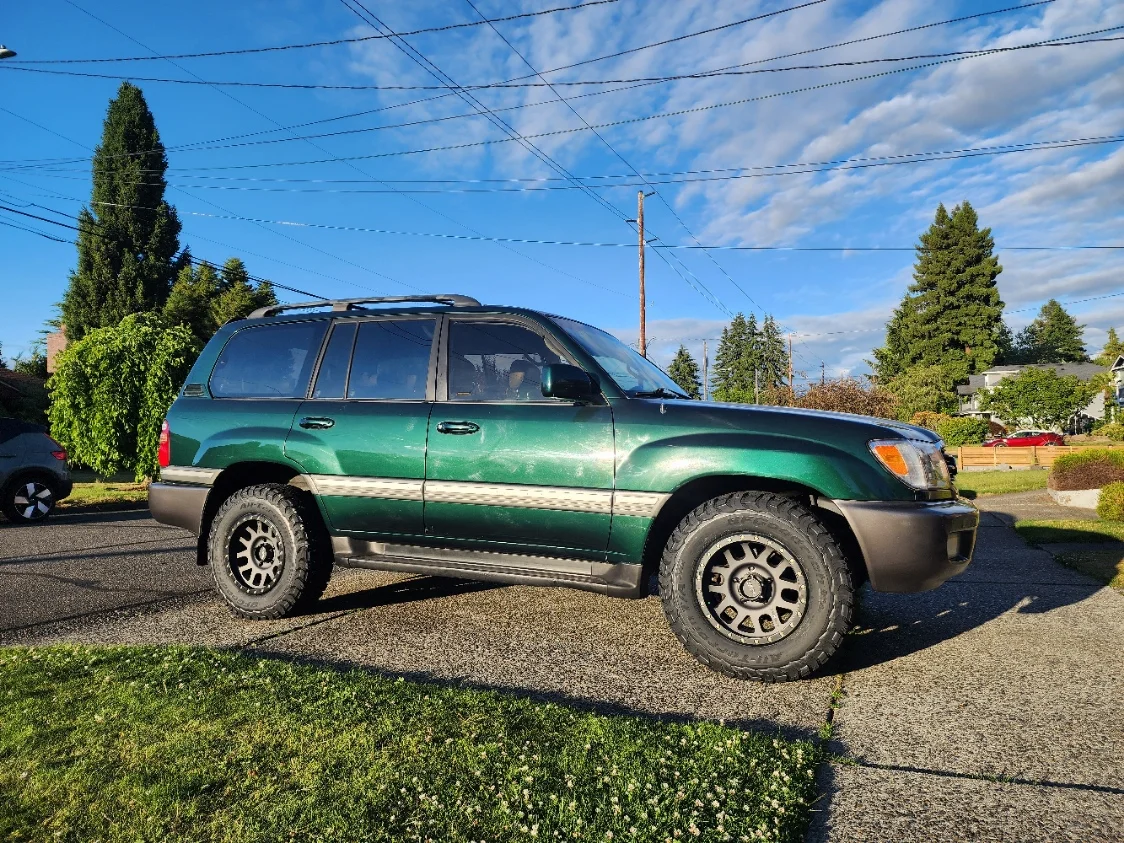

Pic because posts are better with pics. There was a time 33s looked big. Now, they look stock.
