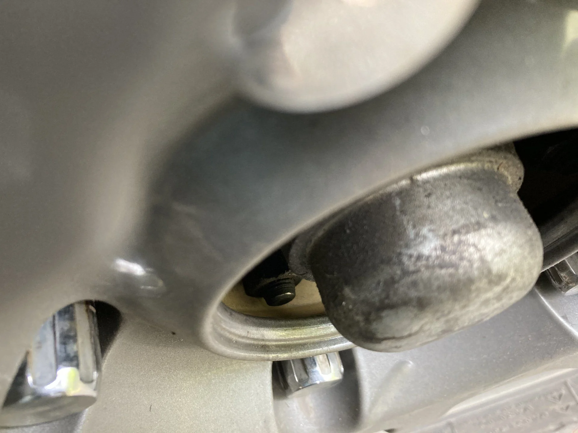

I had 295 70 R18 and it absolutely needed the pinch weld flattened, and 1" spacers. And it still hit the washer bottle
1.25" is the most popular spacer size so that's usually what gets used. I've read here that you need at least 1" if you want to use the flat caps. I don't know of anyone using 3/4" on RW's.
I use 3/4" on RWs, from what I remember all that's needed is about 1/4" - 3/8" to clear the center caps.
I have used 1/4” and 3/8” on RW’s, neither are enough for the flat cap to clear.

Flat center caps do not fit with 1/4” or 3/8” spacer. Dome center caps do.
I think you’re missing the point here.
Ah, we're talking about two different things (axle dust caps vs wheel covers), my bad.

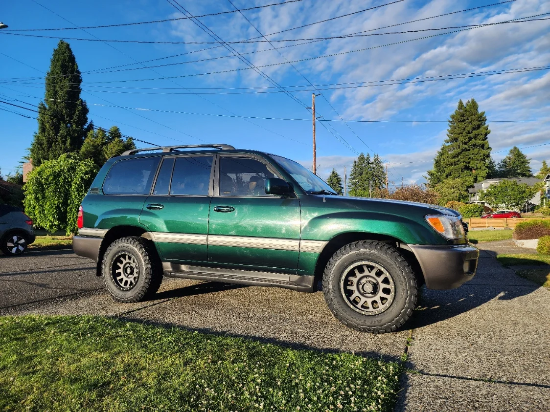

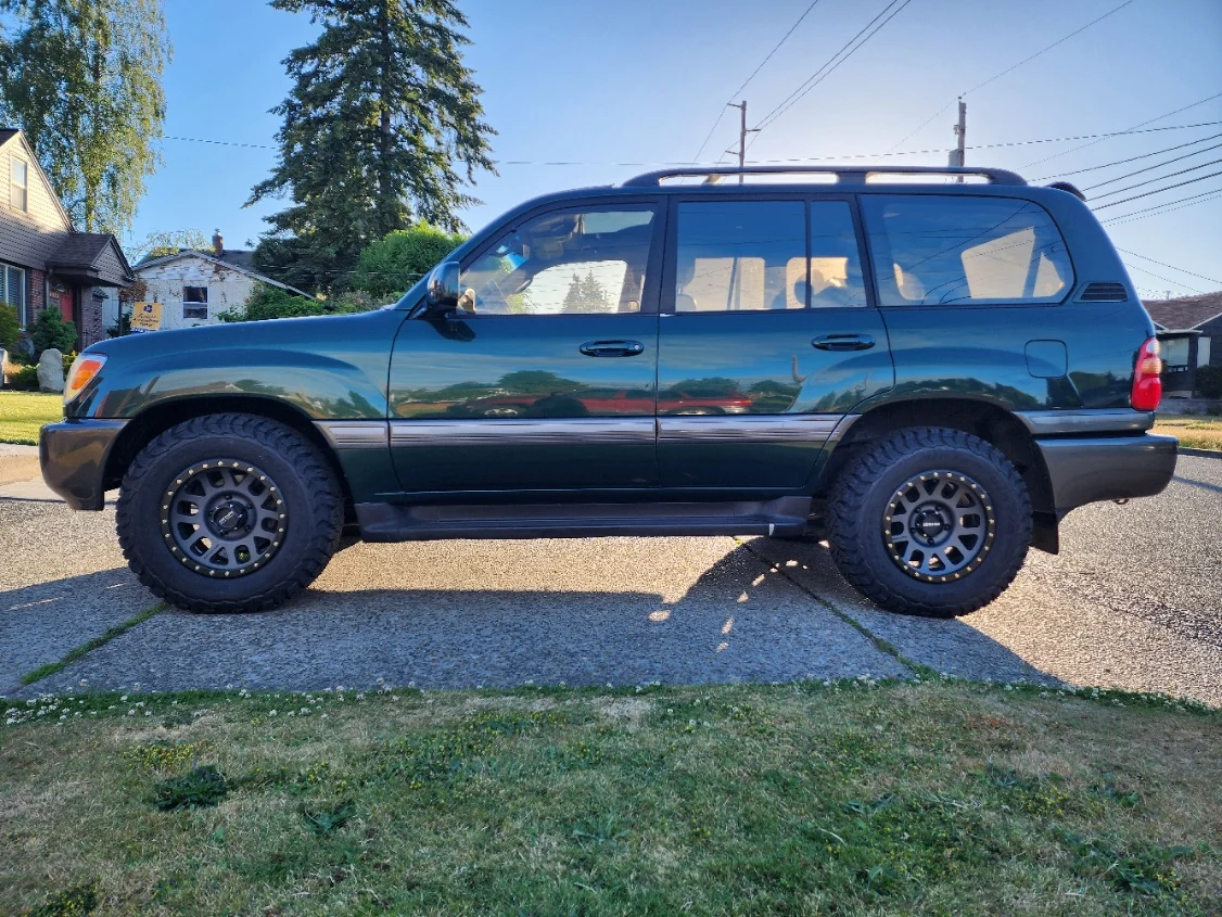

Just got my 1998 Land Cruiser and needed new wheels and tires. Came with 305/50/20. Wanted to go to a 17" wheel so I bought a set of Method 309 Grid 17x8.5 0/4.75" Offset spacing. Was wanting to put 275/70/17 KO3s on them. Just want to make sure that they will go on without any mods or rubbing. Seems like from reading and searching through the forums that they should work, but I want to be sure. New to this game and trying to figure out offset and such. There is no lift currently on my rig. I look forward to the replies. Thank you.
275/70R17 would be about an inch taller than stock, and wouldn’t normally be an issue, BUT your proposed wheel is 0.5” wider, and 0 offset, which I believe would push the wheels outward 2.61” (0.25 + 2.36). If it were mine I’d be looking for something closer to the factory offset of 60mm.
Ended up going with 265/70 17 on the Methods. Have a slight rub on the front wheels at the pinch weld plastics area. I'll either cut or remold the plastic, do the pinch weld mod or raise the front end slightly with the torsion bars. Now to chase down the vibration that has been there since I bought it a couple weeks ago.
