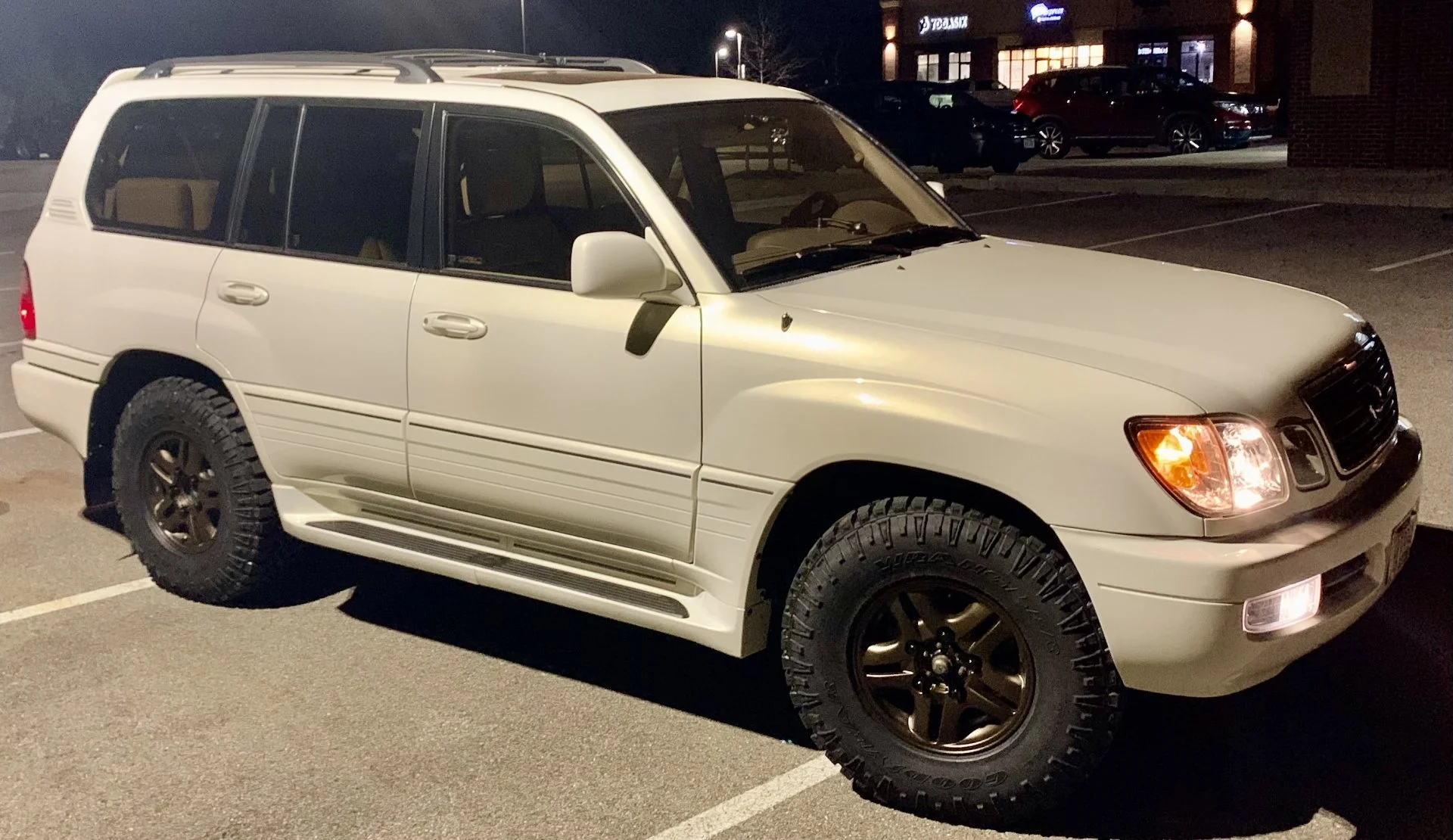

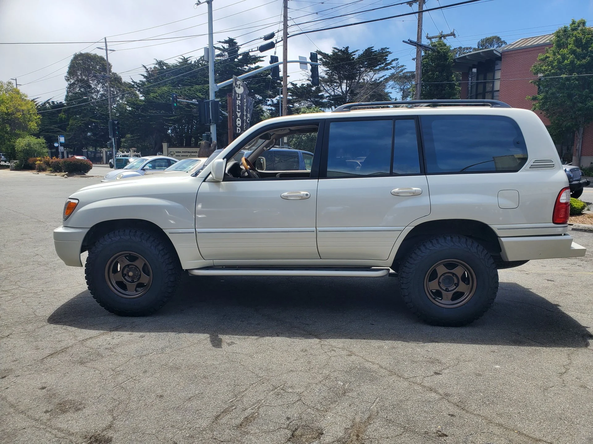

285/75/r16 love the look & this forum rocks!

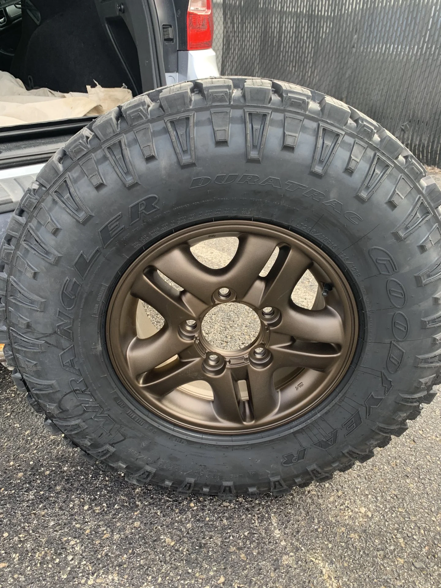

Powder coated factory wheels dark bronze
Stock LX470
Stock LX470
View attachment 2891833View attachment 2891834
Looks great! I picked up a set of 16" OEM LC wheels a while back with plans to powdercoat them and go with 285/75's, 295/75's, or 305/70's. Can't decide which. Leaning toward 295/75's. Got some 295/75 KO2's in my cart right now, but haven't pulled the trigger.
EDIT - Mine is slightly lifted though, not sure how much exactly. Something around 1.5" probably.

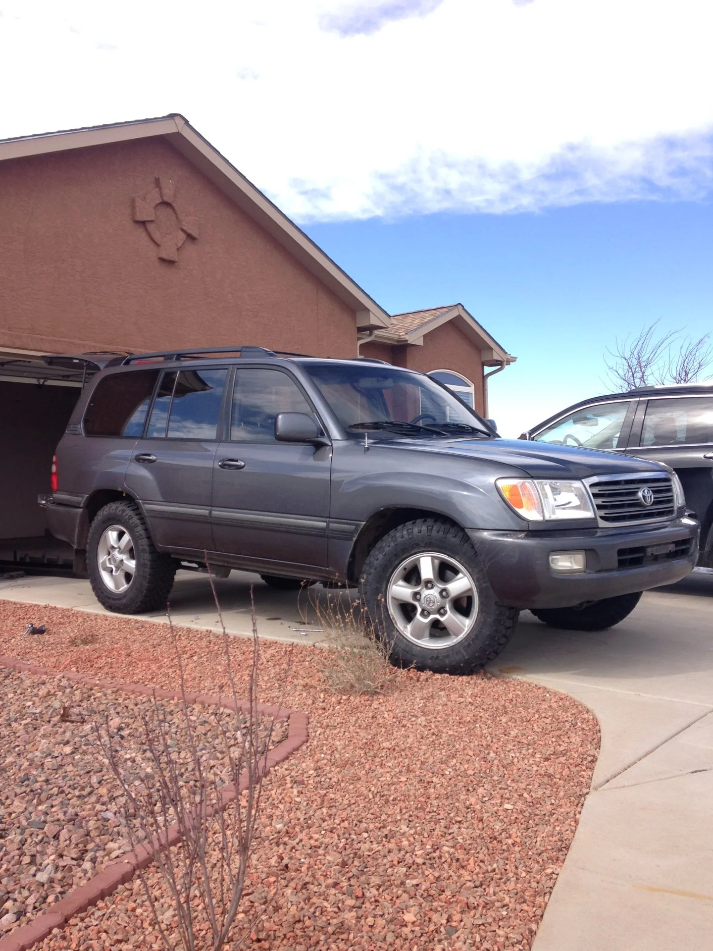

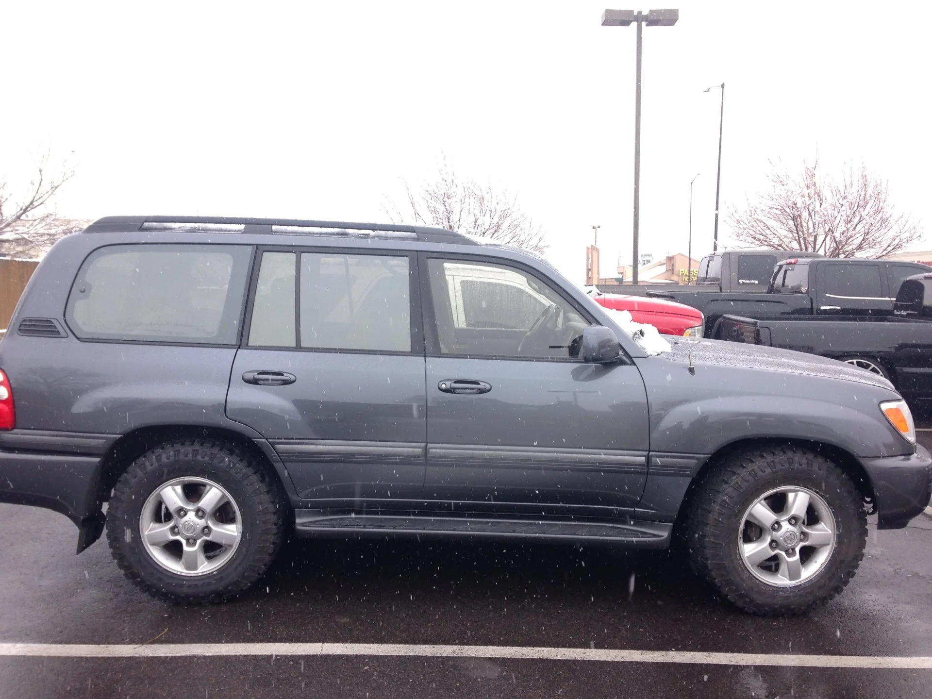

Very popular tire size, a search will do you good. There is no lift, spacer, anything needed to run a 275/70r18 stock, just pop them on and go. That tire is a perfect fit which is a big part of the reason I've never put serious thought into changing sizes. But here is a photo of mine when I first put them on fully stock, no lift, no rubs, no issues. For real though, try searching or even reading through the 17 pages of this thread, you will find the answers you are looking for.
With steps, literally in the Discount Tire parking lot.
Few days later, no change other than steps removed.
Stealth Custom Series F5 - 16x8, +10mm

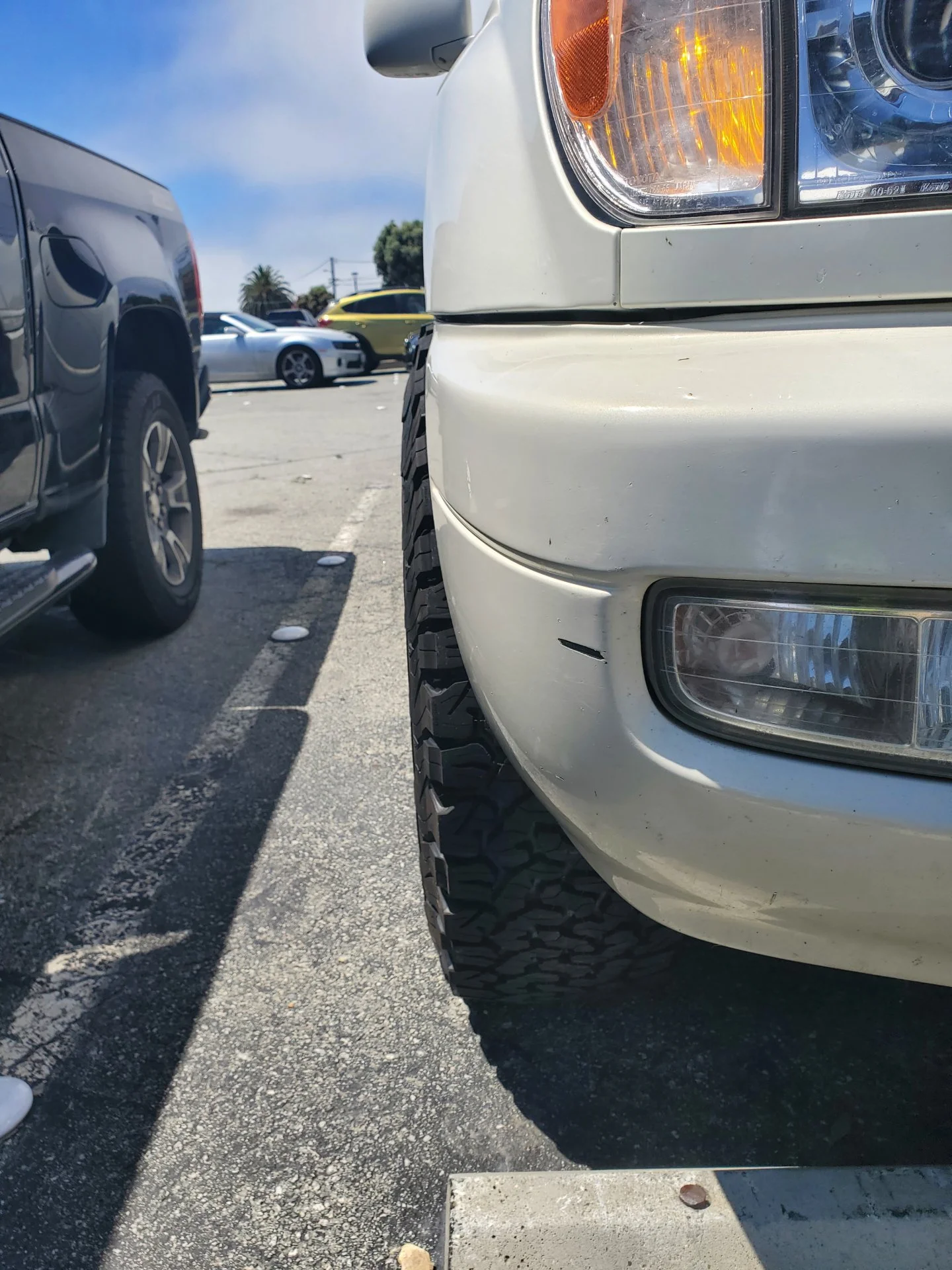

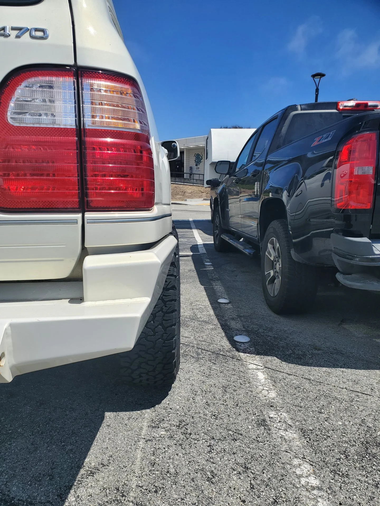

285/75 R16 BFGoodrich T/A KO2
Just the slightest bit of rubbing in the front at full lock. I need to adjust the AHC height in the front a bit.
