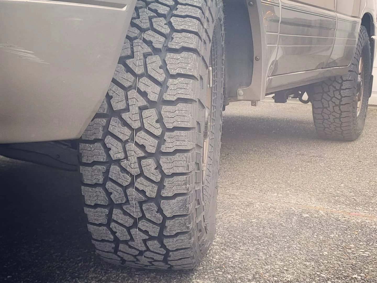

I just bought an 06 LC with AHC and need new tires. I'm leaning 275/70R18. Anyone have new photos for inspiration? I was thinking Falken Wildpeak, but their website says they are 33.4" x 11" and I'm concerned about that fitting in the spot for a spare with a factory hitch. Can anyone confirm this exact set-up works and if so, any spare tire mods needed? I will still need the hitch for a bike rack, but not likely to tow. Thanks!
That is the most commonly used tire size on this board. It works. You may have trouble fitting the spare if the hitch isn't OEM.
I know it's a very commonly used size here, but the Falken tire runs a bit bigger than others so I was hoping for feedback on that exact model with the Toyota factory hitch on a newer 100 series (I think there are some fitment differences on different years). I had to do the spare tire mod on my 2000 LC to fit a 285/75R16 K02 and that was over a 1/2" smaller and very tight if I recall correctly. I don't want to buy a tire that won't fit in the spare location with a matching 5th. Anyone running Wildpeak in 275/70R18? Thanks!
Indeed. Great tire so far.

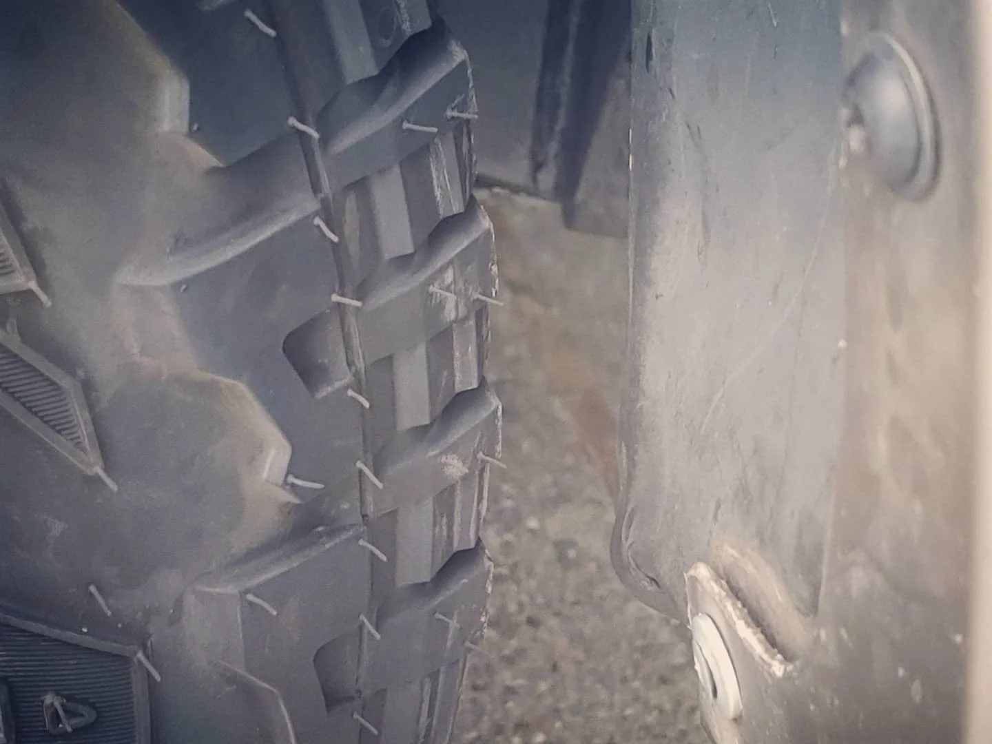

Has anyone run 305/60/18s on OEM wheels? 2007 LX at stock height. I'm interested in the extra width of a 305 but not so much the height of the 65 aspect ratio. Wondering if the folks who have had rubbing on 305/65/18s were rubbing due to the height of the tire, the width or both?
295 or wider will rub frame at full lock with the stock offset wheels. You’ll need spacers or different offset wheels.
