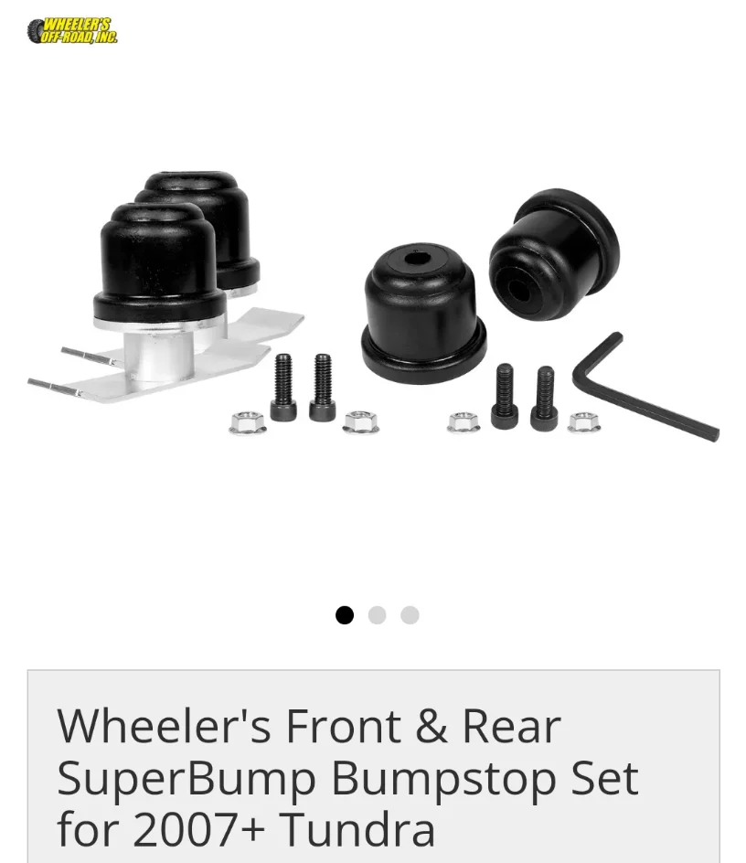

I'm running ko2 305/65/18 and 1.25" Boras - I have the bottle rub issue - are these the bump stops you are referencing?
Negative.
They look like this:
to be clear- even though these say 2007+ they work for the 100 (in my case 2001)? Just wanted to double check before pulling the trigger, excited to get this rub problem solved.
03+ 4Runner, 07-14 FJ Cruiser, 05+ Tacoma & 07+ Tundra
SKU: WOR-306949
Checked and this is what I bought.

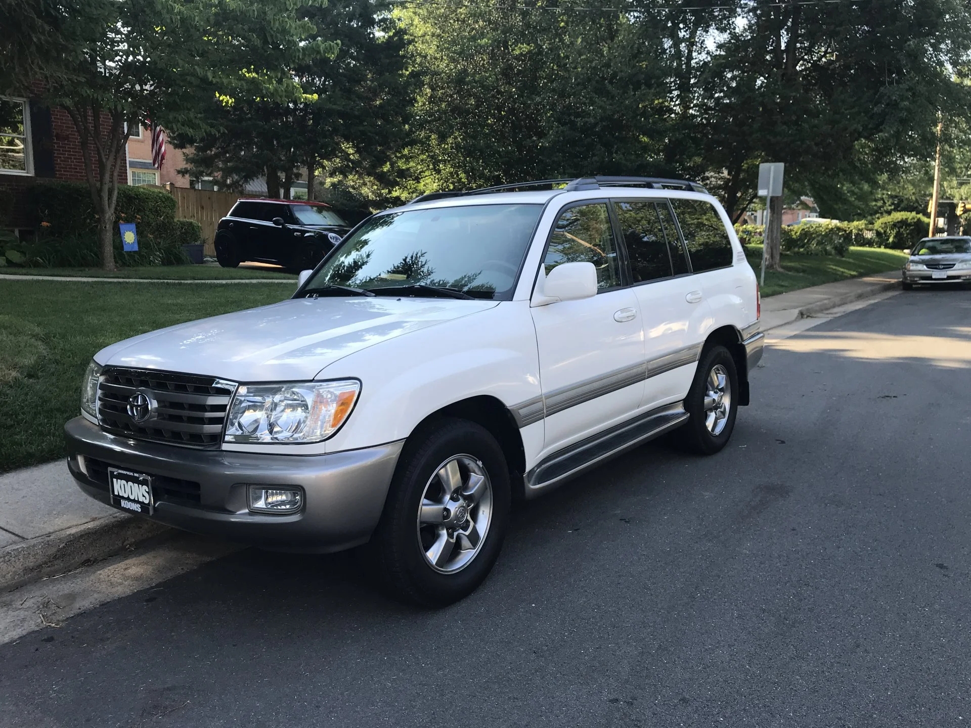

The White Rhino got some new shoes (275/70/R18 Goodyear Territory MT)...no rubs, but the tech that installed the tires said the spare wouldn't fit. I have a factory installed hitch, so I guess I am going out to figure out how to make this work.
Before
After - I am super stoked about how the tires fill out the wheel wells...now just to get the spare situated.
275/70/R18 - Aired down A LOT
