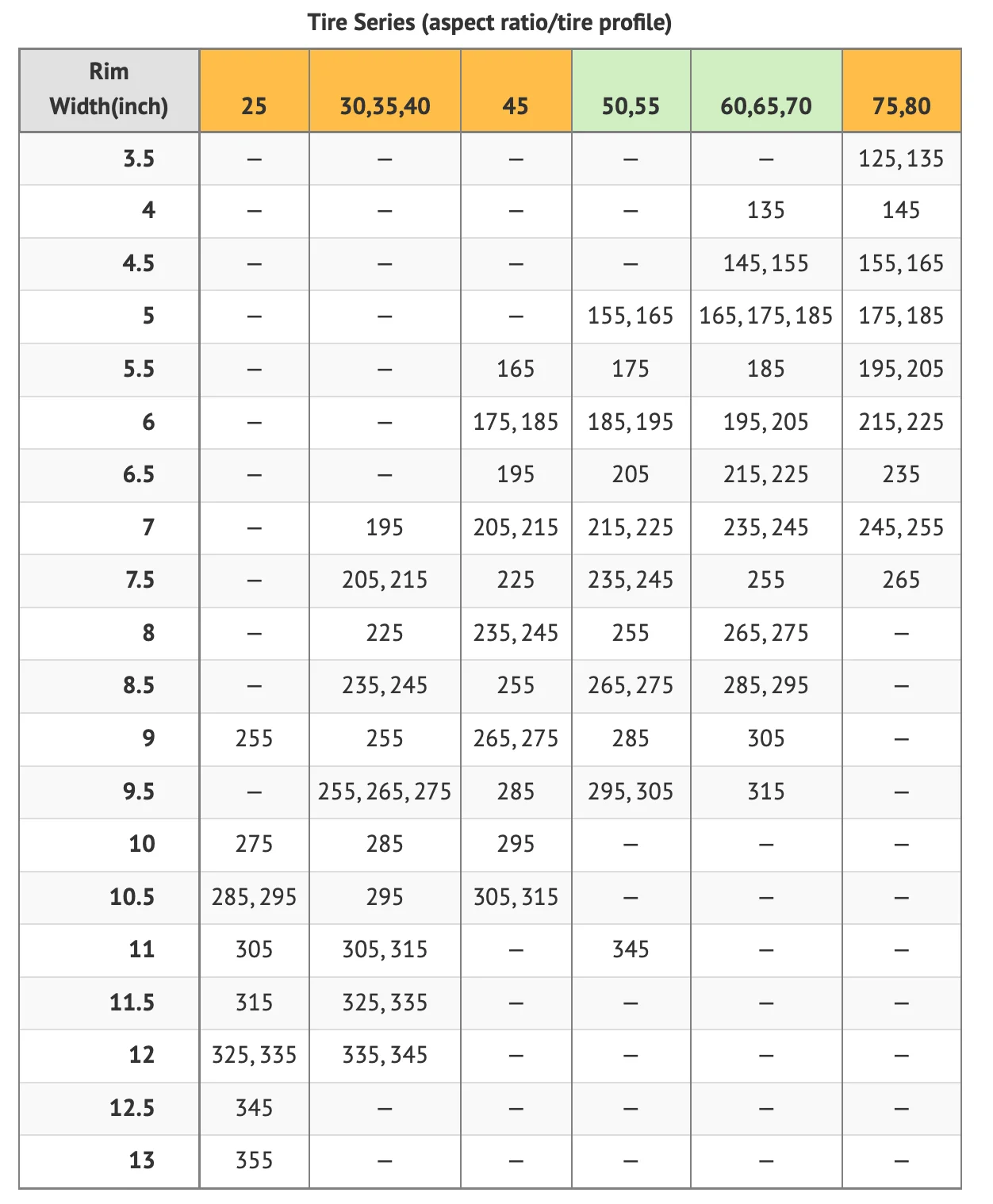

I am a bit embarassed to just din this chart this evening. BUT, it's really helpful as I look for new wheels trying to figure what tire sizes the new wheels could support.

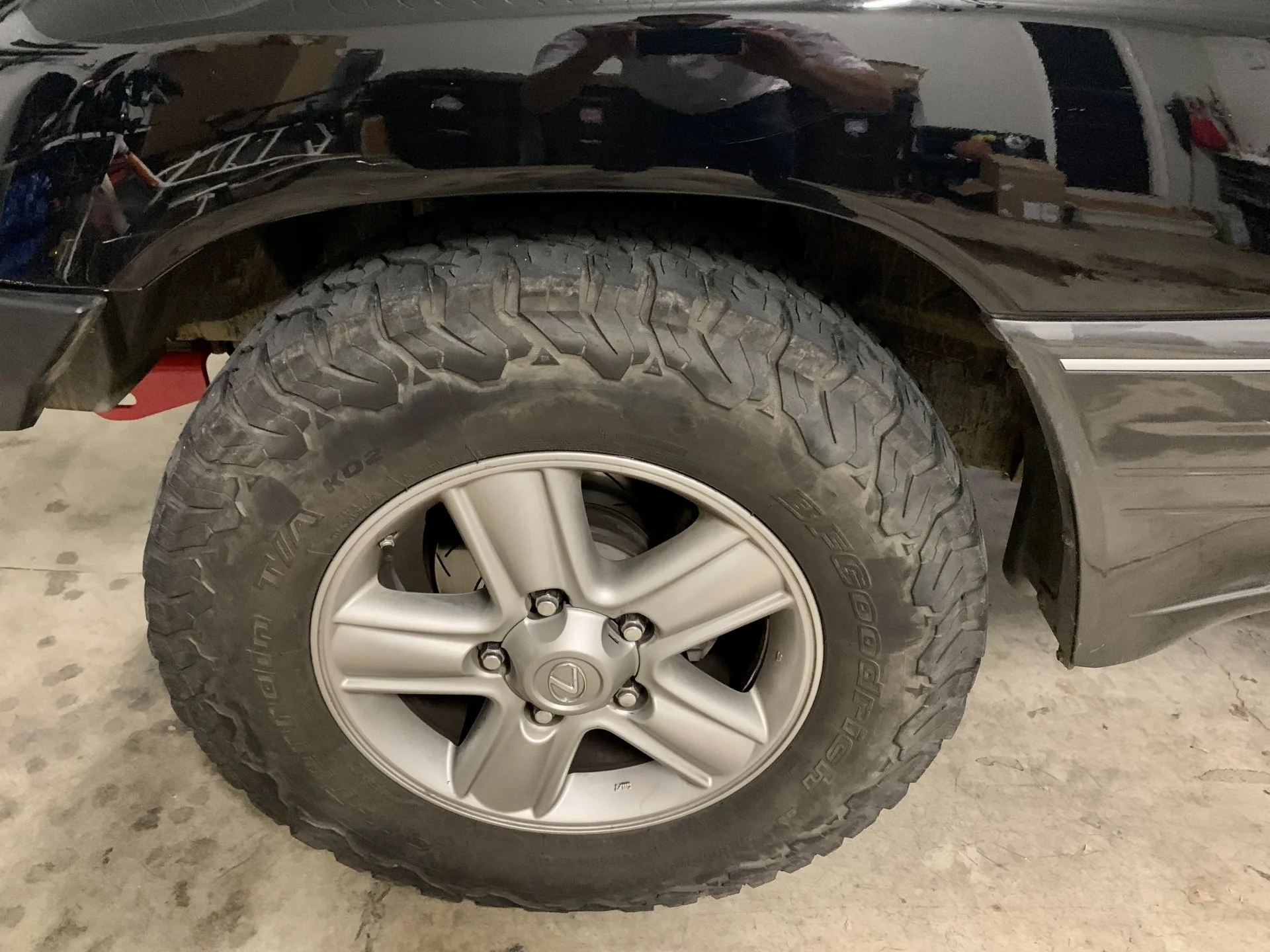

I’ve read pinch weld threads and seen pics but I just don’t know enough yet - just feels like I have a lot of room. Is more clearance needed in the front wells, rear wells, or both? My front wells seem pretty “empty.” This is my front drivers side:

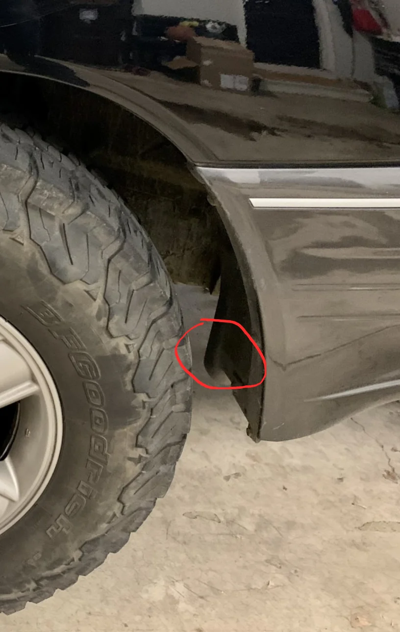

Right here. Turn your wheel and see how close it gets. This is what rubs and needs to be flattened when you go 34"+
