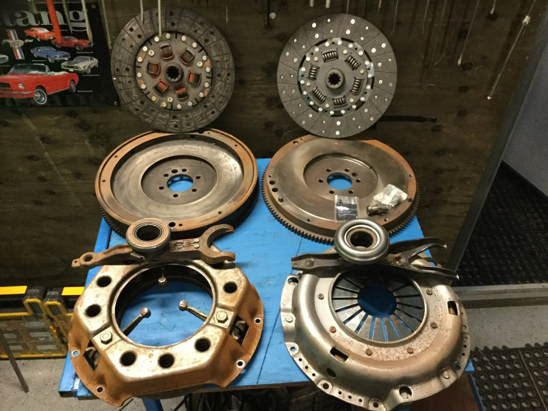

Yes, bolt the 3 speed bel housing onto the 2F block, install the three finger clutch onto the crank and you’re set.

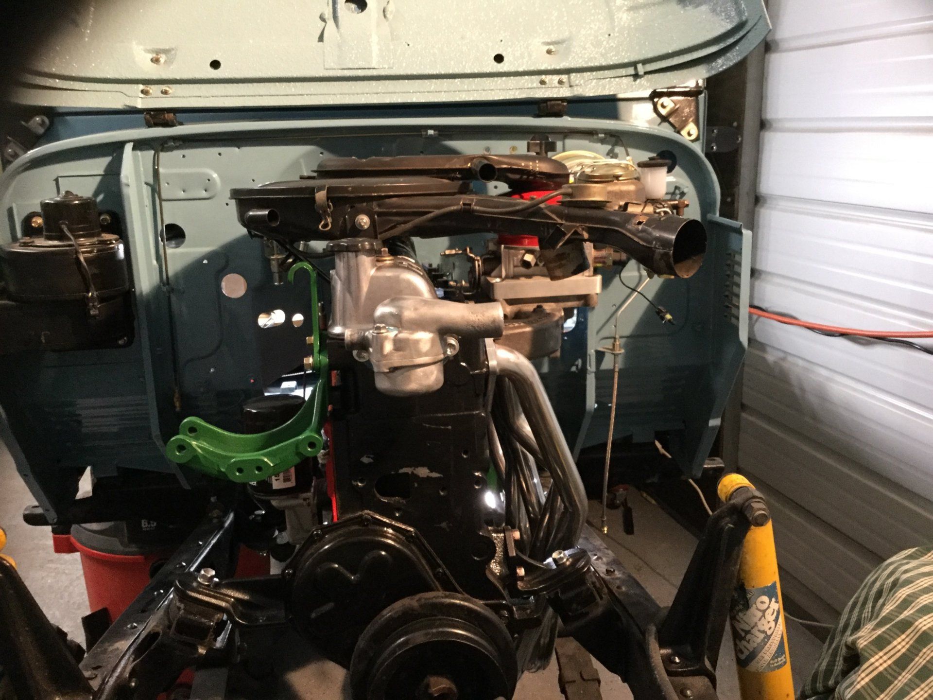

Hey I am doing exactly the same thing! For me I am at the point that I have something screwed up with the motor mounts used, the engine is in and mounted bt but something is screwed up because I dont have the clutch slave cly holes on the drivers side. I also moved from the three speed clutch to the four so as you know it a different arm and pivot bolt right. Any chace I could see a couple of photos showing your 2f mounts? Thx. j
the clutch works on either side you may have to extend the line .you can move the arm to the other side by mounting the pivot ball .the hole should already be there for it
You MUST separate the 3 speed from 4 speed components, especially the pivot bolt! Stash the parts away that you don't want to use. Also, check the clutch disc orientation, and write "engine" on one side and "transmission" on the other in magic marker. Do this well in advance of assembly time!
I seem to recall having to drill the motor mount bracket holes out for larger bolts.
The 2F manifold studs & bolts are larger. You can run a 1/2” bit through the bolted together intake/exhaust to open them up, or I’ve heard that Spector has stepped studs.
