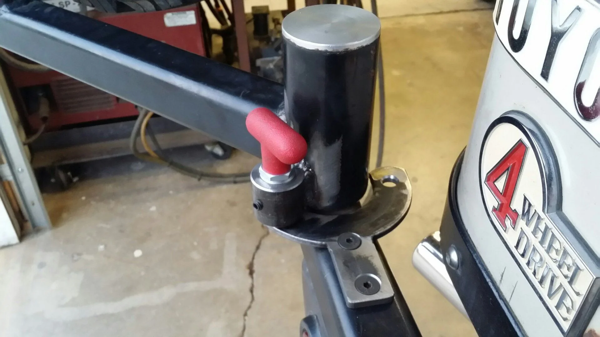

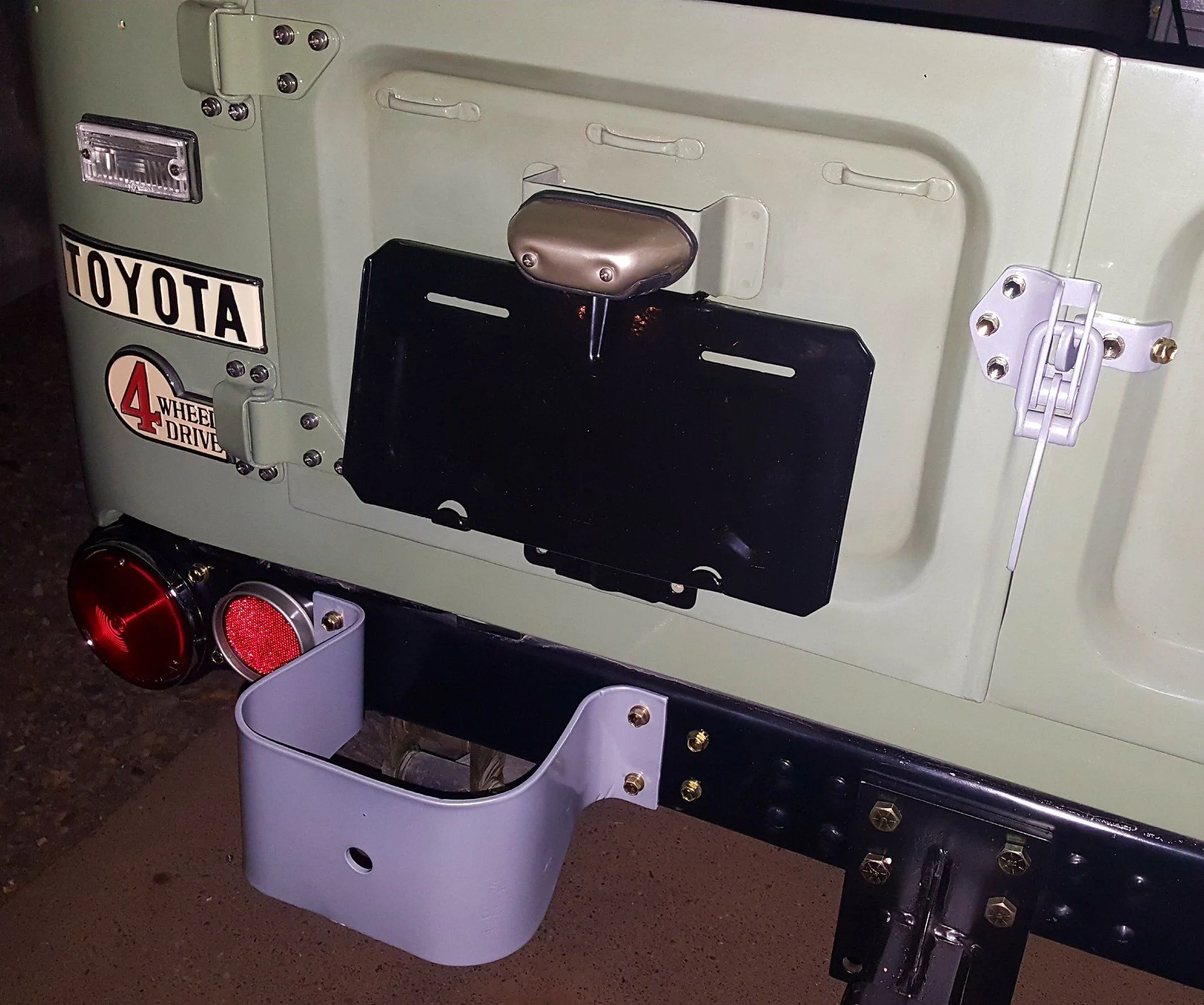

Project 1: Swing-away carrier stops
A couple years ago I had to open my tire carrier while on a very off camber portion of the trail (Yep, broke down) and the half on the down hill side popped the end off the strut and hit the rear quarter of the tub.:crybaby: I had trouble with the struts before and had always intended on a stronger, more positive stop/lock. But not soon enough.

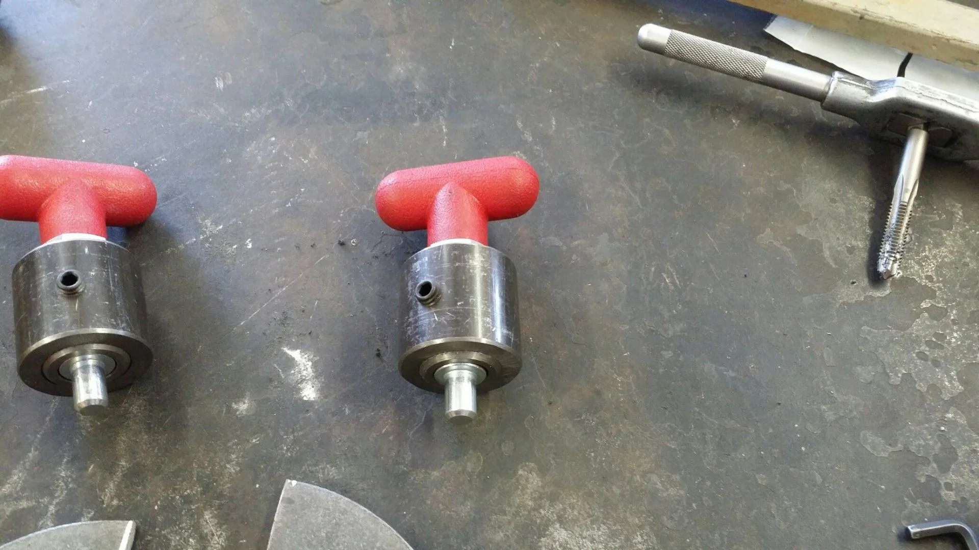

As luck would have it I won a gift certificate from TMR at this years Rubithon and as I was looking through their web site I found some spring loaded pull pins and :idea: an idea was born. Hers is my build.

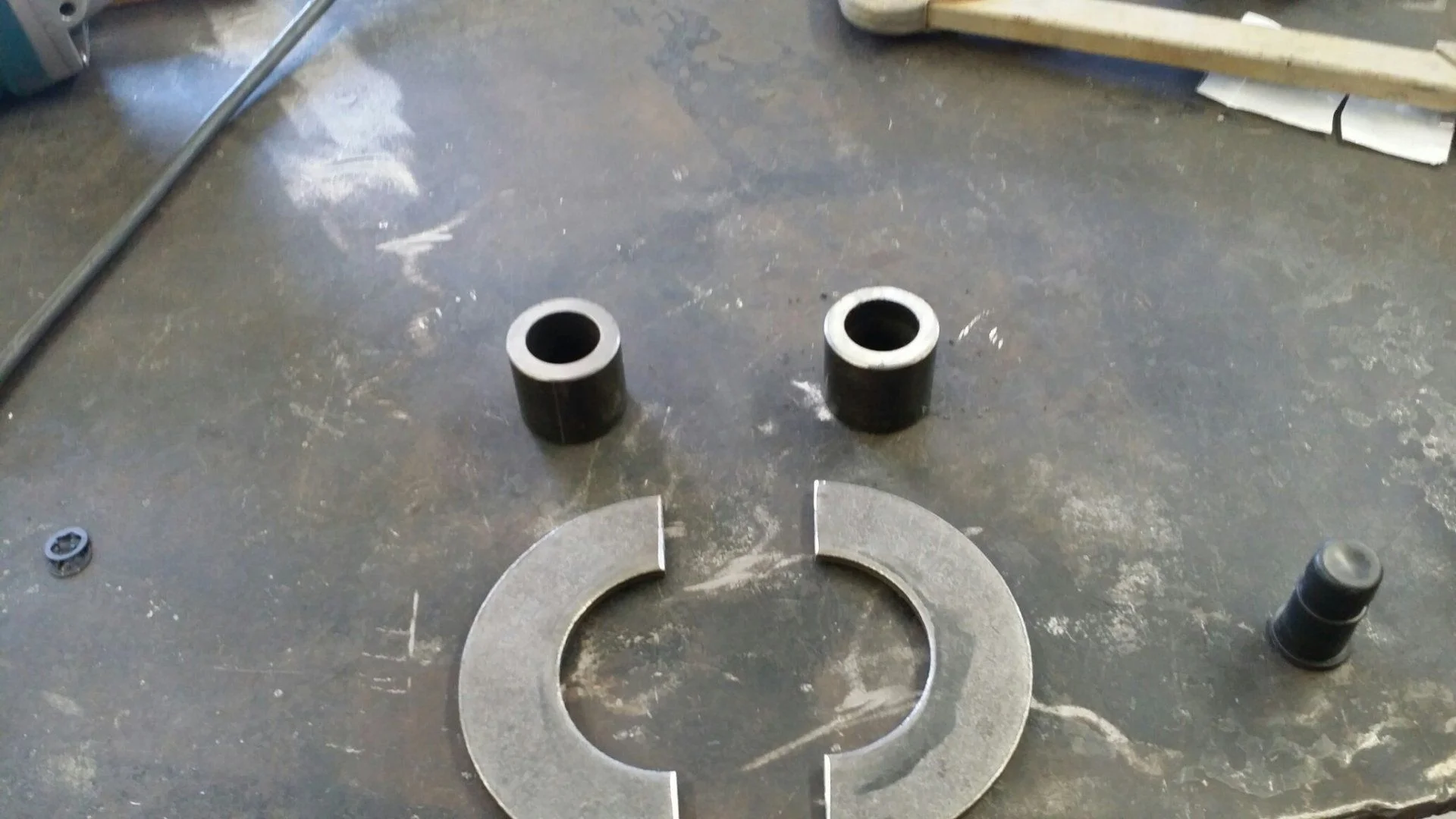

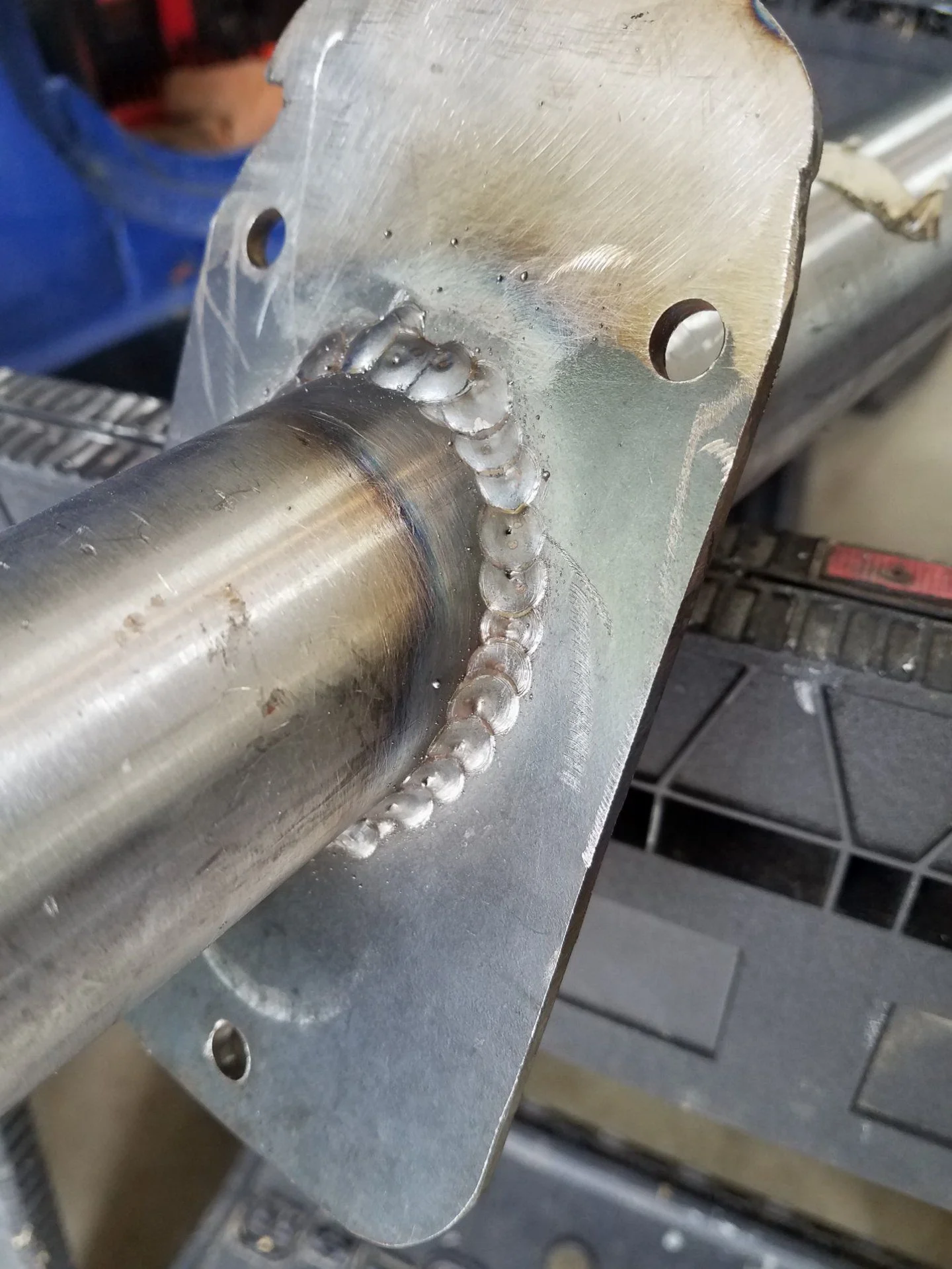

I started with a flat washer for a 2" bolt, it is 1/4" thick and it had the right ID and OD for my purposes. Then I added 2 pieces of DOM that were a perfect fit for the pull pins.
I drilled and tapped the DOM, cut the washer in two and added mounting tabs.
The I welded the DOM to the hinges, figured out the swing radius and where I wanted the stops. I only needed a about 110º of swing to clear my early OEM drop down tail gate.
And presto, stops.

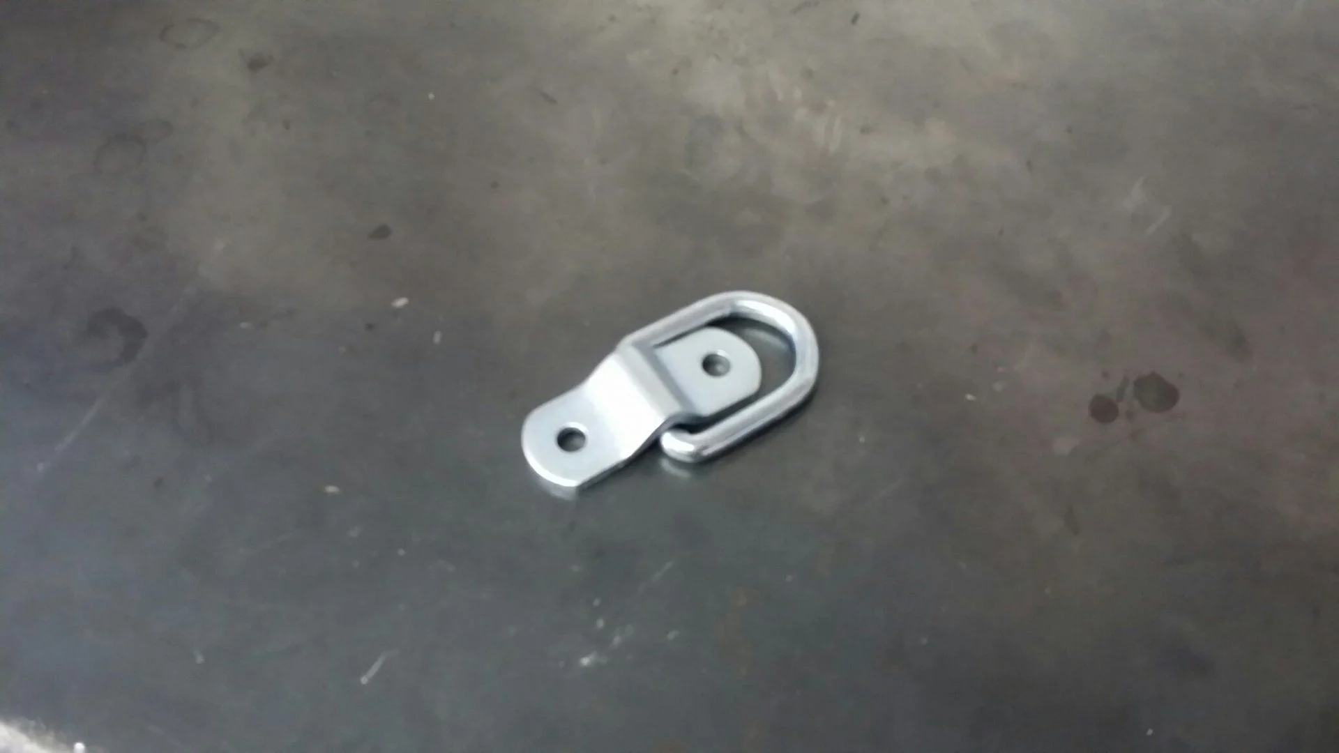

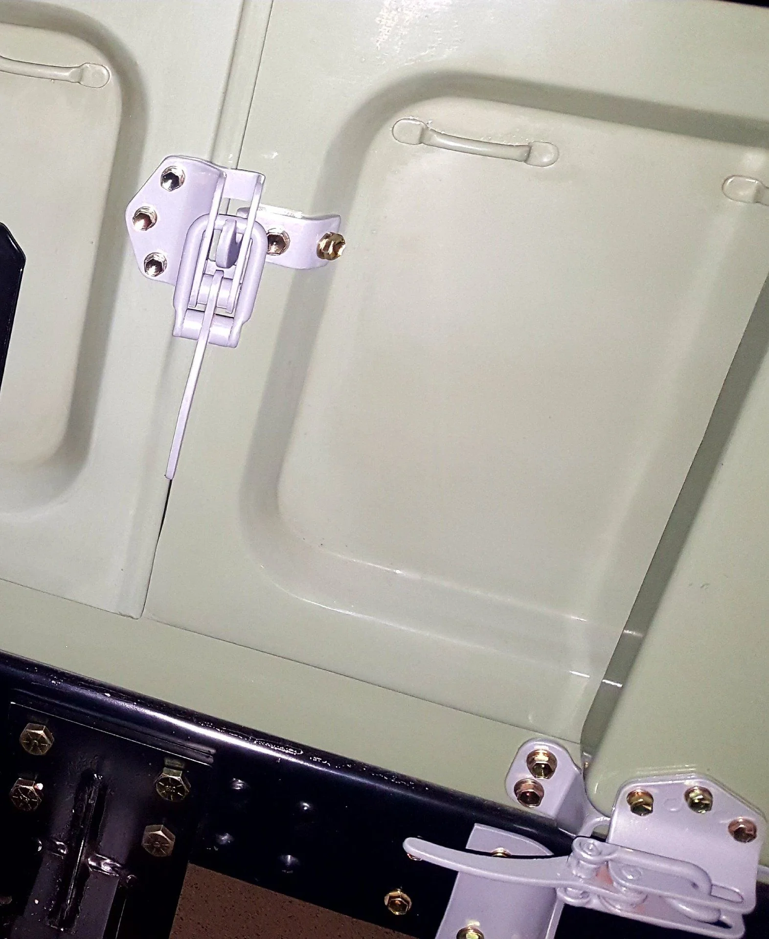

I can't believe I fought this one this long, and I was tired of wrapping bungee cords around my roll cage and other equally hokey locations. I had an idea of what I wanted and a long time ago had acquired 10 small D-rings and mounting clips. I also wanted something I could install and remove quickly, and used existing OEM threaded holed so I could take it off when not on the trail. Here's what I ended up with after a quick 2 hours in the shop.
I started with the D-rings, and 1/4" X 1" flat bar because it fit cleanly on the hardtop mounting rail. The mounting clips didn't fit on the bar so I 'clipped' them, then welded them in place. I cut them so the D-rings would be under a little pressure when welded in place so they wouldn't rattle.

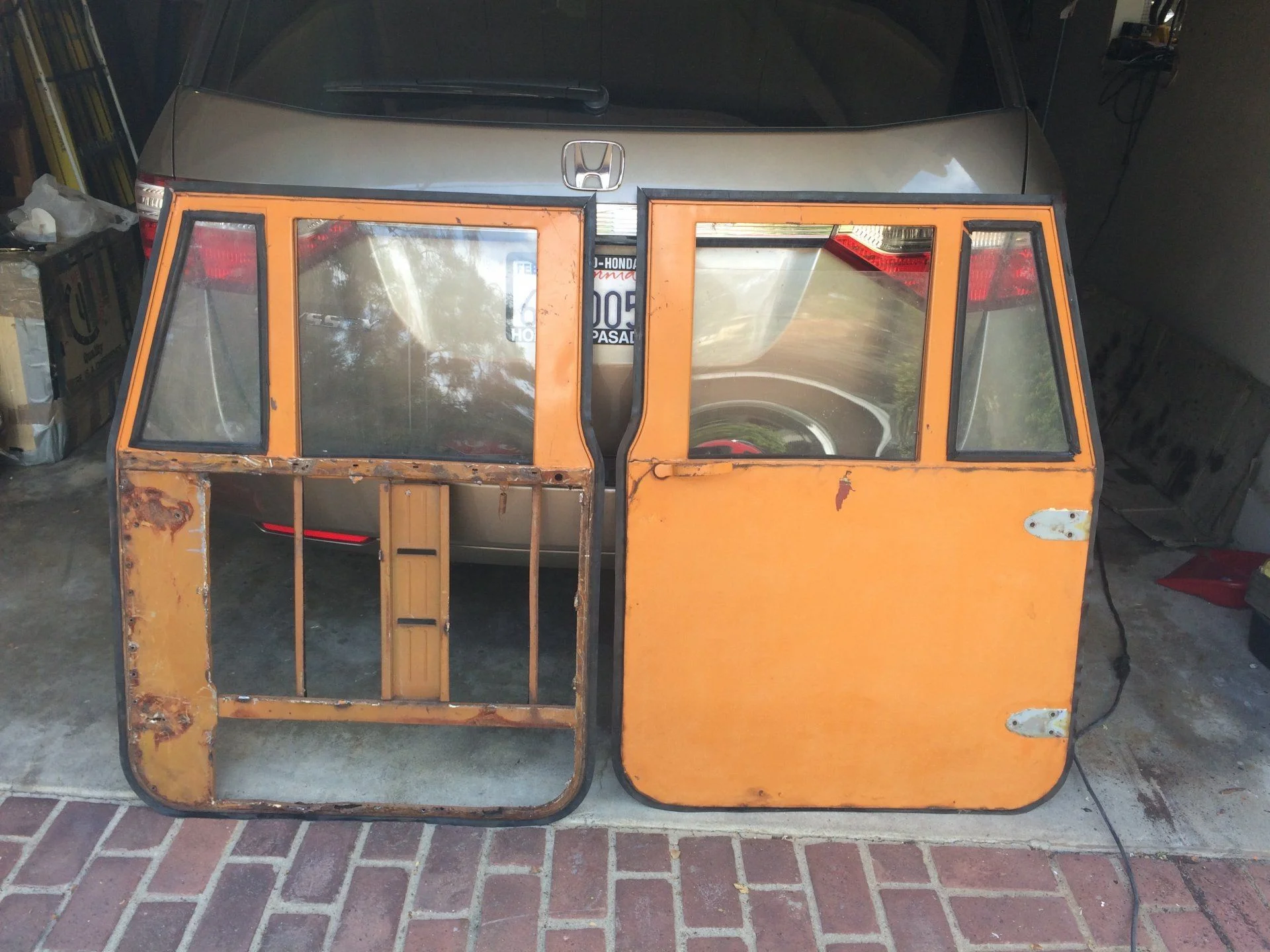

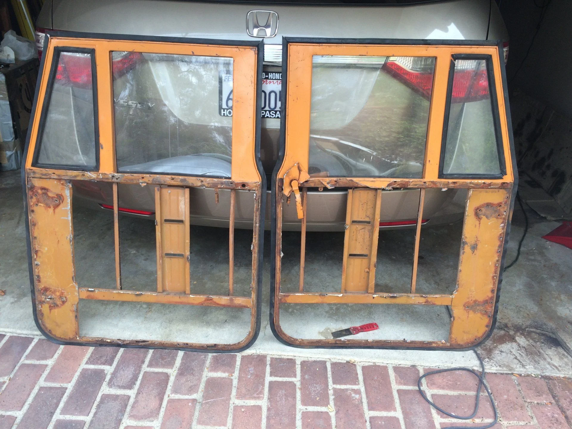

Spent some time on some soft doors I purchased last year on eBay.
I did not realize from the photos when I purchased them, but a PO had welded sheet metal in where canvas had previously been. So they've sat in my garage for a while as I tried to find time and tools to get at them.
Here is a comparison of the passenger's side door after I finished, and the driver's side door prior to start:
And the "after" image:
You can see I had some issues with the handle on the driver's side door. I posted some more pics in my thread. Looking for some advice on how the handle is attached, and more importantly how I can detach it.
View attachment 1531717 View attachment 1531725
That there's pretty slick... sort of looks like a useful business venture! ;)

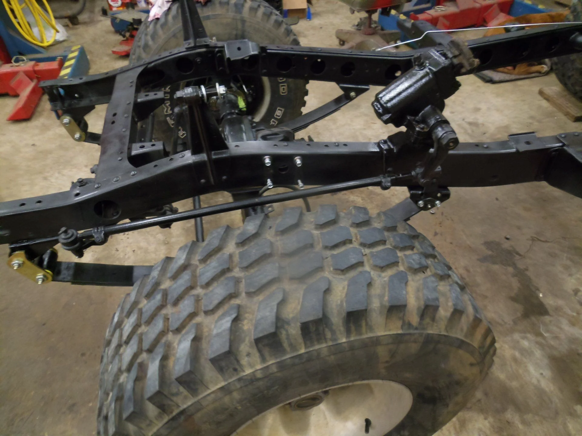

Anyhow, I continued getting the rear end buttoned up. Everything is nice and tight with no rattles...
Decided to put yellow zinc on all non body color parts, and stainless on body color parts like hinges etc.

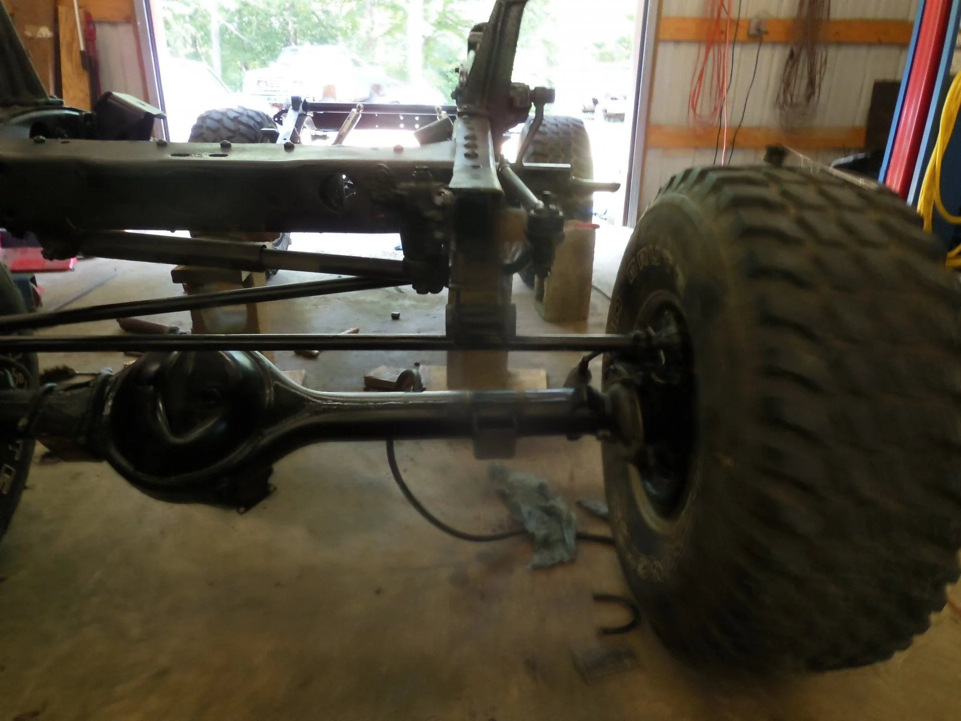

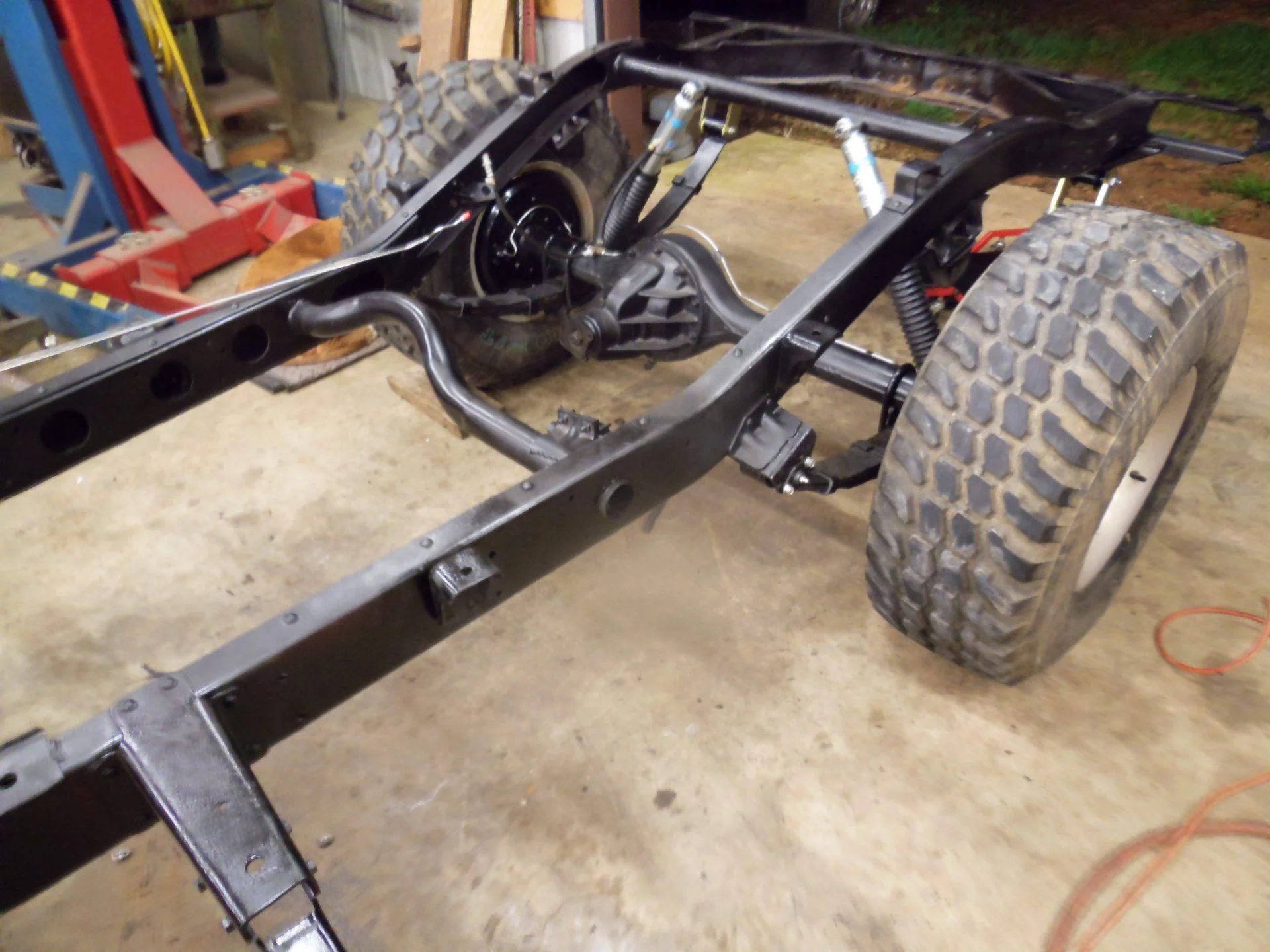

Replaced the bushings shackles and pins on the front.
Decided to go with new springs on the front. Now trying to make up our minds up which way to go medium light, or medium heavy. The ones on now seem a little short, have no idea what brand these are. Someone had removed a leaf and turned the bottom leaf upside down, probably to get it to flex and ride better.
I'm hoping the back comes down far enough it doesn't ride like log wagon.
