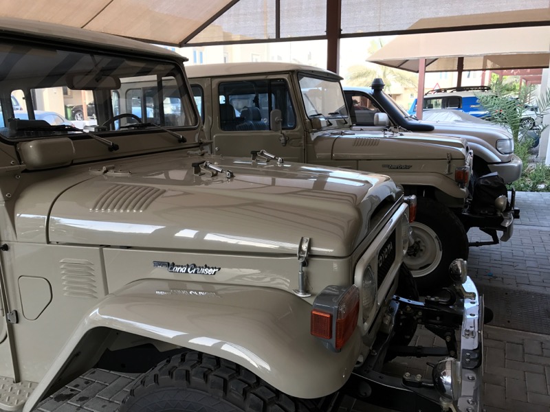

I've got an interloper in my driveway...
It's a 1980 from the same shop that did mine. They are having me road-test it and put together the punchlist of items to straighten out to button up the restoration. Fun times! Other than the lack of AC and 110F temperatures.
