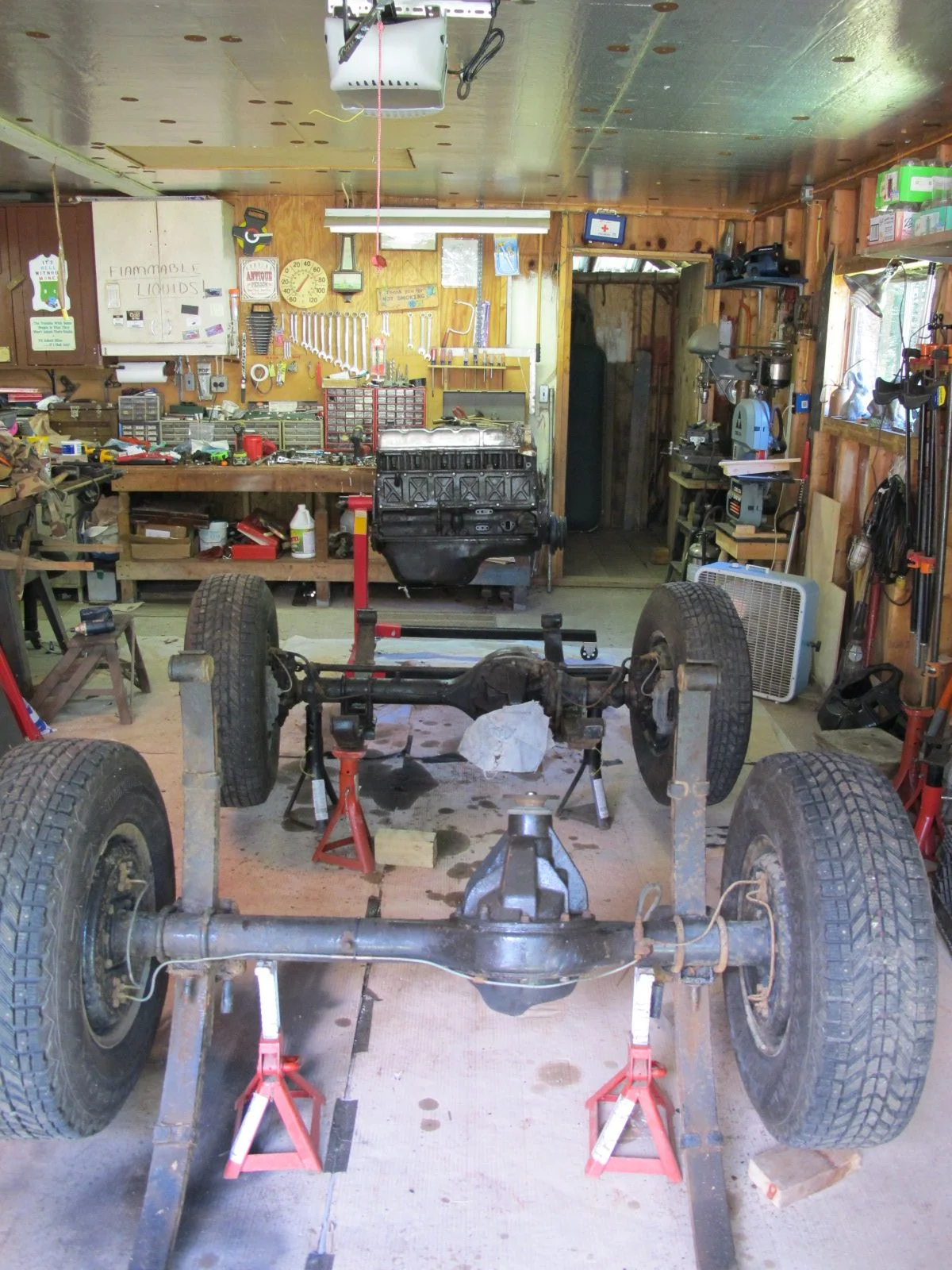

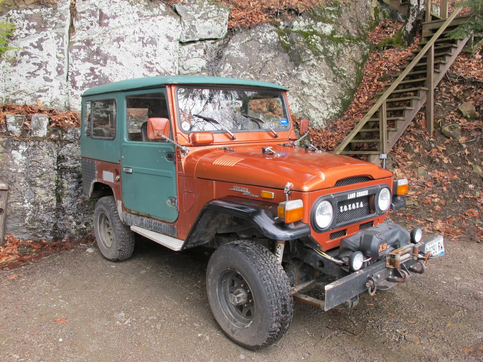

From this to this and hopefully to this It is amazing that a month ago I was running my 78 FJ40 cruiser, it's all gone, everything has been taken apart and the fun begins to put it all back together with new bearings and seals, cleaned and painted, rust and road salt proof. I'll be returning the chassis to stock from a 2" leaf spring lift, the donor frame from a 63, a 78 cowling with attached Aqualu 3/4 aluminum tub. The hard top cap and fenders will now be 6V7 as the rest of the truck. A 77 FJ40 parts truck coming tomorrow will help in the rebuild. But as of today forward its cleaning the axles, engine and transmission/transfer and installation of new bearings and seals.:rofl:
