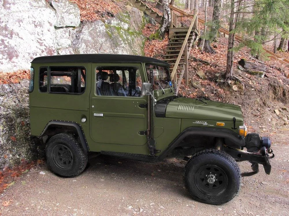

14 years ago I did a wheels up restoration for a 78 starting with 3-78 basket cases, a 71 and 63. Up here the road salt destroys vehicles and most certainly FJ40s. The only rust free body that I could find was a 67 from Arizona offered by Cruiserparts in New Hampshire. Using the 67 body on a 78 chassis and fitting all other 78 body parts on it wasn't hard. Modifications were headers, power steering, de-smog, 50A IR alternator and Weber carburetor. Using mostly used parts, new gaskets and seals I figure it cost me between $5000-6000. with an equal labor cost. This year, after watching the cost of FJ40 parts skyrocket I can see it will probably, at least, double the restoration cost.
The new target color will be 6V7, Skydog has helped me with the project target using computer software. I have a 78 cowling left over and it needs some work, mainly the under carriage on the drivers side as the cross channel that mounts to the frame is rusted away. A friend and fellow cruiser owner owns a company called Sherman's Coachworks and he will help me mate the Aqualu to the 78 cowl and I'll soon have a complete 78 body to replace the 67 (minus the aluminum tub for all you purists'). We will use zinc chromate, epoxy primer, Raptor or Monstaliner on the undercarriage, and two stage 6V7 paint on the interior and exterior body with a low gloss clear coat. Sherman's a professional car restorer and painter, should come out pretty good.
