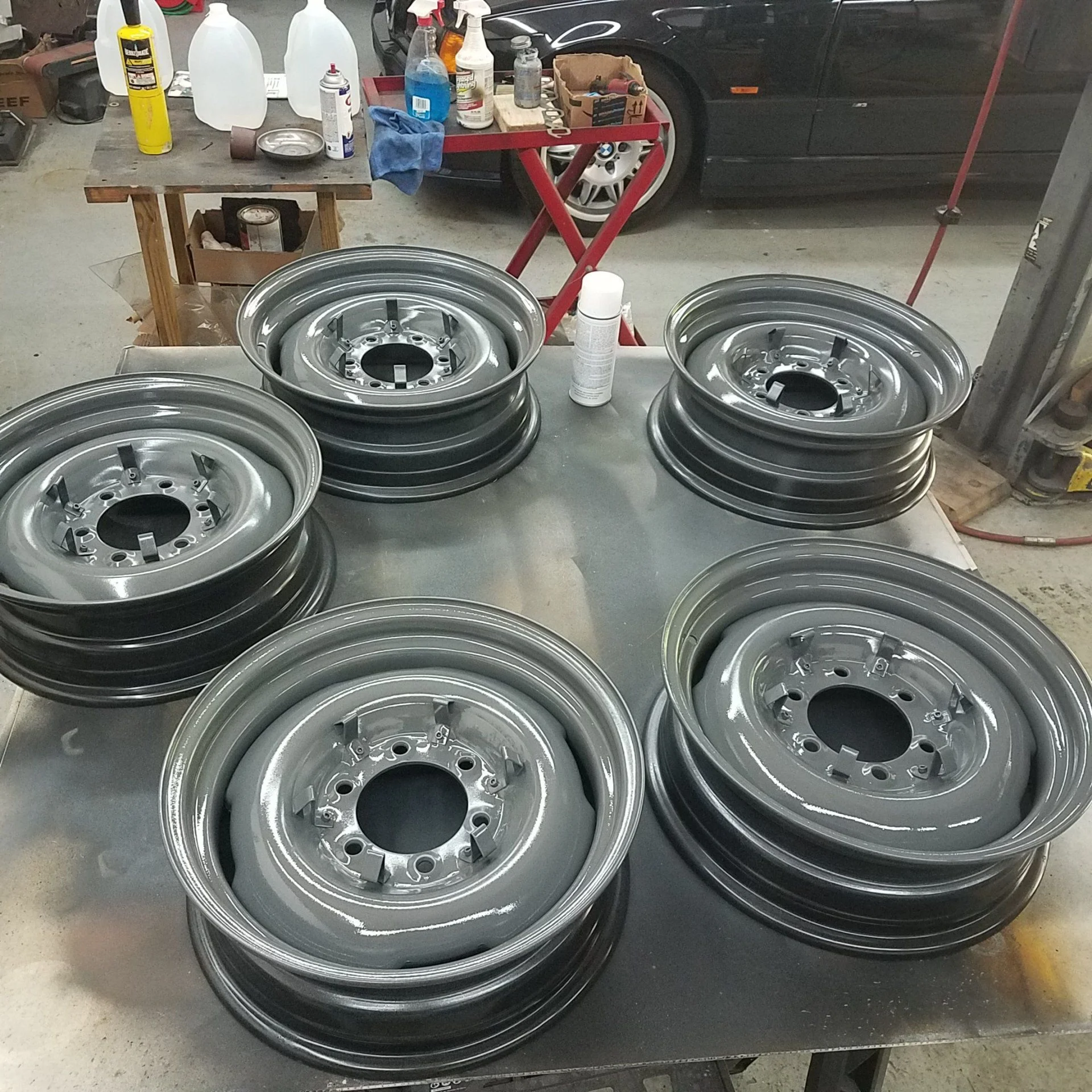

THAT seems to be the preferred color... My wheel project is still wearing primer while I debate which of the half dozen shades of gray to apply!
Thanks... your wheels look terrific ;)
@imyahucklbrry I think you will be happy with the smoke gray, I love the way mine turned out! BTW I am applying Top Coat to my gutters over the Dicor-man it has been thirty days and I swear that stuff is still flexible, AND I am in Arizona. Have a super weekend bud!!!
Must be wheel week. Got some 16" wheels from cityracer, prepped and painted them. New tires next week.

Jt cruiser grey. I know, it is pricey and the can isn't super high quality, but by the time I check four different places and buy several shades that don't look right I will be close to the crazy shipping price!

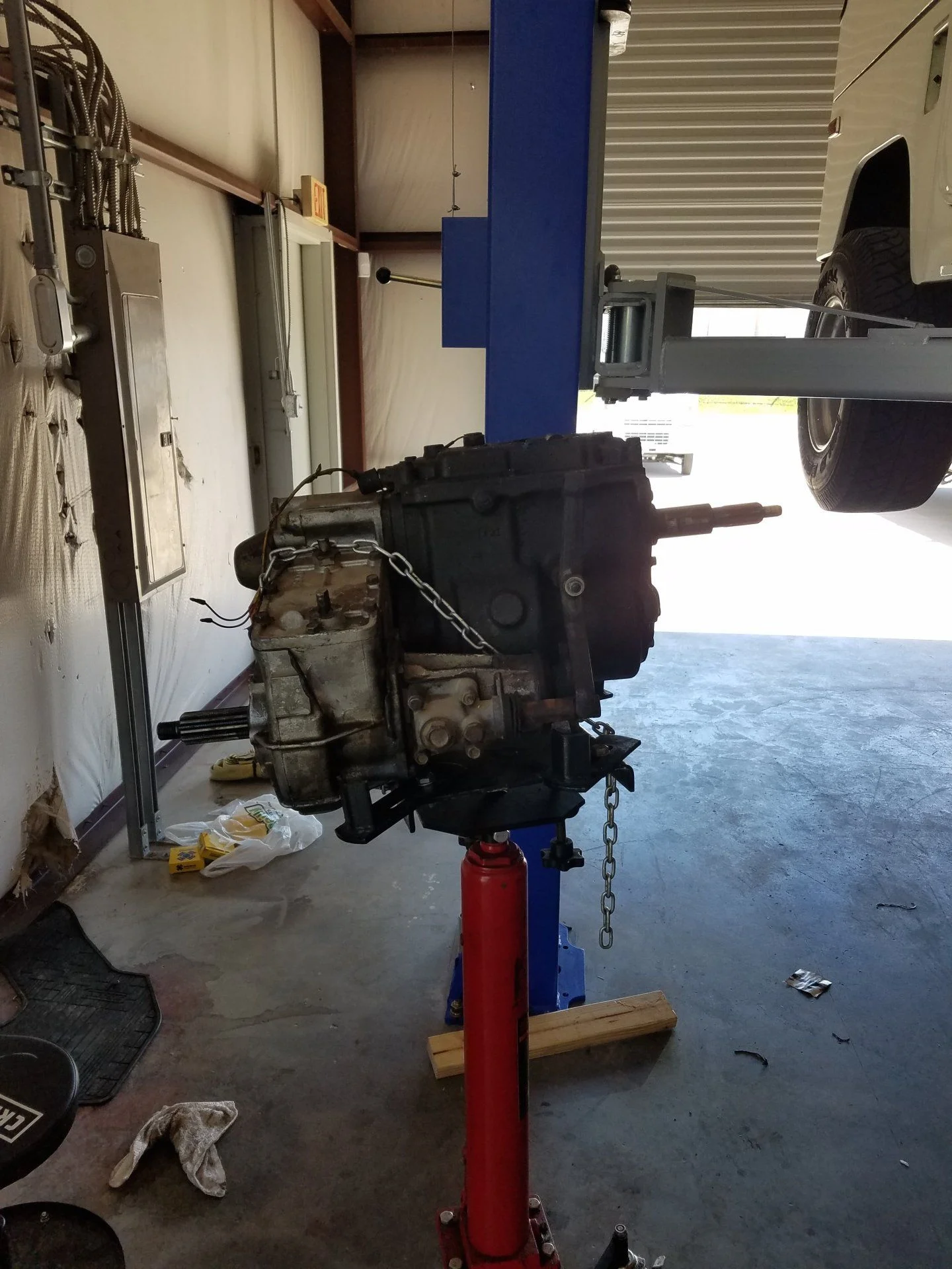

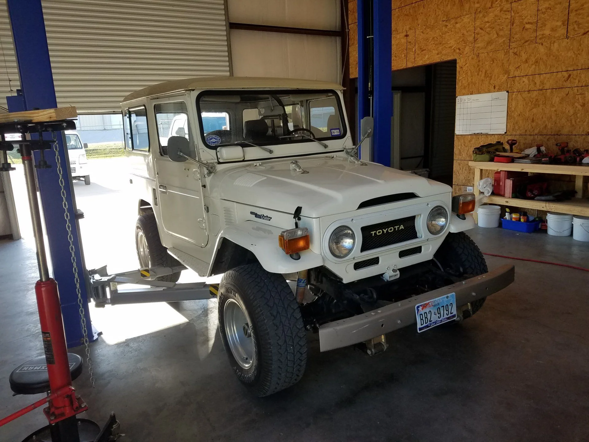

FedEx dropped this off today - 1978 era Warn 8274 for my FJ40. Excited about getting this beast mounted!
Cleaned and QC'd the 8274 today, then mounted the beast.

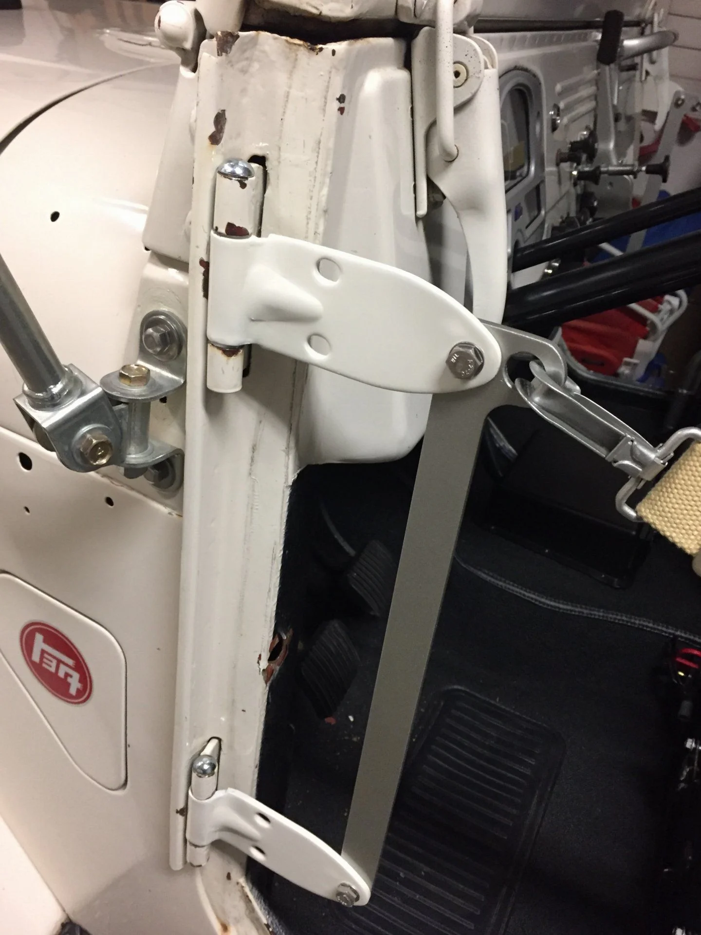

Another batch of panels glossing out after 3 coats. Planning to shoot the interior of the tub tomorrow afternoon (hopefully). The booth will need to get slightly dismantled and then put back together in order to get the tub in there. After that just small parts - hinges, soft door frames, etc.

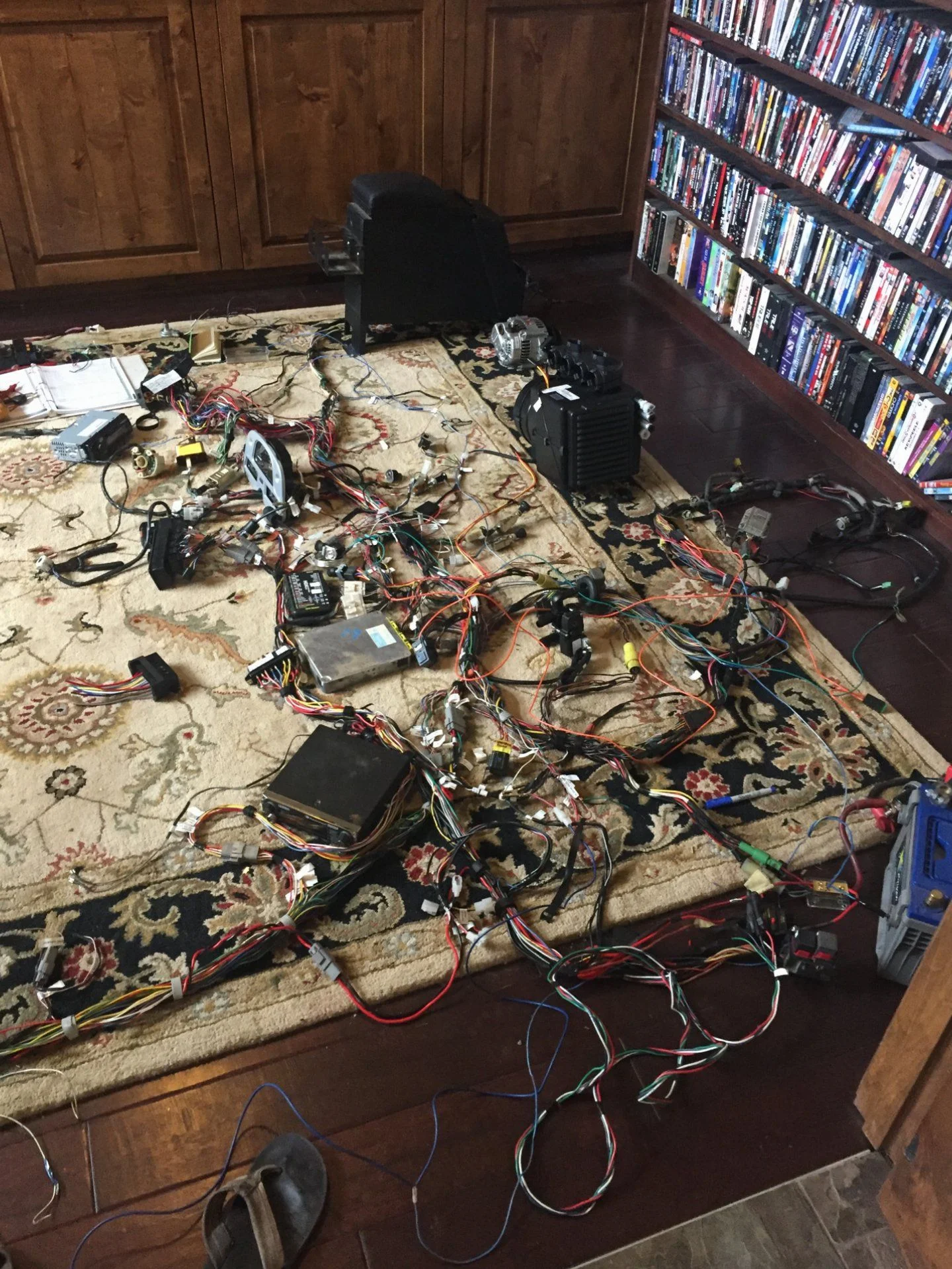

I'm plugging away at the current wiring project. In addition to the 3FE and its additional circuits to run the ECU and ancillary engine sensors, I'm adding the following stuff:
Hi/Lo headlight relays
Daytime running lights
Proportional brake controller
Dakota Digital HDX Instrument Panel
-GPS altitude, compass, ambient air temp, fuel rail pressure, and wide band O2 sensor
Old Air Hurricane air conditioning
Cruise Control
Power door locks and keyless entry
Dakota Digital power windows
Seat heaters
CREE LED rear reverse lights
Pollak fuel switching valve
Primary and auxiliary in-tank fuel pumps and senders synchronized to carling tank selector switch through 5-pin relay (fun).
ARB On-board air compressor
I've been bench testing the entire harness on the floor in my office:
Now, I'm trying to figure out how to route this mass of wiring under a very limited amount of dash space:
