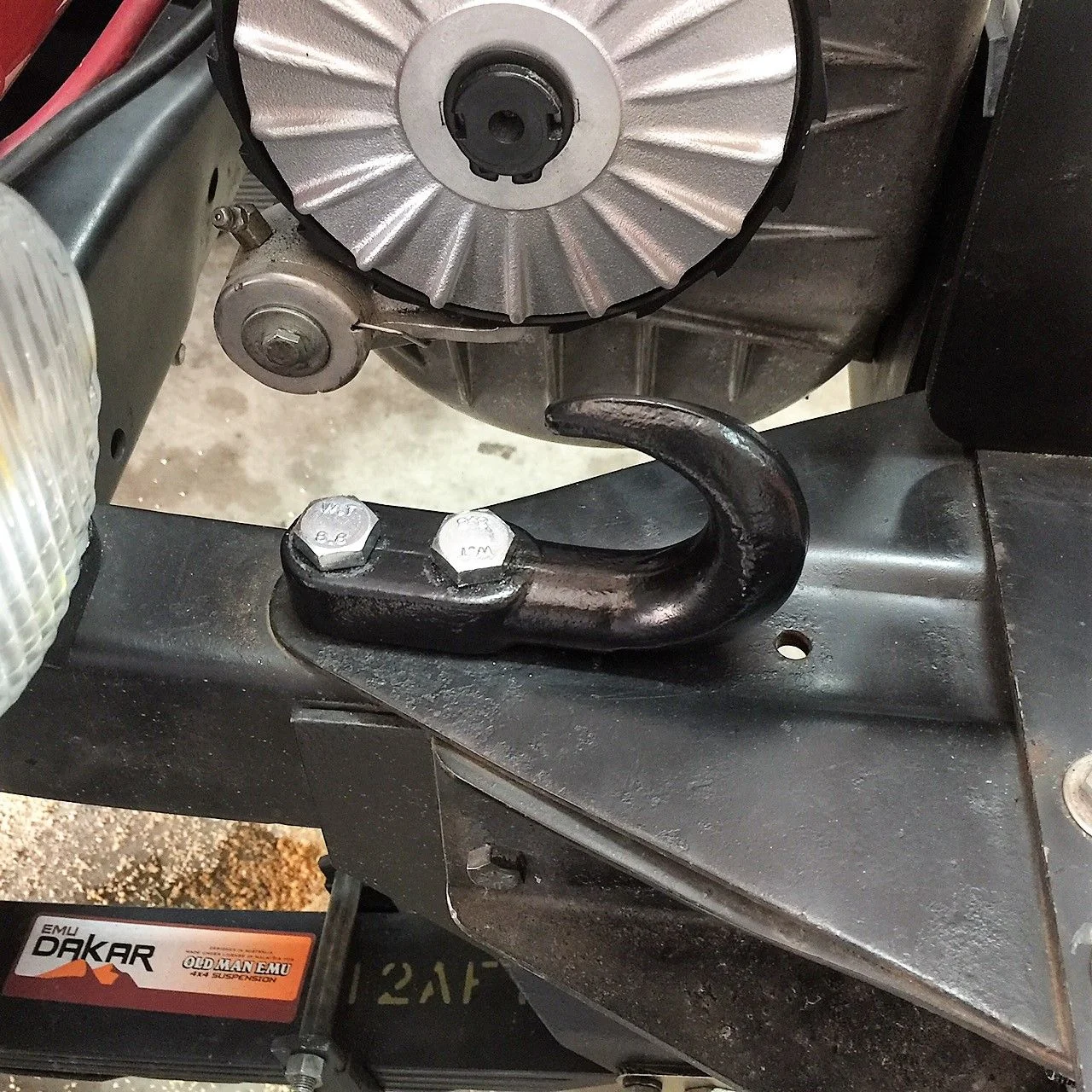

Installed my newly acquired J hook, now the passenger side matches the driver side, I like symmetry ~ part of my OCD.
