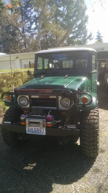

I installed a 4X4 Labs Saginaw bracket mount. Also got my 4X4Labs bumper mounted. Thanks @franklin40 for the encouragement to do it myself. This was my first attempt at welding. Very pleased how it turned out.

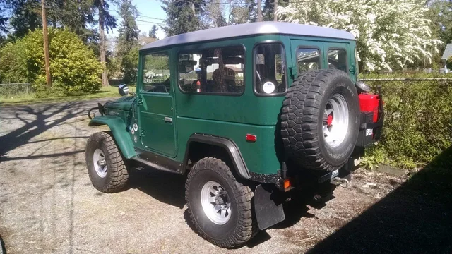

Drove it! :steer:Made the 40 mile trip from my borrowed garage to my new house. Finally, after 3 years of ownership, I have a permanent roof over the truck's head!
