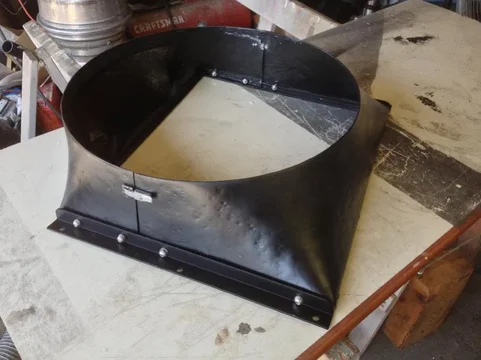

Fan Shroud
Finished my fan shroud and installed it. Made a world of difference! Now it idles forever and stays below 195°. :bounce: Before it would easily climb to 215°~220° due to my fan being about 4" away from the radiator and sucking air from everywhere but through the core. :bang:
For the curious, I opted not to finish sanding and making the outside smooth and purdy because this shroud will be replaced by a new one after the Ranger overdrive is installed hopefully later this year. The geometry will be completely different then, with the engine a few inches closer to the radiator.
All in all, I'm extremely pleased with my first attempt at building a fiberglass shroud. I've made a few notes on things that I'll do a bit differently next time.

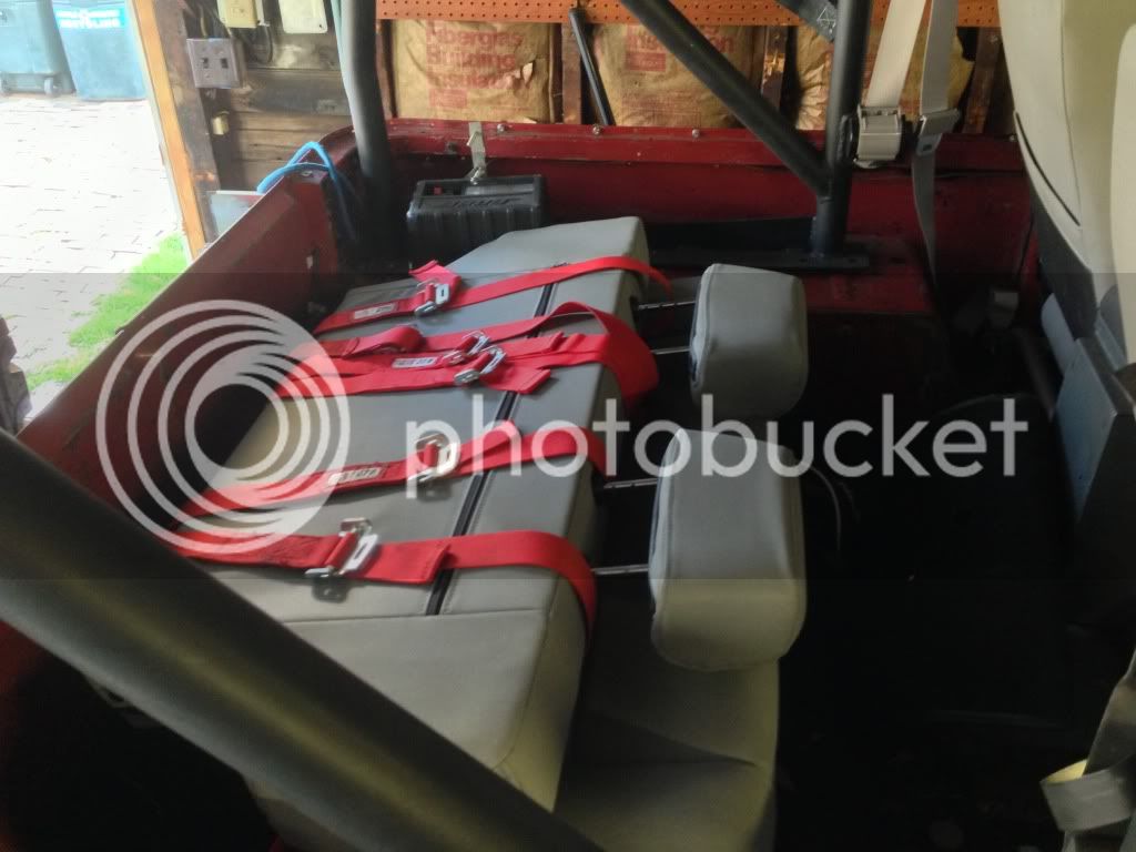

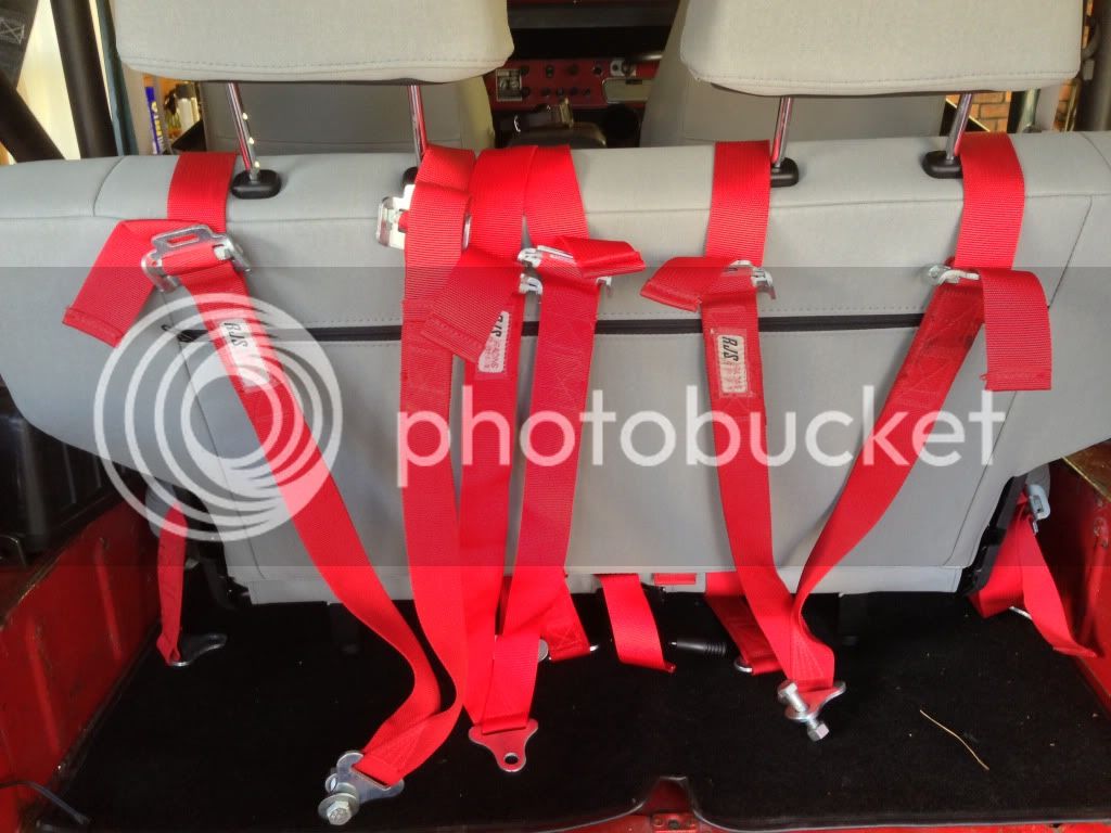

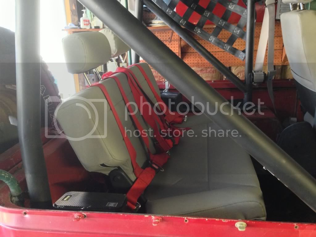

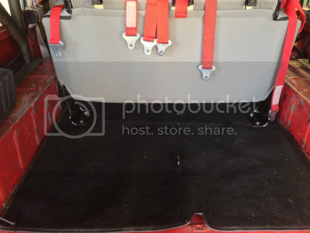

I also got my new Bestop Trailmax II rear seat installed. I still need to weld in a bracket for the harnesses.
WOW - that's a lot of seat belts :eek:
