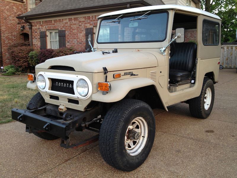

1971 fj40
I recently replaced my clutch slave and master, brake master and booster, got all my lights and signals back working, just got my new brake shoes and hardware kits in last week, now saving up for all eight wheel cylinders...My dad gave me this rig easter weekend...its been in the family for over 34 years and I have many memories growing up around this fj...cant wait to get it back in shape as it has been sitting for quite sometime..cant wait to share this rig with my two sons!!
