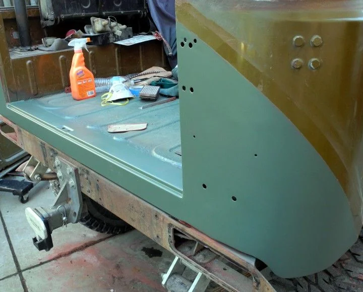

Pretty well done with this body work:
Before:
attachment.php
After:
attachment.php
attachment.php
